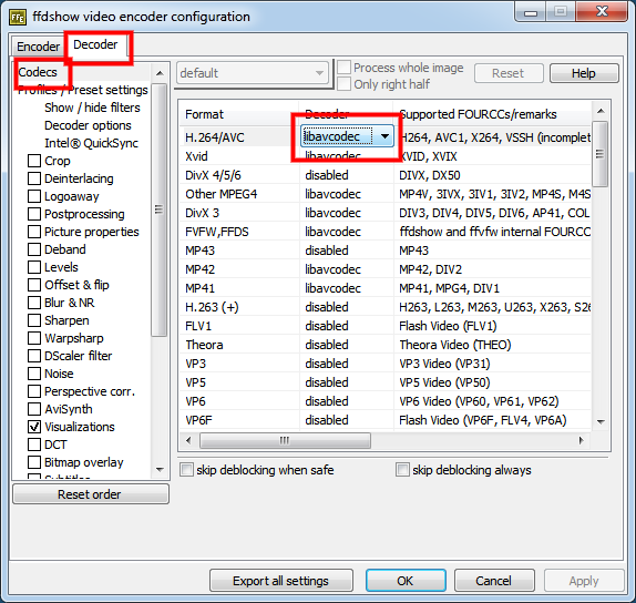

  8. Install ffdshow. Enable VFW h.264 decoder. Start -> All Programs -> ffdshow -> VFW Configuration -> Decoder (tab) -> Codecs (left pane) -> h.264/AVC -> libavcodec.
  9. Not seeing h.264/AVC -> libavcodec.
  10. Click in the Decoder column to see the pulldown list:
    [Attachment 50843 - Click to enlarge]
