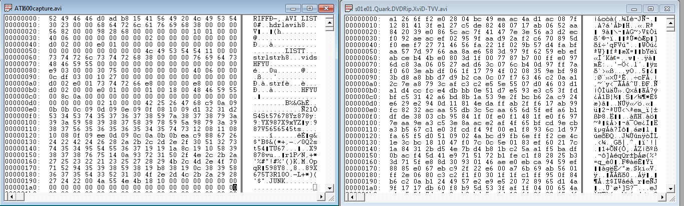

  9. The files contain markers (AVI audio and video chunk IDs) that indicate they were once AVI files but other standard AVI structures are missing. Most critically, there is no AVI Header at the start of the file. Here you can see the beginning of a normal AVI file on the left, one of your files on the right:
    [Attachment 50823 - Click to enlarge]
    The first four bytes of an AVI file are always "RIFF". You can see that and other plain text field identifiers of other structures in an AVI file on the left. On the right, your file, none of those structures are present. The structures contain information about the width and height of the video, the frame rate, the codecs used, etc. Without those players will not play the file properly.
    My guess is the file system was screwed up (very common on USB drives, especially if you don't properly dismount them before unplugging them). I recommend you compare the same file in your backup. If they are identical it means the files were corrupt before you backed them up.
