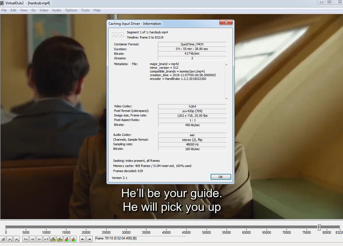

  6. I took a random 1280x720 video and cropped it down to 1202x718 in Handbrake 1.2.2. That particular subtitle rendered correctly. I didn't look at every one but I didn't see any errors in a quick scan.
    [Attachment 50809 - Click to enlarge]

  8. I started with a 1280x720 25 fps MKV file. The source file shouldn't make any difference. Neither should the container of the otuput file (mp4 in my test). I thought that the mod 2 frames sizes might confuse the subtitle renderer -- but that wasn't a problem here (many programs have trouble with mod 2 frame dimensions). Still, I recommend you try a mod 4 or mod 8 frame size (Dimensions tab, Modulus) to be sure. Of course, I was judging your frame size from the JPEG image you posted -- maybe the image isn't the same dimensions as the video depending on how you made it. I don't know what else you might try.
