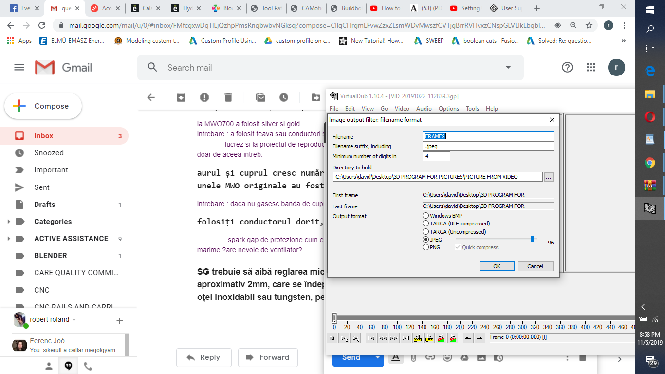

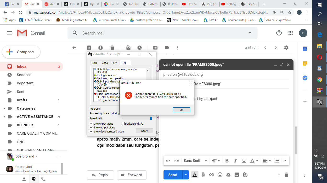

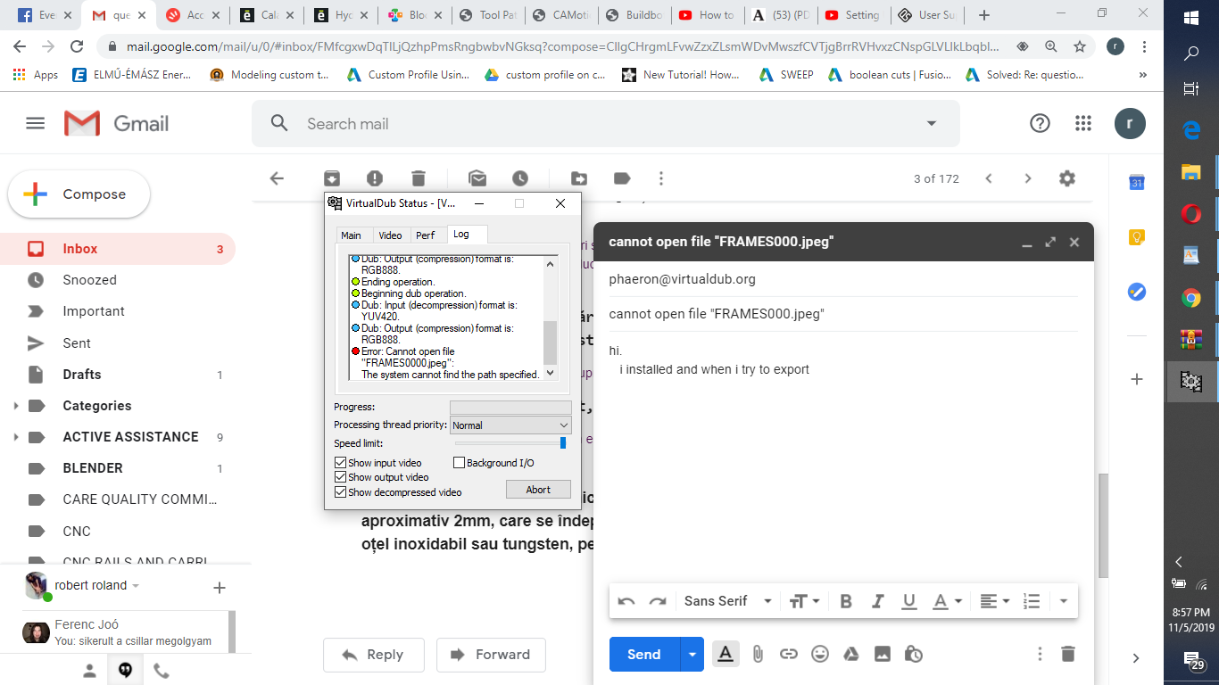

  1. hi. this is the error i get. what i do wrong and where? Image

  2. Why are the First Frame and Last Frame fields truncated? Try using a shorter path, one without spaces.
  3. i don't truncated them at all. i don't know if in that field i must to write the FRAME0000 orthe program itself, because i can't to write there if i want, is not allowing me. this is my problem and i don't know what to do.

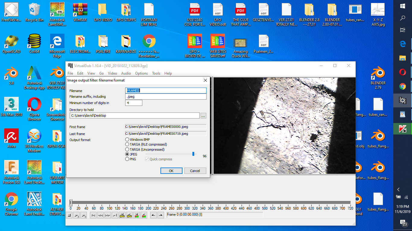

  4. i shortened Image
    [Attachment 50792 - Click to enlarge]
    and now is just 1 frame from entire video of 5.08 mb . Image

  5. So it's working now?
  6. is doing just 1 frame . i undestand from here https://www.raymond.cc/blog/extract-video-frames-to-images-using-vlc-media-player/ that is doing from entire video pictures,or is not like this? or i must to do in settings somewhere something? do you know other such a program to give a try?
  7. VirtualDub should produce a sequence of files. How many you get depends on the length of the video, the frame rate, any decimation you specify, and whether you used the mark-in and mark-out tools to limit the range.
  8. to me is not doing. i setting what in that web page is said to do decimation 300,60000fps. any tutorial for more settings?

  11. Originally Posted by roland78 View Post
    I'm not exactly sure what your saying here. But your entire clip is only 527 frames long. If you decimate the entire thing by 300 you'll be left with two frames. So you are probably just decimating by too much.
  12. yes i have it just 2 frames with 300 decimation. thanks for advice. how many decimation to be? 10,30 or 100? you have right i have it before 2 frames. with the virtualdub 2 is doing nothing. i must to reload the first virtualdub version.
    i decimated with 3 and is working.
  13. Decimate to get the number of frames you want, over the section of the video you want.
  14. is working. thanks for help.
