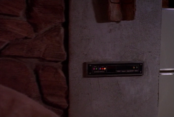

Here's an example of the residual combing
[Attachment 50755 - Click to enlarge]
This is close to what I'm actually doing. I'm running TFM(pp=0) and then running a script that outputs a log indicating the result of IsCombedIVTC for each frame. I'm using this log to build an AviSynth script that runs QTGMC(FPSDivisor=2) on said frames. While this is fine I always have to fine tune the detection threshold which is a bit of a chore (the picture I'm posting is not detected with cthresh of 10, the default) and whatever I settle for, there may still be some leftover.You can try adjusting the TFM settings for comb detection and PP , such as thresholds for combing, metric used for comb detection . Clip2 can specified as the PP (e.g. a QTGMCed clip , or some other processed clip, to take frames from)
