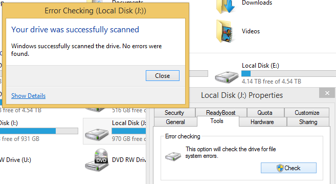

  19. aBigMeanie aedipuss's Avatar
    Oct 2005
    666th portal
    i took the drive out and scanned it on another computer for errors. guess what? none were found.
    [Attachment 50819 - Click to enlarge]

  21. I managed to fix my issue by restoring the Registry files from an automatic backup found in "Windows\System32\config\RegBak" (as per the advice provided in the SevenForums thread linked in the first post), and restoring each file found in the "LastGood" directory, replacing their updated counterparts in "System32" and "SysWOW64", so as to minimize inconsistencies. Then it could boot from the NVME SSD. I also tried what was my first idea : clone the NVME SSD to the SATA SSD, then attempt to boot from the SATA SSD and fix the driver issue from there before cloning back to the NVME SSD, but it didn't work — the system was expecting the NVME SSD at startup to complete the update process (according to the dude who answered on SevenForums, this is due to some parameters in the BCD file so it may have worked after editing it).
    Have you scanned the drive for physical defects ? CHKDSK and the "Error Checking" module which relies on CHKDSK under-the-hood only deal with logical errors. And of course the system partition can't be properly checked that way, as many files are in use during the regular system operation, but it should propose to scan it at the next startup (that's how it behaved up until Windows 7, I don't know about newer systems).
