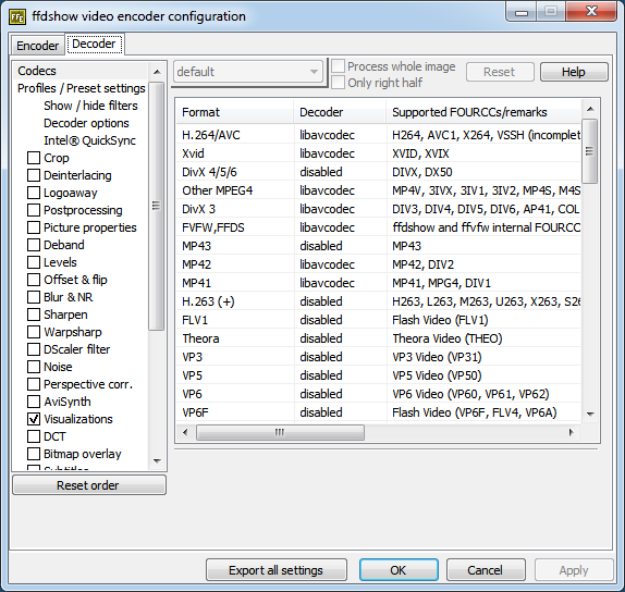

First go to Start -> All Programs -> ffdshow -> VFW Configuration. Go to the Decoder tab and make sure the codecs you need are enabled:
[Attachment 50682 - Click to enlarge]
But you still need to have an MP4 reader/splitter. Haali should have installed one (maybe you didn't select it when you installed Haali?). If not, the older LAV Filters (with XP support) should install one. -
