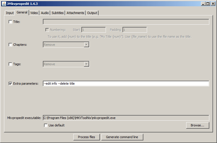

  7. In JMkvpropedit's "General" tab you can select the mkvpropedit.exe location at the bottom. To remove the Title element enter "--edit info --delete title" in the "Extra parameters" field. In the "Output" tab there is a log - post it here if it still does not work like expected.

  8. I mean the file names. I was very tired when typing that and couldn't think.
    I have done this but nothing happens to the file & nothing shows up in the Output Tab?
  9. Is MKVToolNix properly installed? What version? What OS are you using? Is there no error message if you click "Process files"?
  10. Yes, it is properly installed & I have the current 64bit Windows 10 as well as 64bit Java.
  11. Is there no error message then you click "Process files"?
  12. There was no error messages. However, I just deleted the software then reinstalled it in the same place & it now works! Don't know what happened before?
