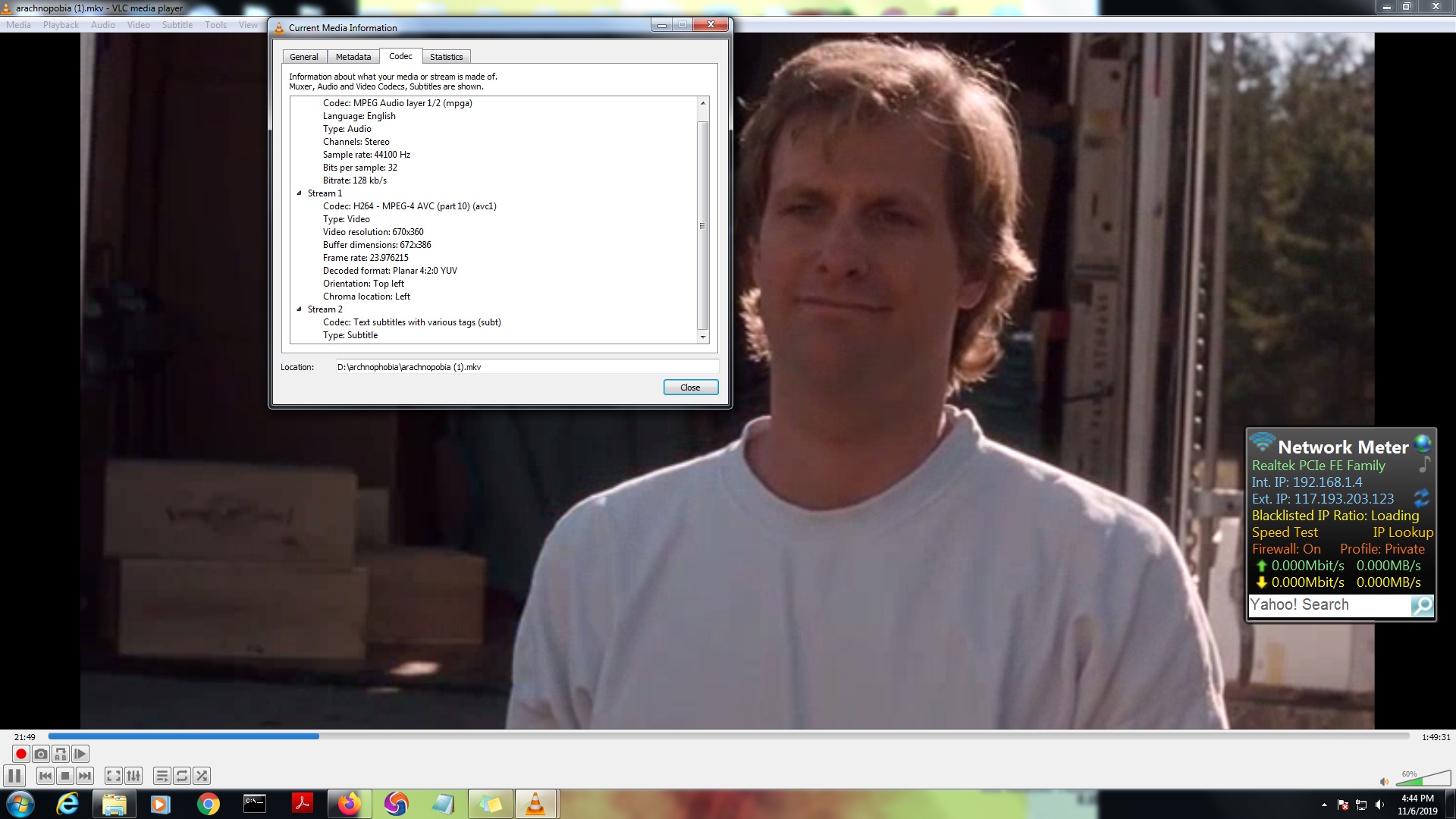

    i enclose the file by mkv tool nix, a snapshot showing subtiles , and codec information
Name:	codec information.jpg
  21. That media information image shows that Handbrake muxed the subtitles into the mkv file as a text stream -- it is not hard coded. If it was hard coded it would become part of the picture and would always show up. Just like the guys face is part of the picture and can't be turned off or on. Use the "Burn In" option for the subs in Handbrake.

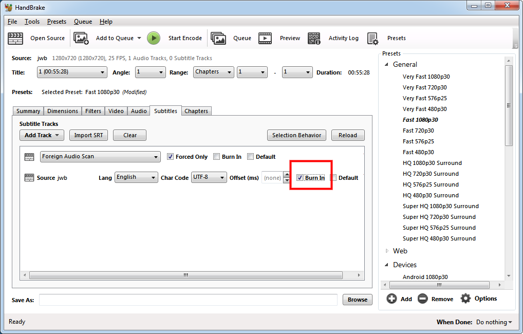

    i open the video file , then mark the destination, then click subtitle, here the confusion.
    should i select import srt or add tracks.
    i selected import srt, then browse to the srt file to add, and then tick on burn in option and then start.
    Is there any miss on my part in hardcoding the subtitle.
    there is no preview , so i could not see what is happening.
    even after trying, if i play, then there is no subtitle at all in the movie
    where i miss.
    Is this free , or should i get license to get the subtitle
  24. Use "Import SRT" on the Subtitles tab. Select "burn-in" on the SRT line:
    [Attachment 50810 - Click to enlarge]
    Sometimes there's another line (as pictured). That one doesn't matter.
