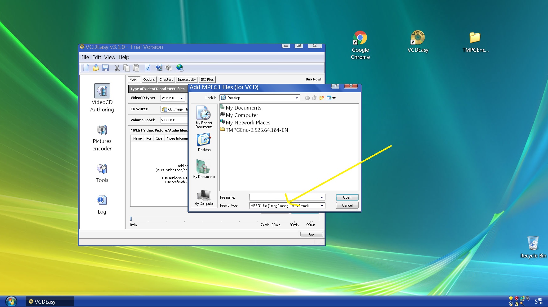

    Ok. I made the Virtual Machine with WinXP and put VCDEasy and TMPGEnc on it. VCDEasy started right up with no problems but I have a question. It looks like VCDEasy only takes mpeg-1 and mpeg-2 video files. Is there any way to get it to load up a .mkv?
    [Attachment 50618 - Click to enlarge]
    Mar 2008
    Doesn't VCDEasy only take compliant files?
    Why don't you encode your file in TmpgEnc using the VCD template then feed the new file to VCDEasy
    You're right. I just figured it out. Thanks.
