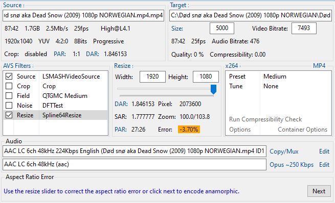

  3. Thanks for the reply, I will go first for second and Resize error pic attached for further guidance. Actual video resolution is 1920x1040 and I m converting to 1920x1080 as pic attached check the yellow in resize section and advise.

    Aug 2008

    Your sourse 1920 by 1040 and your output is 1920 by 1080. I would be guessing put they should be the same.
  5. Actually, I want to remove the errors highlighted in Yellow at 1920x1080 with exact aspect ratio.
  6. You can't resize from 1920x1040 to 1920x1080 without distorting the image. If you need a 1080 pixel high frame add borders rather than resizing.

    If you changed the output to 1920 by 1040 that highlighted error would go to zero.
  8. That is the problem, I want to resize the video 1920x1080 with actual aspect ratio and guide how to get rid of this errors.

    Then do not resize, but add borders.

    Hmm, well ... that's a filter StaxRip does not provide out-of-the-box. You would have to either add AddBorders (a kind of "opposite to Crop") to the list of provided filters, or edit the script manually. At least it is possible to do either, starting with a right-click into the "AVS Filters" box (middle left side).
