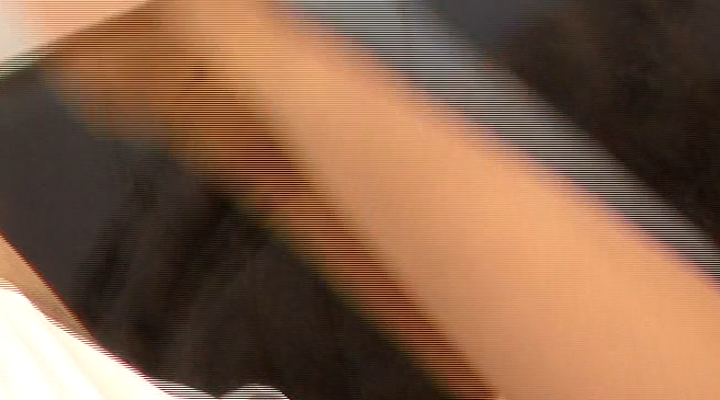

I have a BFF 1080i source running at 29.97 fps that exhibits an obvious standard telecine pattern of 3:2 (see source)
[Attachment 50564 - Click to enlarge]

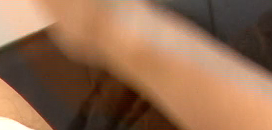

However, when running TIVTC using the following script: DGSource("VOB\V02.dgi") AssumeBFF() TFM(slow=2, pp=0) TDecimate() I am left with a video that still displays extreme combing and some sort of blending, on a 3:1 pattern.
[Attachment 50566 - Click to enlarge]
What could be wrong here? I must point out that the m2ts only has one specific scene that is telecine, I'm wondering if the process is failing because the pattern starts on an odd frame or something, but I'm not sure what to do about it. (Also, I'm sorry, but the source being what it is, I cannot upload a safe sample)

Step through it viewing the fields after SeparateFields(). You'll see that your fields are corrupted with what looks like chroma ghosting.
Yes, the chroma was screwed up before you got it. I came up with this as a possible fix:
After TFM and TDecimate every 4th frame has the messed up chroma. The code replaces the chroma of those frames with chroma from a motion interpolated frame. There's probably a better way but that was my first idea.Code:########################################################################## # # Every frame is replaced by a motion interpolated frame from the frame # before and the frame after. # ########################################################################## function InterpolateAll(clip c) { e = SelectEven(c).DoubleFPS2().SelectOdd() o = SelectOdd(c).DoubleFPS2().SelectOdd() Interleave(e,o) Loop(2,0,0) } ########################################################################## LWLibavVideoSource("D:\Downloads\sample2.m2ts") TFM() TDecimate(chroma=false) interp = MergeChroma(last, InterpolateAll()) ConditionalFilter(last, last, interp, "current_frame%4", ">", "0") -

Yes, the code worked ok for this clip but I expected it to mess up when motions got to large. I have a better idea (one that avoids motion interpolation) but not working code yet...
Ok, got it:
This will fail past any break in the telecine pattern (so will the previous code). If you have breaks you'll need to work in sections.Code:LWLibavVideoSource("D:\Downloads\sample2.m2ts") SeparateFields() PrevChroma = MergeChroma(last, last.loop(2,0,0)) # replace chroma of each field with the chroma of the field before it Interleave(last, PrevChroma) # interleave the two streams so we can easily pick the fields we want SelectEvery(20, 1,2,5,6,8,10,12,14,16,18) # pick the good ones Weave() TFM() TDecimate() -
OK, yeah this produces better results, but I'm afraid I don't understand enough of it to apply the process to different sections properly. The telecine pattern does break in between sections, so I would need to offset it. I suppose it's only about changing the selection pattern in SelectEvery but watching field by field I am unsure how you came to the current pattern. I'm using only this portion
But I'm not sure which fields should be selected just by watching. The pattern I'm seeing is 1,2,3, 5,6, 8,9,10, 12,13,14,15,16,17,18,19,20; after that I don't know which of the duplicates should also be removed, how do you decide? And once I have this, how can I apply it to different Trims?Code:SeparateFields() PrevChroma=MergeChroma(last, last.loop(2,0,0)) Interleave(last, PrevChroma)
Alright, for anyone wondering, I ended up splitting the video by finding where the pattern was resetting and IVTC those segments individually. After that I was left with some combing during the fade transitions so I used QTGMC on those segments. Result is quite good, thank you again jagabo for your precious help!
Code:DGSource("VOB\V02.dgi") SeparateFields() PrevChroma=MergeChroma(last, last.loop(2,0,0)) Interleave(last, PrevChroma) P1=Trim(0,8431).SelectEvery(20, 1,2, 5,6,8,10,12,14, 16,18).Weave().TFM(pp=0).TDecimate() P2=Trim(8432,24423).SelectEvery(20, 1,2, 5,6,8,10,12,14, 16,18).Weave().TFM(pp=0).TDecimate() P3=Trim(24424,136751).SelectEvery(20, 1,2, 5,6,8,10,12,14, 16,18).Weave().TFM(pp=0).TDecimate() P4=Trim(136752,183303).SelectEvery(20, 1,2, 5,6,8,10,12,14, 16,18).Weave().TFM(pp=0).TDecimate() P5=Trim(183304,0).SelectEvery(20, 1,2, 5,6,8,10,12,14, 16,18).Weave().TFM(pp=0).TDecimate() P1++P2++P3++P4++P5 PA=Trim(0,1677) PB=Trim(1678,1691).QTGMC(preset="Slower", FPSDivisor=2) PC=Trim(1691,4878) PD=Trim(4879,4893).QTGMC(preset="Slower", FPSDivisor=2) PE=Trim(4894,27336) PF=Trim(27337,27354).QTGMC(preset="Slower", FPSDivisor=2) PG=Trim(27355,36652) PH=Trim(36653,36666).QTGMC(preset="Slower", FPSDivisor=2) PI=Trim(36667,0) PA++PB++PC++PD++PE++PF++PG++PH++PI -
For others who might be reading, this "fix" is copying the good chroma of a top field to a bottom field with messed up chroma (or vice versa). It works here because the two fields are from the same film frame. The chroma is slightly displaced vertically (not temporally) but that's better than the blended chroma of the source.
