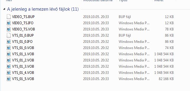

    The video-ts folder
    in details view

    This is the DVD video folder:
    [Attachment 50549 - Click to enlarge]

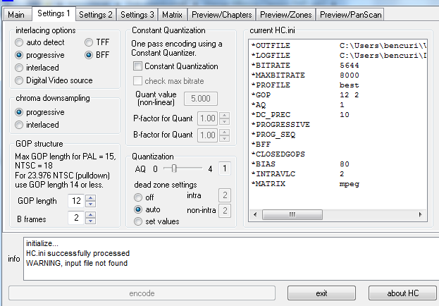

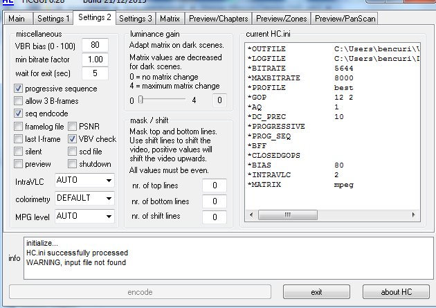

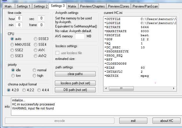

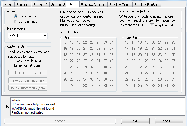

    Today I ran a test using unmuxed files to compile the DVD from, so the original m2v that came from the mpeg encoder (HCEnc) and the wav from Vegas. The same result, that is: the bitrates in the vobs are unreally high. So in case this playback problem originates from the project source files (and not from a player problem), it can only be the encoder, that made an error. However, I remember that many years ago I used HCEnc to encode mpegs for a DVD project, and that DVD played fine on this same Sony player. Considering this, in case the m2v files are indeed incorrect in the recent case, it should be my recent settings that may cause the problem. I just want to sort out this possibility. These are my recent settings for this project, do you think there is anything that may be problematic for the player?

    It's quite difficult to track down potential issues. But one such issue in your first screen-cap is that you do not appear to be making dvd-compliant assets. Import these at an actual authoring stage and re-encoding will take place. And I really do not understand a 12 2 GOP.
    Like I already stated, and since this source, at 1080 I/P, is not dvd-compliant, is to upload two such original HD samples and, but may not be required, an into, especially if it is not authored from these HD sources, and one can then take a closer look.
    Yet avstodvd, in my experience of the s/w, can take a non-compliant HD source and still author compliant dvd assets beit mpeg2, folders or whatever.

    The mpeg that the encoder creates is 720x576, not 1080p, and the gop is m=3 i=12 (2B frames as the setting says and 12 length). This is the same in case of my friend's DVD as well, that played without issues. HCEnc reports automatically in case the result will not be DVD compliant, in my case it found everything okay. Also DVD lab pro reports incompatibility, it found no problem.
    If this gop is not compliant, what could be compliant?

    But I think this is irrevelant now, because I doubt my mpeg are non-DVD compliant. HCEnc would warn, and the GOP structure I set was defined as compliant in various descriptions. In TMPGEnc, M3 N12 is a Standard PAL DVD GOP structure.

    My issue was that I was seeing 2 12 in the images you posted above. Which is not what you initial image shows so those settings may not be what you actually used.
    Of course your final product is a compliant dvd else it would not play as such. The issue is, and always was, why it would not play as expected.

    HCEnc doesn't ask for the usual format to be added, it asks for the number of B frames you want and the length of GOP, that's why the 2 12 value. That will result in M=3 N=12. I think this confused you.

    Originally Posted by Bencuri View Post
    I found finally what's the problem with Mediainfo:
    When you create the DVD with a structure like:
    - multiple Titles in 1 VTS, Mediainfo reads the VOB's bitrate incorrectly.
    - 1 Tilte (it can contain multiple chapters) in 1 VTS, Mediainfo will read the VOB bitrate correctly
    Methinks you have nailed this one. Although I created this multi-title dvd many moons ago the folders are still on one of my HDDs and, yes, mediainfo really does misquote the detail.

    I also wonder whether the Matrix that is the default in HCEnc is suitable for DVD? Do you think it can cause problems?

    One way you can test HCEnc is to create the dvd solely within avstodvd but select HCenc as your encoder - it is, AFAIK, no longer the default one. I forget whether you can make any alterations to the settings of HCenc within avstodvd but then if it is not broken why try to fix it.
    The dvd I referred to above was created by mpegs encoded in my video editor but the actual authoring was then with DVD lab Pro.
    The only way a player could baulk with a dvd it can read is if the bit rate is too high. But dvd bitrates can go beyond 8000 - I tend to settle at 6000. And if it was too high the authoring program would tell you it was not compliant and re-encode regardless.

    I have checked the settings AVStoDVD uses on mpeg creation, there are a few things where it differs from my settings, like: it uses adaptive matrix, lumagain (though I think this is not an important difference), and uses autogop and open gops. Open gops are out of question for me as I need to add chapter indexes on the authoring, so, it has to cle closed.
    Apart from the adaptive Matrix, it seems to me there is no significant difference. What I don't know is that whether the choice of Matrix affects later playability. I know that is does define quality and details, but I am not sure if it has to do anything with file playability.
  30. Member
    Mar 2008
    You can undo adaptive matrix by deselecting Lumgain in the HCenc advanced settings.
    Also, you can activate closed GOP by selecting "edit encoder command parameters at runtime" in AVStoDVD and
    adding this to the input command file:
