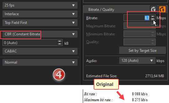

    As said, I am not an expert. So, this bitrate stuff, I am sorry ... but need a bit of advice on that.
    In the screenshot above the bitrate in the output was: "Variable"
    Whereas I see that the bitrate in the source was maximum 8,275kb/s.
    I want the quality to be the same as the original, that is most important for me. The filesize, after cutting out commercials, should not be bigger.
    If it is the same file size, then it would be okay, but slightly smaller would be nice.
    Question: what would be the recommended bitrate-settings then?
    Constant?
    and set the 'Maximum' to be the same as the max. in the original?
    See attachments for options #1 #2 #3 and maybe I should use settings in #4

    original file 4.7GB 70 minutes
    removed commercials, left 45 minutes (35% removed)
    the default result, in this example..., would be 3.3GB, which would be fine with me.
    However, as said, in other cases, the result might as well be as big as 2x the original.

    You should us Average Bitrate. Under Multipass Settings you should set Pass Count to 2. Under Bitrate/Quality you should set Bitrate to a value that will give the size you want. If you want the file size proportional to size of the original minus what you cut, use the same bitrate as the source.
