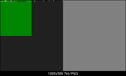

    I got a black and green screen like this, for the output of cutting a video
    Way 1. BoilsoftVideoSplitter/SMMVSplitter/mkvtoolnix(cut from key frames)
    Way 2.re-encode(tried HandBrake and mediecoder, for test so just use deafult setting and set a timeline)
    no matter which way
    If I do not cut/encode the origian video from the begining(0 second)
    the output will be like the image all through the video
    Maybe it is the problem of " this video is Hi444p + 10bit" ?

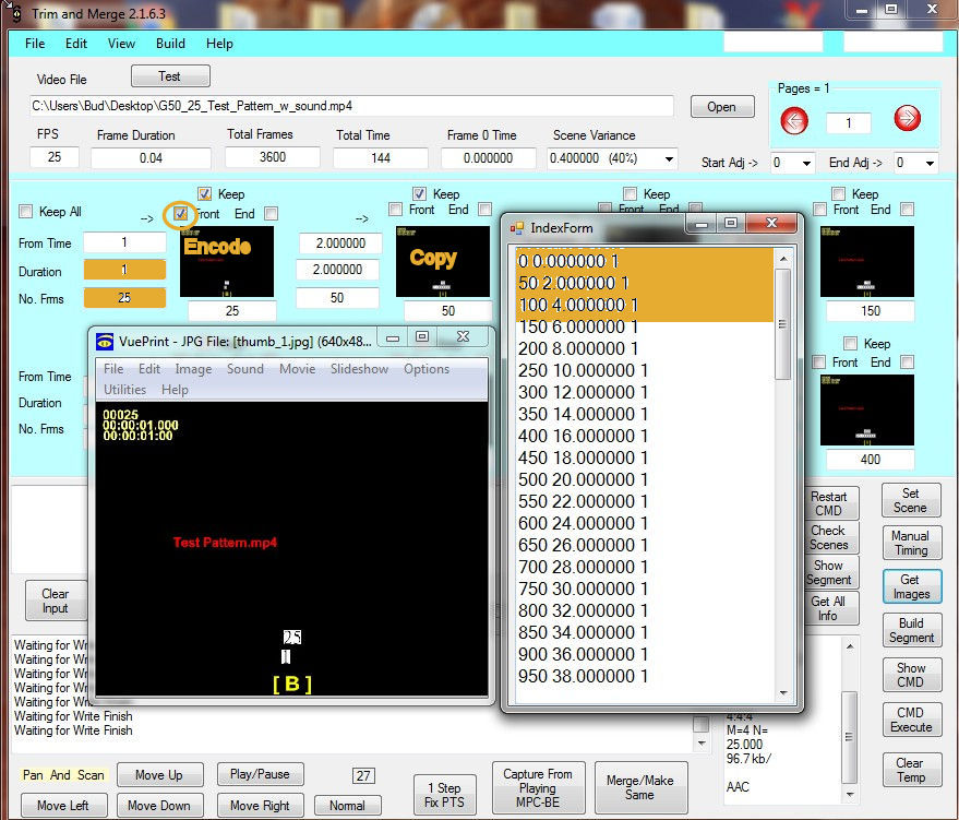

    If you are familiar with ffmpeg...
    The latest versions of FFMpeg recognize Key frames if you specify their location in -SS input search (they didn't before) and set the PTS/DTS to 0.000000. This allows you to encode only the portion before a key frame and merge it together with a copied segment. In the example form below, the keyframes are at 0,50,100,etc, I wanted to cut at a B frame half way between Key Frames (frame 25).
    [Attachment 50539 - Click to enlarge]
    To encode that segmnent you would use:
    ffmpeg -i "C:\PathToVideo\G50_25_Test_Pattern_w_sound.mp4" -ss 1 -t 1 -c:v libx264 -c:a copy -y "C:\OutputFolderPath\0_0_G50_25_Test_Pattern_w_sound.mp4"
    To COPY the following segment from the Key Frame at Frame 50, you would use:
    ffmpeg -ss 2.000000 -i "C:\PathToVideo\G50_25_Test_Pattern_w_sound.mp4" -t 2.000000 -c:v copy -c:a copy -y "C:\OutputFolderPath\0_1_G50_25_Test_Pattern_w_sound.mp4"
    Then Create a text file '"C:\PathToMyList\MyList.txt"' containing your outputted files:
    # This Is a Comment
    file 'C:\OutputFolderPath\0_0_G50_25_Test_Pattern_w_sou nd.mp4'
    file 'C:\OutputFolderPath\0_1_G50_25_Test_Pattern_w_sou nd.mp4'
    And finally merge with:
    ffmpeg -safe 0 -f concat -i "C:\PathToMyList\MyList.txt" -c copy "C:\Users\Bud\Desktop\merged_0_0_G50_25_Test_Pattern_w_sound.mp4"

    IS the Black and Green square only at the beginning of the video? Does it play the rest of the video? Are you attempting to cut between Key Frames?
  7. Originally Posted by Budman1 View Post
    It is all through the output video when I cut/encode the origian one not from the begining
