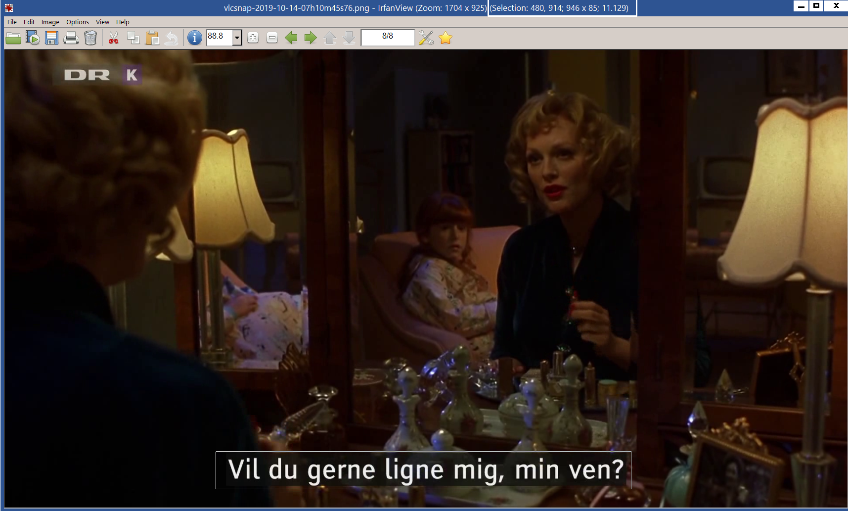

  12. Below is a screenshot where some hardcoded subtitles are marked in IrfanView.
    [Attachment 50526 - Click to enlarge]
    In the top you'll see the coordinate of the left upper corner of the rectangle as is used in ffmpeg delogo. Also the width and heigth of the rectangle is shown as used in ffmpeg delogo. So using the command
    ffmpeg -i Hcclip-1.avi -vf "delogo=x=480:y=914:w=946:h=86" -an delogo.mkv

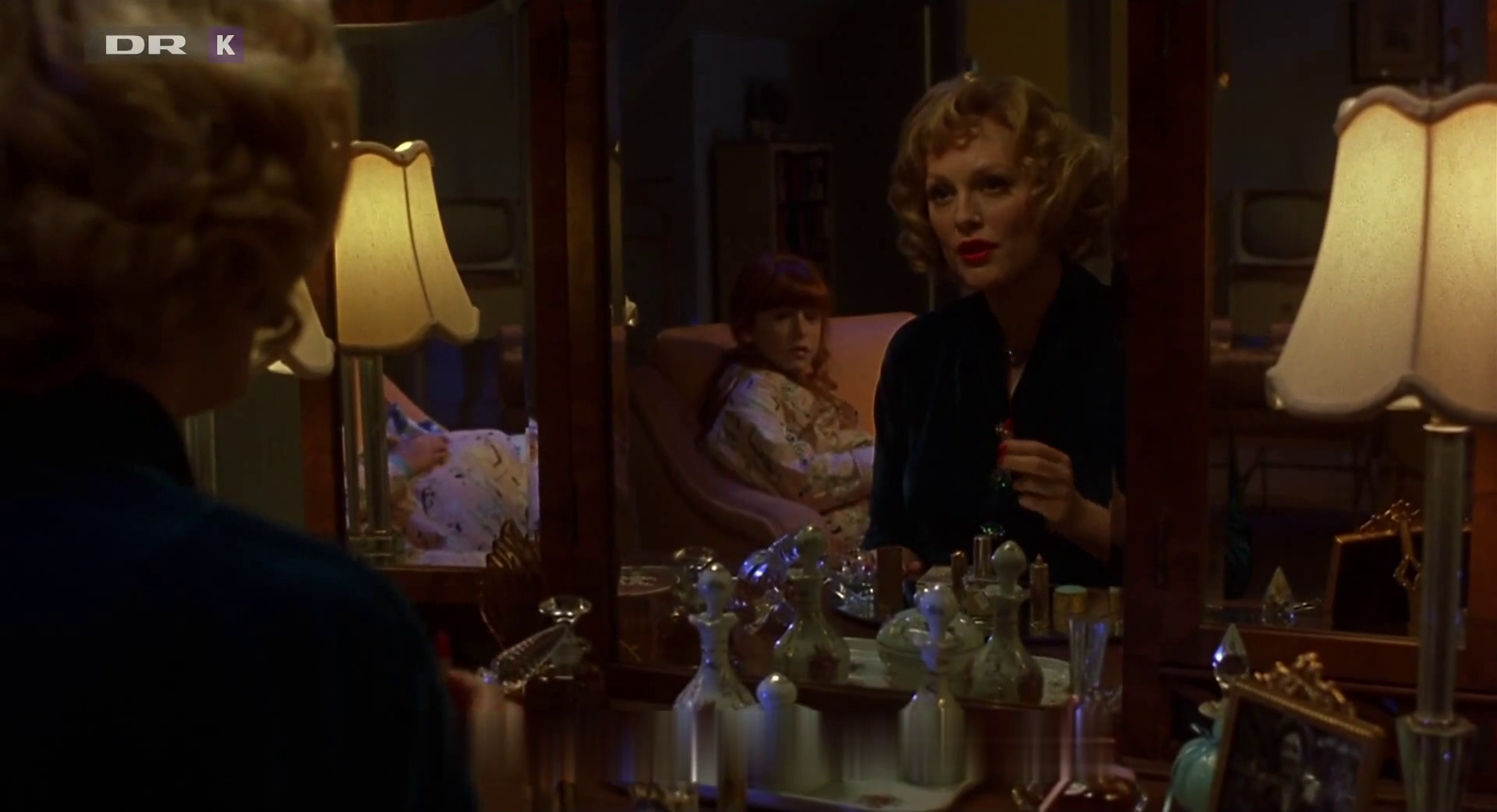

    you get this image
    [Attachment 50527 - Click to enlarge]

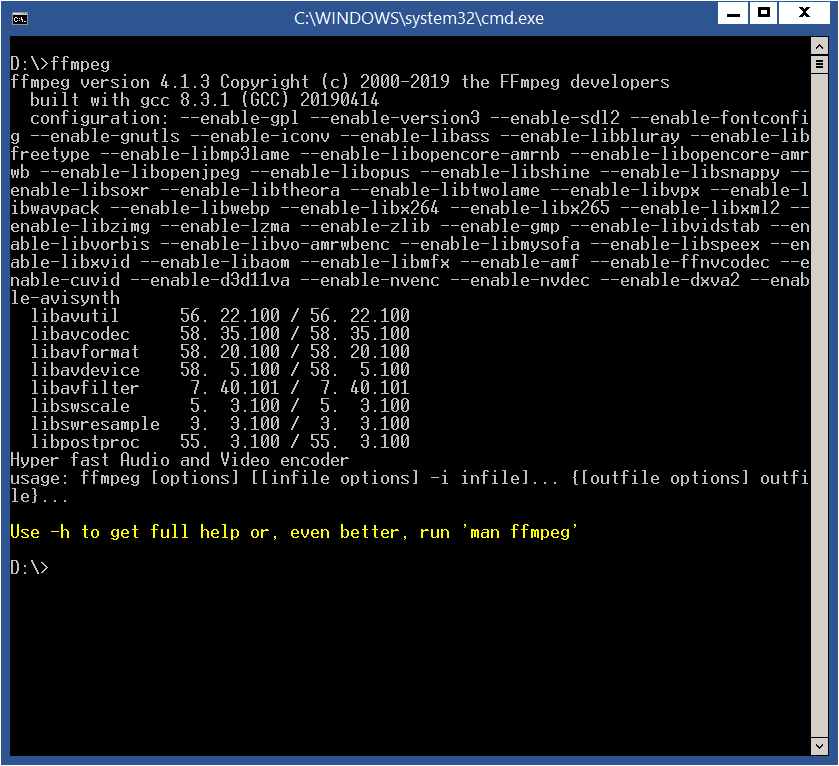

  16. No.
    Change
    c:\program files\ffmpeg\bin\ffmpeg.exe
    to
    Test it by opening a command prompt somewhere and type ffmpeg.
    You should get this
    [Attachment 50543 - Click to enlarge]

    Use
    ffmpeg -i Hcclip-1.avi -vf "delogo=x=480:y=914:w=946:h=86" -c:a copy delogo.mkv
    to have the audio
