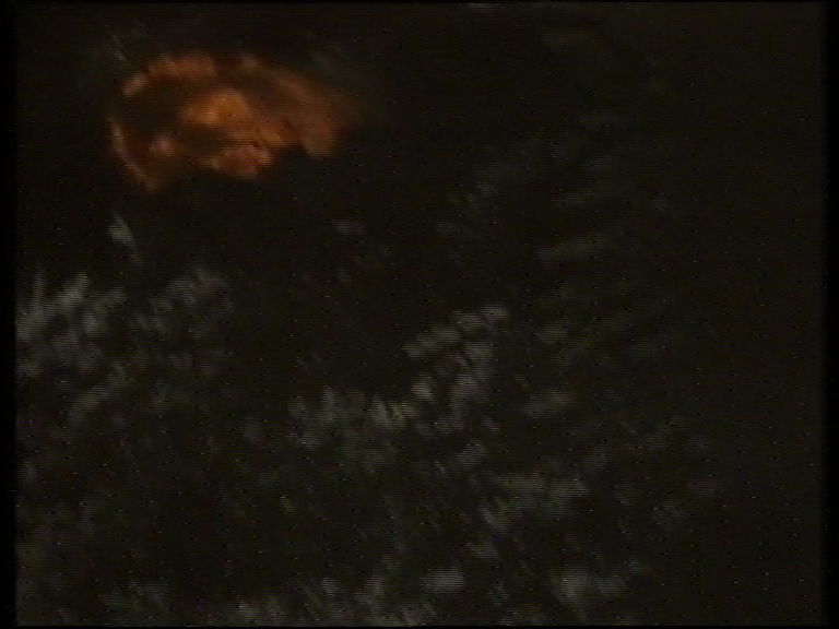

  1. So I've been trying to transfer some tapes using a Sanyo VHS/DVD combo unit and I'm getting this funny vertical banding pattern on screen and on the recording.
    What is it and any ideas how I can remove it? 20191012_233931.mp4

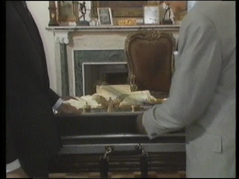

  5. Originally Posted by KarMa View Post
    It was probably recorded on the tape that way (interference) or you currently have an active interference source. If professionally recorded commercial tapes (Hollywood for example) don't have the same noise then it's probably not an active source and simply was recorded on the tape like that. In which case I have no idea how to remove it.
    It's on commercially removed tapes as well. I'm guessing there's some intereference somewhere. I don't know where to start looking through. I'll disconnect everything and start again from scratch and see what happens.
    [Attachment 50507 - Click to enlarge]
    [Attachment 50508 - Click to enlarge]

  11. This is not present on another VCR unit, so it must be interference from the Sanyo unit.
    I do have a tape cleaner that I will try and see if this makes any difference to things.
