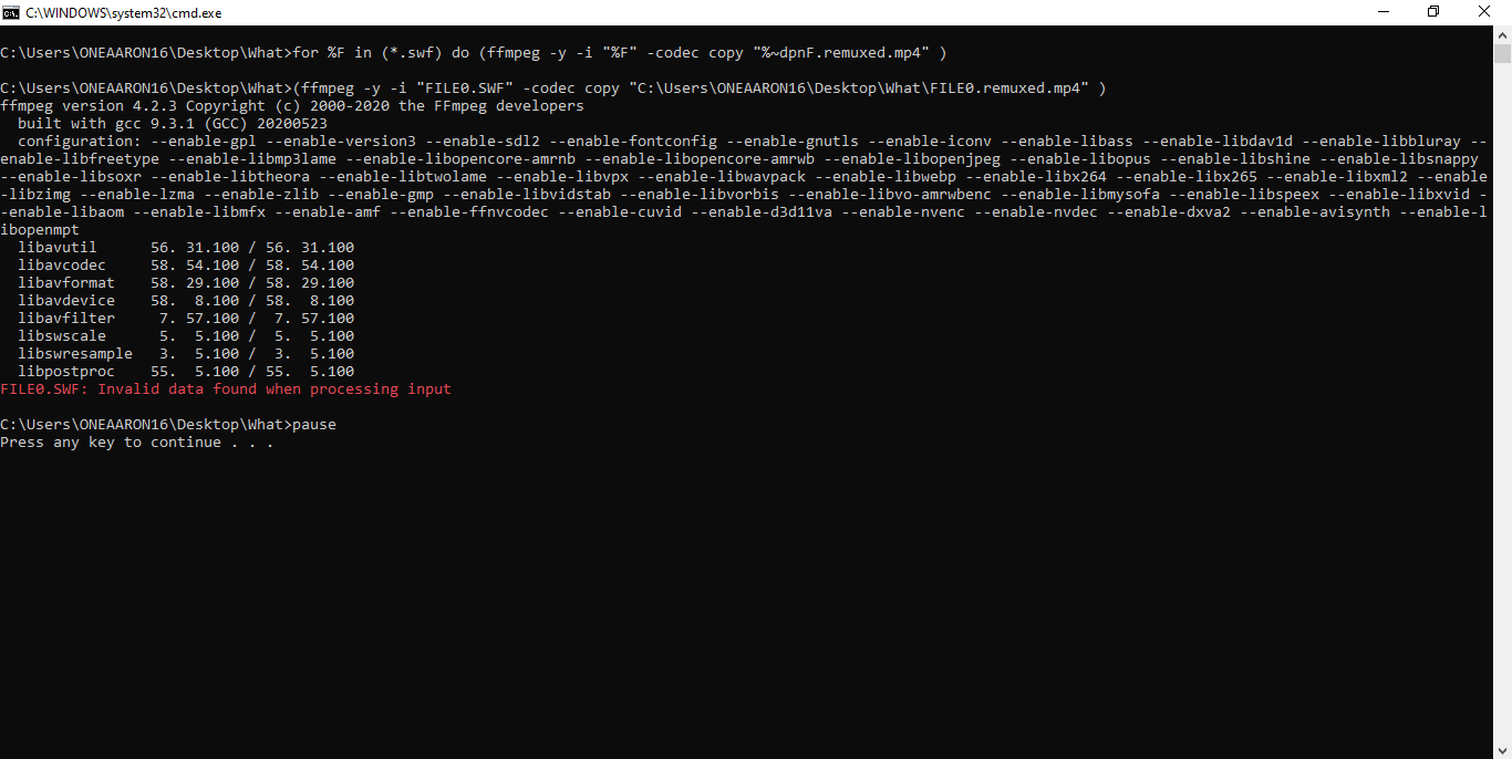

    H have the same situation as mikehende here. I recovered a formatted hard drive to watch recorded videos by security cam. files format are ".swf" . when I try to use ffmpeg, I see this error:
    [Attachment 53794 - Click to enlarge]
    Drive recovery programs aren't very good. That file is probably corrupt. Does MediaInfo show anything about that file? Are all the files showing the same thing? The longer the file the less likely it is to be recovered properly. Do you have any very short SWF videos that are viewable?

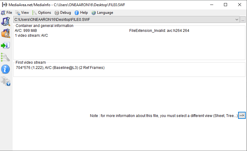

  3. Image
    [Attachment 53796 - Click to enlarge]
    [Attachment 53795 - Click to enlarge]
    That's the info of file.
  4. That appears to be h.264 elementary streams, not an SWF file. Rename it with an .h264 extension and see if you can do anything with it.
  5. Originally Posted by jagabo View Post
    simply change the .swf to .h264 or using ffmpeg?
  6. Just change the extension in Explorer. Some media players won't play .h264 files. Try VLC -- I know it will play them.
