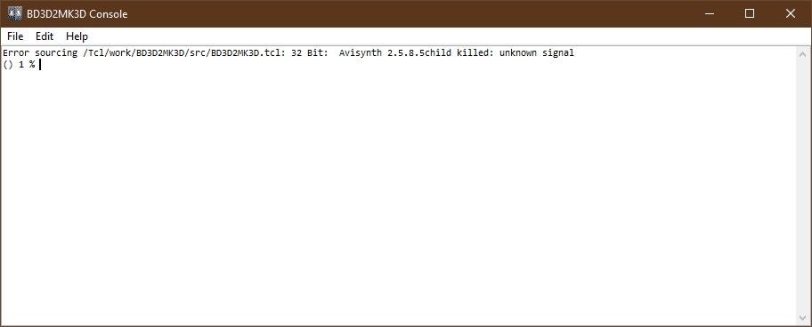

    With the last version of BD3D2MK3D v1.15 (October 6, 2019) download from VideoHep, I have the follow problem > Error Sourcing.
    I don’t understand why?

  2. I'm the author of BD3D2MK3D. Sorry for the late reply. I don't visit this forum often.
    It seems that BD3D2MK3D has some trouble when it tries to retrieve the type and version of the Avisynth distribution you have installed. I will try to fix that problem so that it will not crash any more at startup, but anyway, that problem indicates that Avisynth is not properly installed on your system. Since the last versions, BD3D2MK3D can use several versions of Avisynth, but it needs to know what version you have. For that reason, it uses an external tool, AVSVersion32.exe and AVSVersion64.exe (in the toolset folder) to detect the versions you have installed. Obviously, one of these tools crashes during the test, and BD3D2MK3D cannot continue.
    I suggest to re-install properly the versions of Avisynth you are currently using, and, if you have not installed it yet, to install Avisynth+ 64-bit. That should solve the problem.
    In the meantime, I will modify my code so that the next version will not crash anymore when it encounters that problem, and will display a meaningful error message instead.
    Good luck !

  3. I have just released v1.16, that should fix the problem you have encountered.
    If you have not yet re-installed Avisynth, please try the new version immediately, and let me know if BD3D2MK3D starts now correctly. You should see the console, with a red error message, but the main GUI should be opened correctly.
