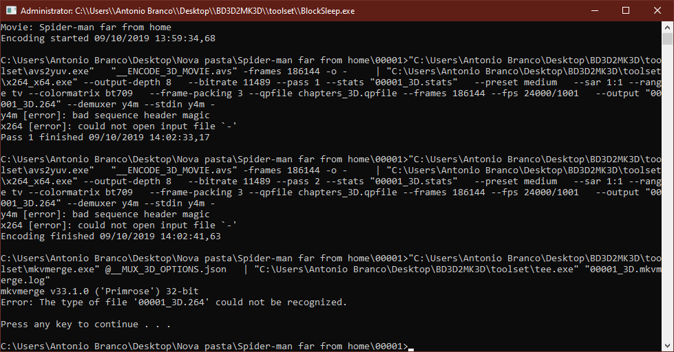

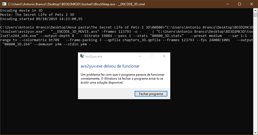

    With BD3D2MK3D v1.9 I never have problems but with the movies, Spider Man Far from Home 2019 and The Secret Life of Pets 2 2019, I have the follow problem > avs2yuv.exe stop working.
    I don’t understand why?
Name:	avs2yuv.exe stop working.bmp
Name:	avs2yuv.exe stop working1.bmp

    Thank you for the help but disabling hardware acceleration don't work, I have the same error !!
    I think it is directly associated to the last windows 10 updates, which seems are not stable, because, recently, I used BD3D2MK3D on another movie without any problem and today, I tried again with this same movie, just to rule out possibilities, and I have also the same error.
