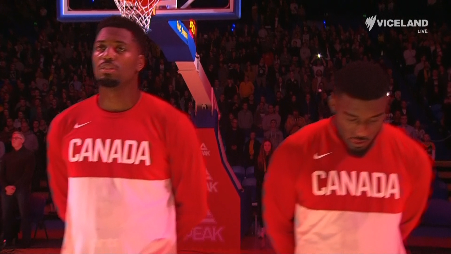

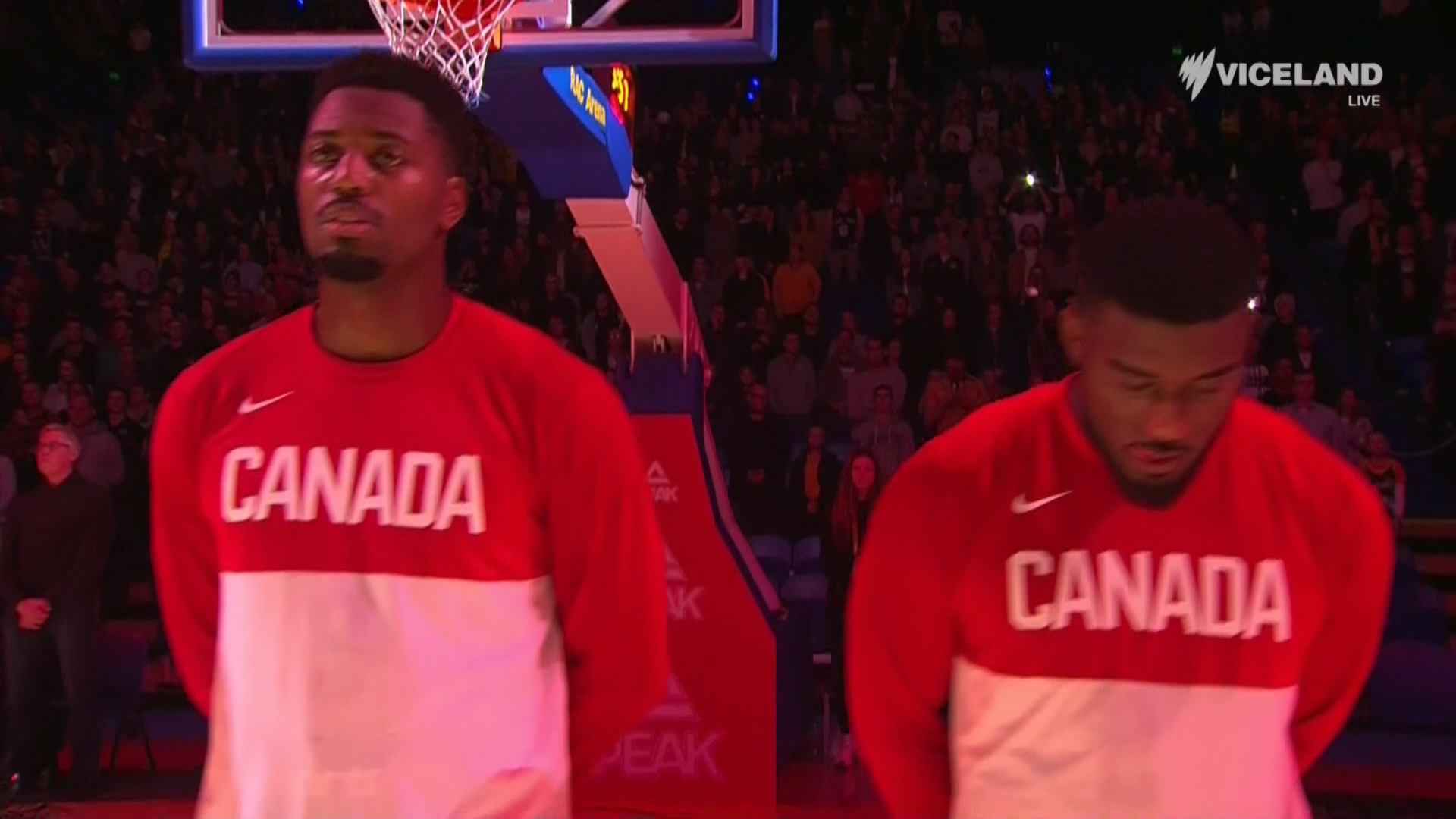

  8. Well this is interesting. I have no idea which is correct.
    Original TS file:
    Lossless AVI file:
  9. The video is flagged as BT.709. The first image (TS.jpg) is correct. The second image (AVI.jpg) is using a BT.601 matrix instead. Tell your editor the video is BT.709 (aka rec.709). Note that AVI doesn't flag the matrix. Your editor is just guessing and getting it wrong.
