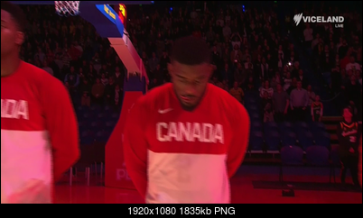

  13. The Y is interlaced 50 fields/s ;
    But the U,V looks like 25 fields/s (I.e it's progressive chroma content , but also with some combing). Basically you're missing 1/2 the temporal color information
    You might be able to interpolate / reconstruct those missing chroma fields

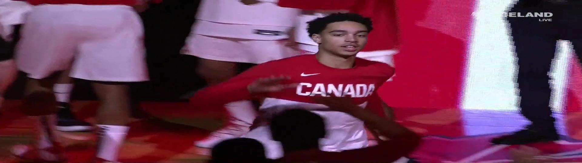

  16. Right, but why do the players' legs look fine but their shoulders are combed, for example? Is there a way I could look at some frames from later on and know whether it was a good frame, or just that the issue wasn't visible?
  17. Originally Posted by koberulz View Post
    probably because of "red" and saturation
    chroma issues are more easily seen with "red" and higher saturation
  18. There's combing in the chroma channels but it's not normal. It's pairs of lines rather than every other line. But I suspect this is from error in the TS to AVI conversion. Stop f'ing around and just upload a segment of the TS file.

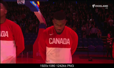

  24. Both clips look fine. Deinterlacer's are going to have problems with that large scrolling video display in the background of the clip in post #21. But that's not an encoding error in the source, it's just what happens when you have thin horizontal lines in interlaced video. One field (SeparateFields() in AviSynth):
    [Attachment 50485 - Click to enlarge]
  25. Yes, both clips are ok in terms of that issue

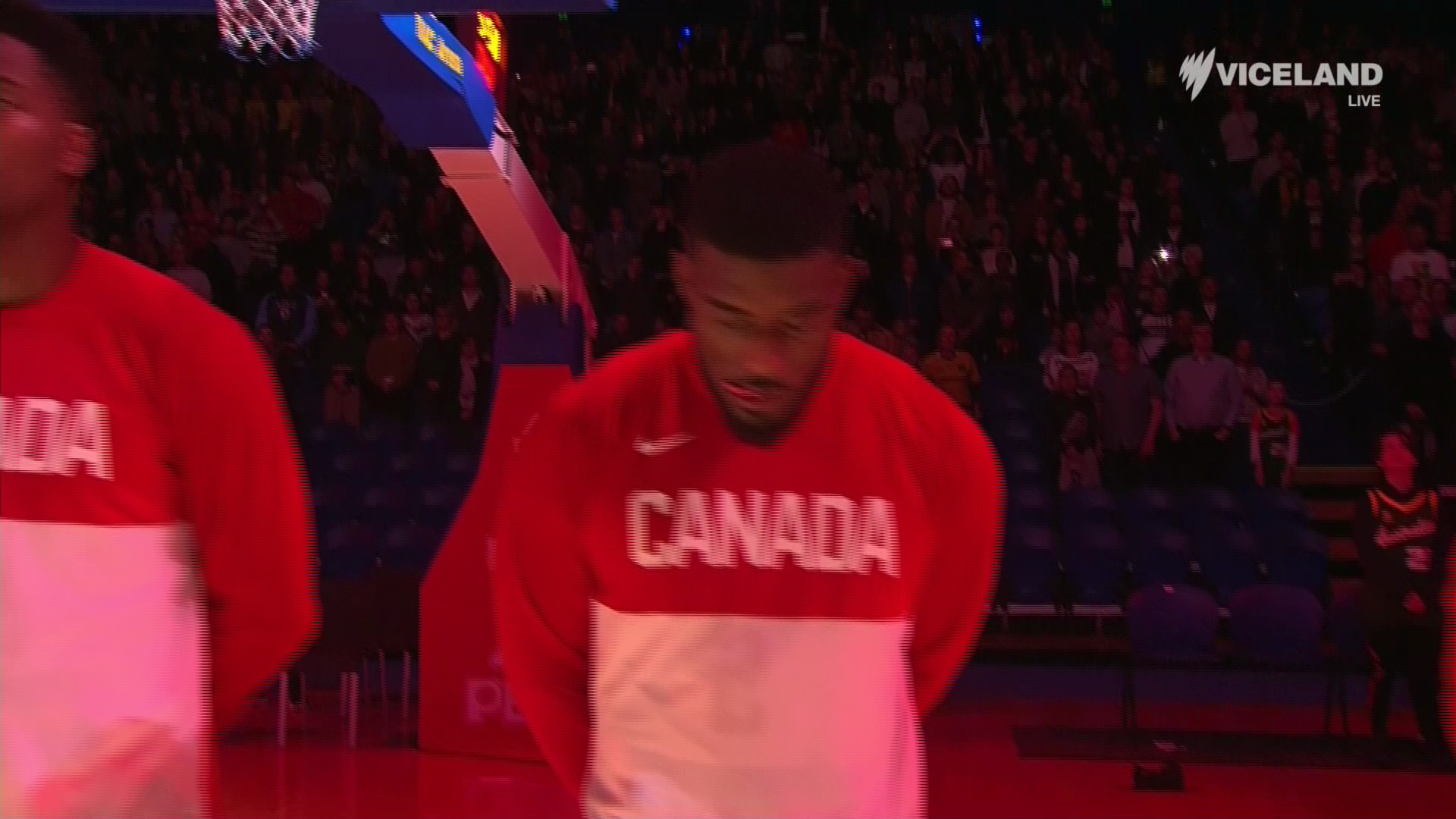

  29. Yeah, I've been using this:
    LWLibavVideoSource("g1.ts")
    AssumeTFF()
    Trim(35624,35624)
    Which gets me this:
    If I then apply the VDub bob doubler filter, set to "TFF" and "Bob", I get the combing issue:

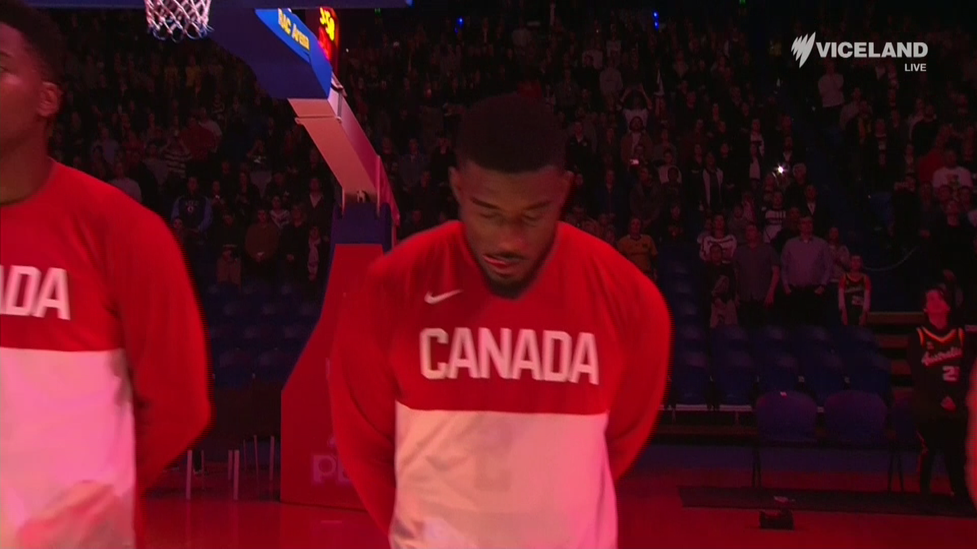

    However if I use this, and remove the VDub filter:
    AssumeTFF()
    Trim(35624,35624)
    Bob()
    I get this, which is fine:
  30. VirtualDub doesn't handle interlaced YV12 properly. Convert to YUY2 (which VirtualDub does handle properly) and you'll see the video is fine with VirtualDub's Bob Doubler.
    AssumeTFF()
    Trim(35624,35624)
    ConvertToYUY2(interlaced=true)
    This is a longstanding bug in VirtualDub. Avery Lee refused to fix it, arguing instead that interlaced YV12 shouldn't use the same fourcc as progressive YV12.
