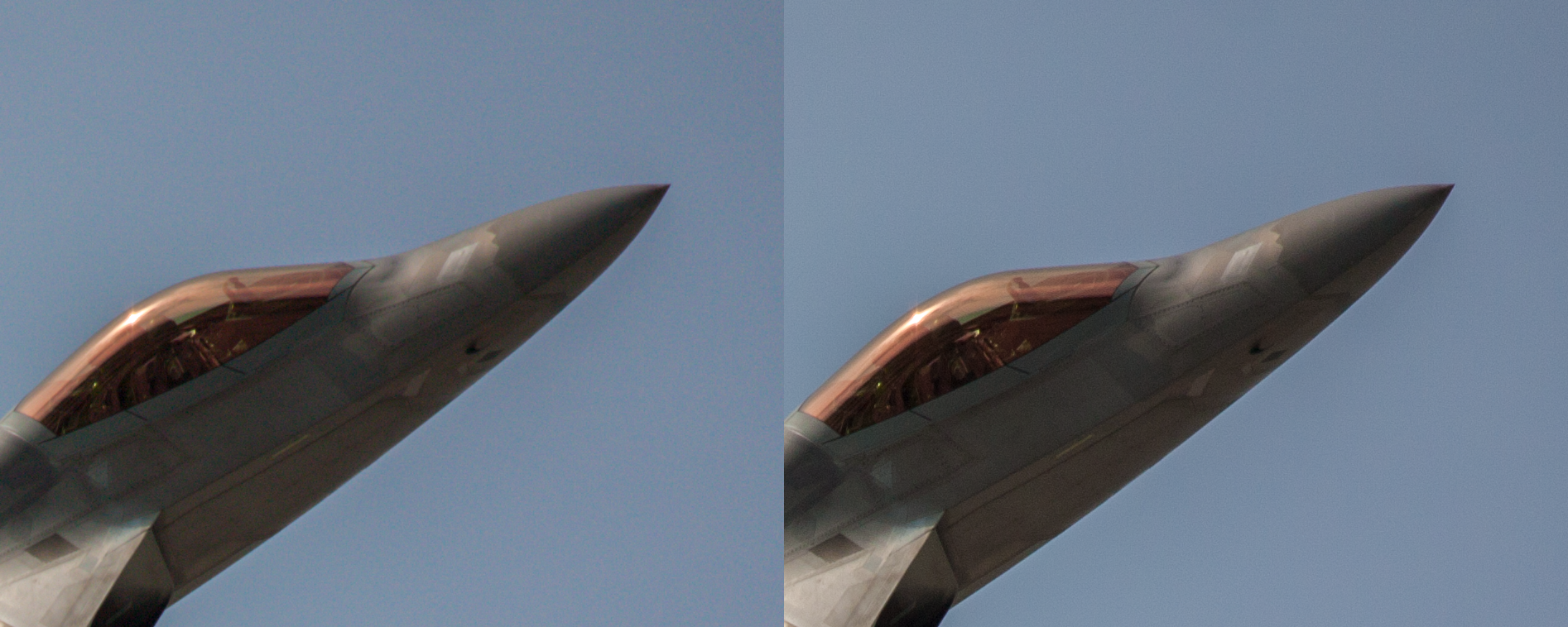

    But I can't see where they say they added a layer of noise over everything. I mean the noise pattern I see is what I see when denoising the chroma on my DSLR photos in Lightroom. Left being no denoising on the RAW, right having Chroma denoising along with some light sharpening done to it. There is still noise that gets left behind.
