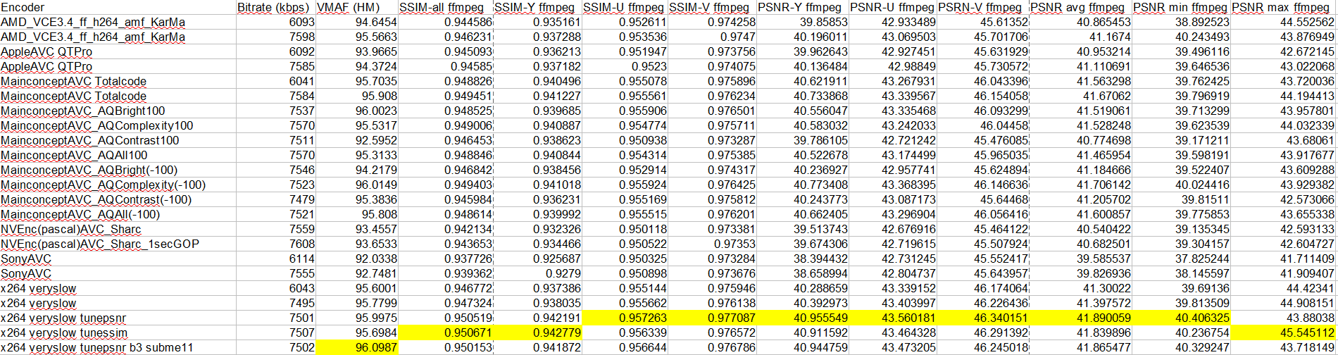

  2. Originally Posted by poisondeathray View Post
    Notice the PSNR Min value is abnormally low for NVEnc(pascal), AMD(vce4.3), Apple(QTPro). If you look at the per frame data, all 3 had blips on real frame 1186 which is the 1st frame of the scene change (ffmpeg logs start at "1" not "zero", so the blip is on 1187 in the log) . But looking at each of them, it's not terribly different than the surrounding frames (they are all "lowish" in quality, but about the same) .
    This is very strange. These low minima will also unduly lower the average value, I guess.
    How is the average calculated btw.? Is it a linear average or an average of the decibels?
    Most of the encodes were 2-pass VBR, some (e.g. all HW encodes) 1-pass constant quality or constant quantizer. Just wondering how much 1-pass or 2-passes affect the result (for this short clip).
    Also, were the pictures (.png) within a series (1, 2 or 3) all of the same type for the various encoders (means all B,P or I)? Comparing pictures of different types for rating would be doubtful or possibly misleading, I think, even though we compare at same file size.
    Added: I just noticed that SONY Vegas does not support B frames at all..... so I guess the pictures are of different type? Anyway, a metric (PSNR etc.) which analyzes the full clip will deliver an 'average' of the I,B,P cadence though.
  3. Originally Posted by Sharc View Post
    For ffmpeg psnr/ssim I think it's arithmetic mean (simple average) . I'll double check, but I just copy/pasted into the spreadsheet what ffmpeg spit out as the final . But that's why I use the per-frame logs , in case something is amiss you can go check which frames are "off" .
    vmaf is different in that you can use harmonic mean or arithmetic mean . HM "penalizes" bad frames more .
    1 was mixed, but definitely not I-frame
    2,3 were I-Frames for x264, MC (mentioned in the code box, "series 2 & 3 - frame 1000 (I frame for MC and x264)")
    The point was to include an I-frame and a non I-frame. I use FFVideoSource() with FFInfo() and you can check frametypes as you go along and hot swap in avspmod or vapoursynth multi viewer. Single frames are limited, you need to look at a bunch of frames . The point of that framecompare website was to emulate the experience of how superimposing and your brain's split second memory can help in seeing differences .
    Sony wasn't in that framecompare comparison; and you can match up per frame metrics with frame type if you want . For example, if a certain encoder has "weak" b-frames it might be shown in that type of comparison

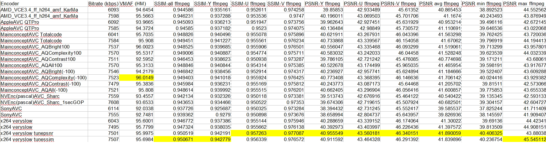

  14. FWIW I found this presentation quite interesting:
    https://streaminglearningcenter.com/wp-content/uploads/2019/10/Choosing-an-x264-Preset_1.pdf
    Slide 3 states that (untrained) people will notice a quality difference at around 5 ... 6 VMAF points under normal "3H viewing" condition.
    According to poisondeathray's table 'results_upd.png' all encoders are within 96.0149/92.0338 = 1.0433 => 4.33% which would explain sophisticles' statement that he can't see a difference (for 'normal' viewing conditions).
    Of course this has nothing to do with calling x264 'the most overrated encoder'.

  16. Originally Posted by sophisticles View Post
    According to PDR's own tests, MC beats it
    In what way?
    It does not show that
  17. Originally Posted by poisondeathray View Post
    In what way?
    The VMAF graph that you yourself put together and the samples that you posted.
  18. Originally Posted by sophisticles View Post
    In what way?
    1) VMAF measures at 3H distance only, it only attempts to measure some of the data - its missing part of the picture. It also does not measure color information. 2) VMAF results on this test do not seem to correlate very well to what the majority of responders are reporting. (Apparently there is 1 outlier that thinks differently)
    Do you agree that AQComplexity(-100) is the most similar? I thought that even some of the other MC encodes were more similar than that one. But x264 veryslow using default settings was the most similar
    What about PSNR and SSIM ? Aren't you a strong proponent of objective metrics ?
    And this is why I am such a strong proponent of objective metrics and place less emphasis on subjective metrics. In this case, the PSNR calculations where signalling something was wrong when it was imperceptible to the naked eye.
    Math does not lie, but your eyes do.
    Since you put a lot of "weight" into objective metrics, x264 still "wins" in your mind, by your criteria. VMAF is not an objective metric. It cannot even measure 100% accurately (source against itself). PSNR is the most classically "objective" metric, and not suprisingly x264 --tune psnr "wins."
    But PSNR optimized encode looks visually dissimilar, most people would agree. It's not useful - tuning an encoder just to score higher, but in most people's eyes look dissimilar, so it can "win" some award. You could probably make a --tune VMAF preset to have it "win" that too. (Intel SVT-HEVC had a VMAF tune preset for a while, but it got removed recently) . I gave some hints on how you might do this if someone was so inclined
    According to who ? The one outlier? You ? If someone cannot tell the quality difference between a youtube video quality, or identify simple banding or compression artifacts, I wouldn't put much weight into their observational skills . They suggest the opposite to what you are saying
    It's probably pointless, but can you point out or describe why you think the samples show this ?

  24. x264 was only using "veryslow" defaults and ~2-3x faster than the MC encodes which were set to "best", so in a sense x264 was being "handicapped." You could use slower settings, or optimize it for VMAF in this scenario if you wanted to.
    Some options might be: slow first pass, more (or less) bframes, open GOP or adjust GOP (up to) infinite keyint, subme 11, me tesa, larger merange, larger rc-lookahead, adjust IP/PB ratios or mbtree, etc...you could even use zones if there were specific problem sections. The other encoders are already maxed out, and/or do not allow some of those adjustments.
    But it looks like VMAF is sensitive to x264 b-frames , at least on this scene. Changing to --bframes 3 (with --preset veryslow --tune psnr) yields 96.0815 . We have a new "winner" --subme 11 gives a slight bump as well to 96.0987 . At those settings it's still about 1.5x faster , and 1st pass about 10-15x faster than MC . Many other things you can still optimize, but diminishing returns . Almost anything with --tune psnr looks worse subjectively, more blurry, less detail. (Some exceptions might be some types of cartoons)
    You can also "cheat" by pumping bitrate to Y' from CbCr for with --chroma-qp-offset for VMAF, but the PSNR and SSIM U,V should pick up on that. One thing they are good for is trends if nothing else.

  25. I redid my NVencC (Pascal) 1-sec GOP encode, reducing --aq-strength from 8 to 1. To my surprise VMAF(HM) improved from 93.6533 to 95.3628 (even at a slightly lower bitrate). It is also visually better (details, sharpness). For this clip a strong aq seems to do more harm than good.

  28. Originally Posted by Sharc View Post
    What about disabling it entirely ?
  29. Originally Posted by poisondeathray View Post
    Disabling --aq resulted in another tiny improvement of VMAF (from 95.3628 to 95.3672) but at a 1.2% lower bitrate of 7.157 Mbps (=7'329 kbps). I couldn't hit exactly the same bitrate with the constant quality encode.
