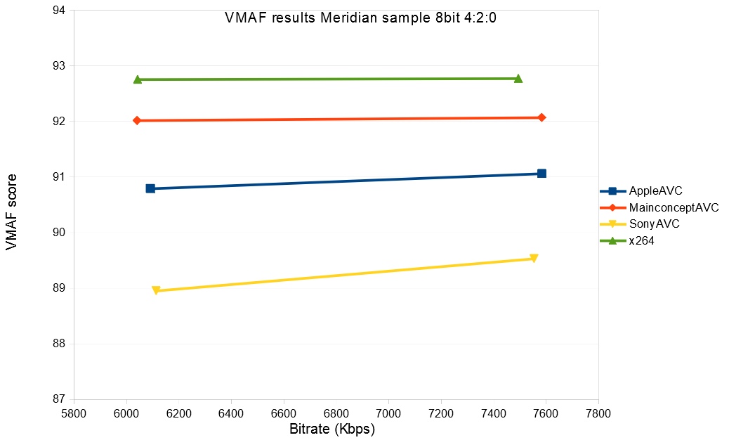

    sorry for the ugly graph
    [Attachment 50444 - Click to enlarge]

    I'm not "proving" anything with VMAF. I'm only adding it because it's the new shiny toy from Netfilx. We never had it back then when doing all those tests. The old metrics reported certain results, what does this shiny new toy say? And how does it correlate with what you "see" ?
    VMAF is commonly perceived as one of the better modern metrics that takes into account human subjective perception. Note that VMAF has various issue too ; but they are constantly improving it - you can't say that about the many other metrics .
    I'm saying the same thing I've always said - I'm telling you NOT to trust it, at least not blindly. Be careful. I'm asking you to correlate the results with what you "see" in terms of similarity to the source. That's what they did when training models, but there is so much variation in human perception. I said the same thing when x264 "won" with the other metrics way back. Don't put a lot of weight into them, you need to use your eyes. They aren't perfect and easily tricked. I even proved it with examples.
    It's just 1 metric, and this is just 1 test, another data point. You need to look at other samples, different genres (eg. cartoons, video games, action movies, sci fi , tearjerker drama, sporting event, etc..) , look at other tests and correlate them with what you see . If all the tests, subjective and objective move in the same direction and suggest the same thing, then it's stronger than just 1 test saying something

    And those were basically "default" settings for high quality preset (if the encoder had a preset). GOP wasn't necessarily ideal, and you could tune some x264 settings better for this type of content and GOP makeup . And if there were "serious" problems, you could always use qpfile or zones
    Despite PDR's obvious attempts at cheating, by using old, outdated, discontinued, and crippled software, as is the case of MC and Apple's AVC encoder against the latest x264 builds
    Hahah nice one. I should have crippled MC, because that's what people commonly use. The one bundled with the NLE such as Adobe, Vegas (Magix , not Sony now, but they have a licensed low end version from MC too)
    I strong suspect Apple AVC is basically the same. There is no control in FCP7 or FCPX if you look at the manual. If anything it might even be worse considering the direction FCPX was headed. Someone can post an encode if they want to.
    In a sense, MC gives their lower featured encoder away for "free" or at low cost. Applications like video editors license a bunch of codecs, containers and formats, not just AVC. Such as MPEG2, MJPEG, XDCAM, DV, DVCHD , or MXF/MP4/TS/M2TS/MTS splitters and wrappers . An editor need to be able to import and export many types of formats, sometimes with specific specifications. Many of them are licensed for Mainconcept because of bundle pricing. If they bought "a la cart", or piecemeal from multiple vendors, it would be too expensive. And the one featured in NLE's is lacking many features
    all encodes are fairly close to one another in quality, under normal viewing conditions
    Yes, and that's very important point for the end user. That's what Netflix 's metric measures specifically. Not pixel peeping. Not pausing, zooming in. I will add comments on VMAF a bit later pros/cons, and my experiences with it. Also compare with conventional metrics like PSNR, SSIM
    But from a producer standpoint, you need to be more critical and have higher standards ; to be aware of pros/cons of certain workflows or encoders. The audience might not pixel peep, but the producer will . You don't want things like actor/actress's faces blurred away
    If a commercial BD were created using any of these encoders, I don't think anyone would be able to pick out any differences with the naked eye, With the latest full featured versions of each encoder, chances are the objective metrics may be too close to call as well at BD bit-rates.
    You can't say that based on this test. This test didn't test that scenario. Be careful on how you apply the observations/results of 1 test , 1 scenario to others.
    BD spec encoders have restrictions. For example 1080p59.94 is "illegal" . Typical is 1 sec GOP. You can't use 8 bframes etc... . There are VBV restrictions, buffer restrictions, the list goes on and on. You'd have to compare BD spec encodes to verify that assertion. And do you think that has been done before? You bet it has.
    And this is "artificial test" in many ways. Because you wouldn't use that many refs or b-frames for delivery . Higher requirements for decoding (L5.2), increased latency. Those setting would only be used in personal use scenario in real life. A more realistic test would be restricted to say L4.1 specs . 6-8 b-frames is still "legit" in a sense, some producers like BBC streams have than many

    Sharc thought AQall100 was most similar. I still think x264 is most similar overall, because of the grain and detail characteristics.
    => You never answered which video was the most similar, and why. Is it just a gut feeling? Describe why
    I need to know "why" people think this. This helps you learn and understand about perception.
    I already posted why I though x264 was more similar. It preserves details better, the grain better, and I put a higher weight on details contained in the source. Do you guys weigh that lower when you are considering "similarity"?
    The funniest, in a sad sense, part is that for years you, and people like you, have claimed that objective metrics can not be trusted to determine quality, that only your eyes can be trusted to make that determination. For years I have been saying on these boards that the job of an encoder is to reproduce the source as accurately as possible, not to make it look as good as possible and you and I, and a few other, have argued back and forth about this.
    When your own test results in an scenario where most agree that the MC encode looks better, you then adopt my stance nearly word for word, parroting my viewpoints (does {Polly want a cracker?) and standing on the results of an objective metric (VMAF) rather than what most people would agree is the nicer encode (MC).
    We agree on the job of the encoder. But we are having clear perceptual differences here. I want to understand why. I'm being serious here.
    Two other people replied . Is that "most people"? I guess that can be considered "most" . 2 vs. 1 . Do you think that's a good sample size ?
    Actually I made a mistake with VMAF; I'll update the post when I verify. But I doubled checked with the official VMAF tools and vmafossexec. VMAF thinks MC is on top, and one of the (-100) encodes is the top according to it. I'm going to purposely without it for a bit when we discuss perception . This can help validate VMAF, and improve it's predictive capability and results for the future
    This is especially dishonest of you when you consider that you actually admit the x264 encode has significant problems.
    You are the typical x264 zealot.
    How is it dishonest ? I'm being honest by telling you it has problems in case you missed them. (You probably missed them, I'm surprised you didn't scream it, which suggests how relevant the popping is. If you blink you'll miss it at this framerate)
    I'm telling you , you can fix the keyframe popping issue this with a proper encode , not using the default settings (which I did on purpose) . If you're allowed adjust MC settings from the default, are you not allowed to adjust other encoders ? MC maxes out at 300, you will still get keyframe popping there.
    Did you notice as you adjust MC AQ modes where, it becomes more "x264 like" in terms of retaining detail ? That's why I was a bit surprised earlier. Also , the keyframe popping gets worse when the detail and grain retention increases, just like x264 .
    I see the MC problems as worse overall, because it's missing too much detail . The keyframe pumping is in the grand scheme is minor - all of them have it to an extent - and occurs less frequently with MC and x264. And you can eliminate it completely with x264 settings in this scenario.
    I'm more interested in the perception aspect. Why does someone see "a" as being more similar to "b" ? and so forth. I will post later about this perception difference, and VMAF results with VMAF overall discussion pros/cons.
