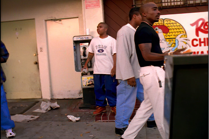

    I'm trying to create lossless video from .tiff files but in the output colors in the video are not the same. Any tips?
    My command is:
    ffmpeg -f image2 -r 30 -i "Base000%03d.tiff" -c:v prores -c:a pcm_s16le output.mov
    But you can see that colors not the same.
    Source:
    Ffmpeg output:
    Tiff files: https://drive.google.com/file/d/1JxnBTHlcAZmwofdDSNKl36FhkFbqLi7b/view
  2. The problem is your TIFF sequence uses a ProPhoto color profile . FFmpeg isn't color managed
    If you wanted to use FFmpeg, you would need to convert the prophoto profile to something like sRGB first then feed that into FFmpeg
    But what applications are you using, and what applications is this destined for ? You could just convert it in photoshop for example, you can export video from PS
    Or gimp or most image editors should be able to batch convert the images to sRGB
    And did you really mean "lossless?" Prores video won't give you "lossless". Or were you just referring to the colors ?

  4. You should specify explicitly parameters related to color space and quantization range. Also perhaps try to avoid to use SWScaler.
  5. You can use imagemagick to batch convert to srgb png sequence, then use that png sequence as input ffmpeg . There might be a way to pipe the output from IM convert to ffmpeg directly
    It Windows would look like this; you need to adjust the paths
    for %%a in ("*.tiff") do "convert.exe" "%%a" -colorspace sRGB -profile "sRGB2014.icc" %%~na.png"
    pause
    If prores was good enough, then ffmpeg using the png sequence
    ffmpeg -r 24 -i "Base%06d.png" -vf zscale=matrix=470bg,format=yuv422p10le -c:v prores -profile:v 3 -vendor apl0 -an "output.mov"
    I just did 3 frames to reduce the filesize for this demo test . You can test if it looks ok in your other application. Sometimes you might have to adjust the metadata with a bitstream filter, or use another format than prores

    Thanks, i will try that in photoshop, that's a very good catch! This files are really really have prophoto color profile. What i'm doing: i've splitted video into frames and each frame is running through "topazlabs image to raw ai" and after that i will conevrt those images to video. As what i see, this is giving more details and can give lil bit more quality to the video.
    I though that "ffmpeg -f image2 -r 30 -i "Base000%03d.tiff" -c:v prores output.mov" was best command to make a lossless video from this images. What then command should be?
