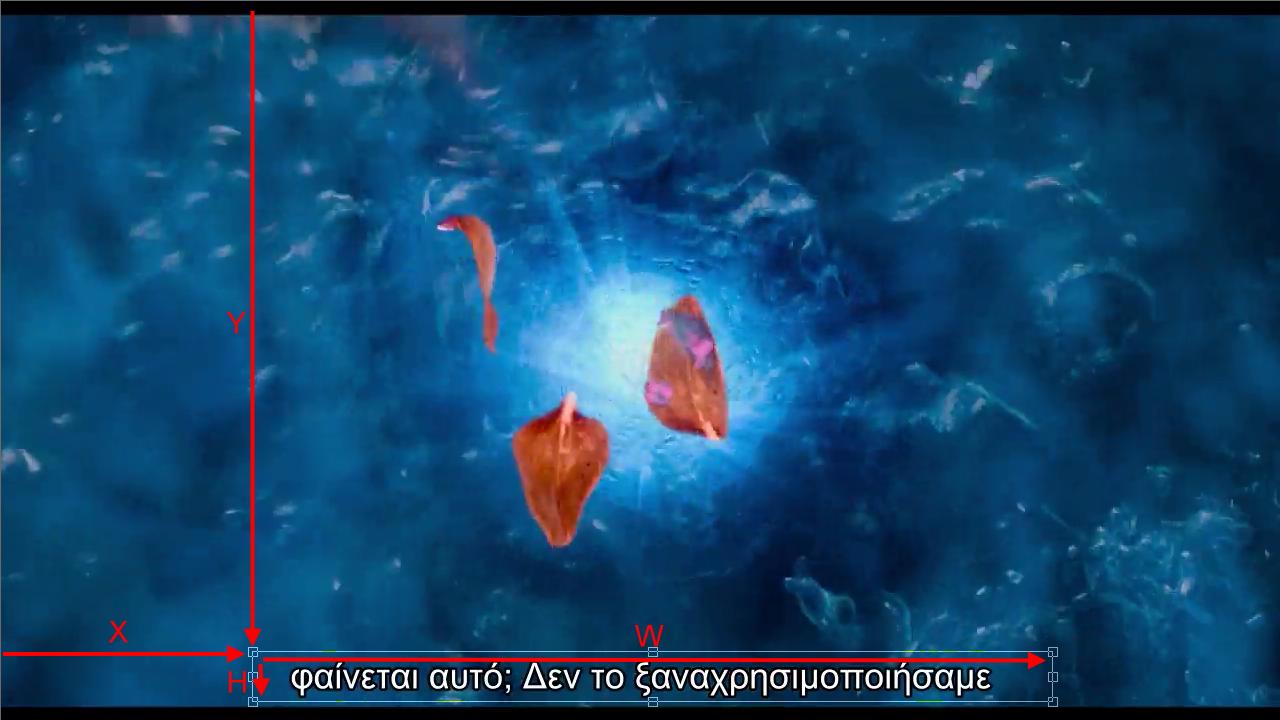

  3. You can always use a full path for the output file to put it exactly where you want it.
    Some people prefer to use a in-filled box with the delogo filter, instead of a black box to cover the subs, or cropping to remove them:
    "G:\Program Files\ffmpeg\bin\ffmpeg.exe" -i %1  -vf delogo=x=251:y=650:w=800:h=50 -c:a aac -b:a 192k %1.delogo.mkv
    X and Y are the top left coordinates of the box that's infilled. W and H are the width and height of the box. The box should be big enough to cover the widest and tallest subs. Personally, I find all the results of all these sub removal techniques to be more distracting than the subs.

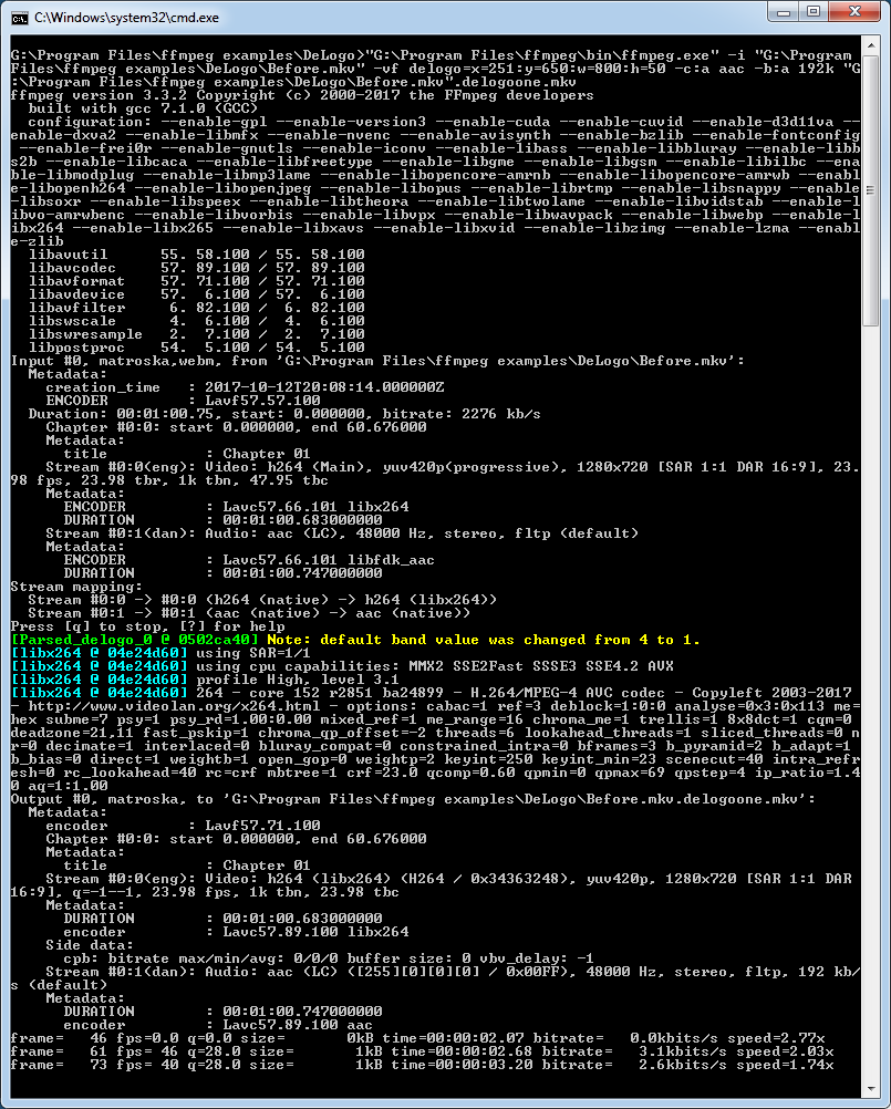

    Add a second line to the batch file with "pause":
    pause
    That way the CMD window will remain open until you press a key (some errors may cause the window to close automatically). Look for any error messages while the window is still open. Did you change the path to ffmpeg,exe? Bad coordinates for the delogo filter will also cause the program to abort. The box must not extend outside the video frame.
    [Attachment 50435 - Click to enlarge]

    I gave you a sample image that shows how to get the coordinates. Export a frame from your video, open it in an image editor, use the editors tools to determine the x, y, w, h parameters.

  25. Something is wrong with the batch file. But the first few lines aren't visible in your screen shot. Right click on the batch file, select Send To -> Compressed (Zip) Folder. Then upload the zip file attached to a post here.

  27. Your batch file looks ok as long as the path to ffmpeg.exe is correct. You should be able to drag/drop any video file onto the batch file to produce a new file with the logo removed. The CMD window that opens should look like:

    Just change the values in the batch file. For example, if your subtitles start at x=100 change the x=251 in the batch file to x=100, etc. All this filter does is in-fill a rectangular box as defined by the x, y, w, and h parameters. x and y are the location of the top left corner of the box. w is the width of the box, h is the height of the box. Just like I showed in the image in post #20.
