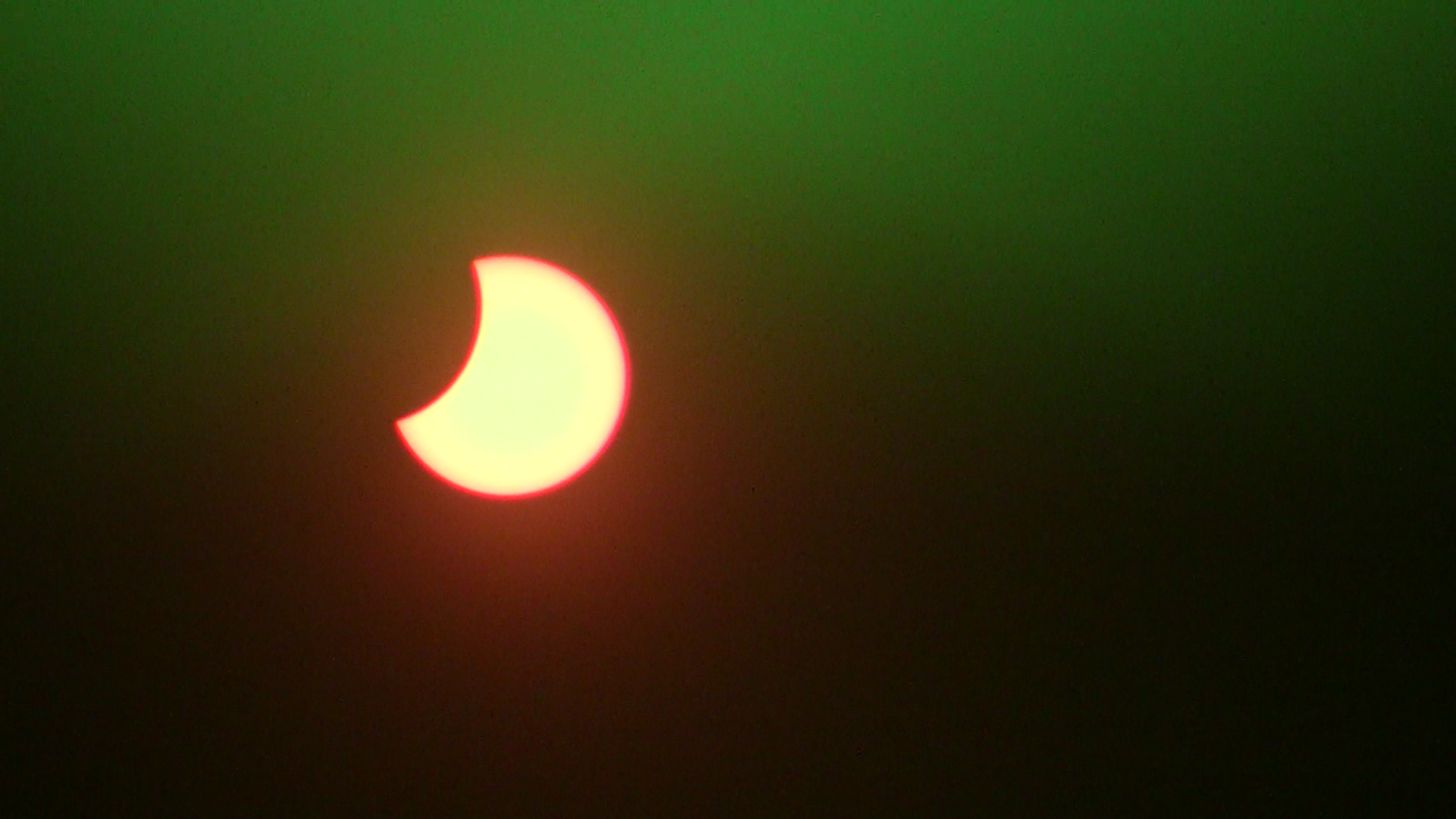

    Thanks for the suggestions.
    jagabo I don't know Animate but will look into it, I'm use to the other stuff like deinterlace, bob, weave, playback rate, drop frames, etc. Yes the motion would be linear, but what makes it tricky is you go from a full sun, to a sliver and tracking that last edge may through the auto stuff off. I did try blender once and that had a tough time with the auto part.
    Karma, Vegas does have a nice start/stop key frame and will auto transition between the key frames pretty nicely. I do have a few other issues I'll need to work through. The motion is linear top-left to bottom right at a constant rate but... I did reframe every so often (no fixted interval) and will have to just split on those. So with the changing framing the video frame gets moves away from the Top-left and results in the background showing so I'll need to figure out some interesting pattern with blur on that region to blend it.
    There's a third issue after total coverage when the sun in coming out from behind the moon the solar glasses I had taped onto the camcorder weren't positioned correctly so I get a nice green/red glow from the painters tape that I need to figure out how to fix...
    [Attachment 50386 - Click to enlarge]
  5. Here's an example using Animate() to track on object that's moving linearly:
    function MoveSun(clip black, clip sun, float x, float y)
        Overlay(black, sun, x=Int(x), y=Int(y))
    function CropSun(clip v, float x, float y)
        Spline36Resize(v, 448.0, 448, x, y, 448, 448) # using resize rather than crop gives us sub-pixel accuracy
    ImageSource("Ecliplse000119.png", start=0, end=1000, fps=29.97).ConvertTOYV24()
    ShowFrameNumber(x=650, y=500) # stamp frame number on sun as reference
    black = BlankClip(last) # a black clip onto which we'll pan the sun image
    background = Animate(0,1000, "MoveSun", black,last,-300,-200, black,last,1500,500) # the sun pans across the background
    sun = Animate(0,680, "CropSun", background,143.0,69.0, background,1372.0, 550.0) # crop a 448x448 box that follows the sun
    Overlay(background, sun, background.width-sun.width, 0) # overlay the stationary sun at the top right corner of the original video
    Trim(0,680)
    The first Animate() just pans the stationary sun image across the black background to have a moving sun to track. The second Animate() crops out a 448x448 box that follows the sun -- this is the part you're interested in. Here I overlaid the stabilized sun at the top right of the video but you would probably want to just return the stabilized sun image. The sun is shaky because the Overlay() used to pan it across the frame isn't sub-pixel accurate.
