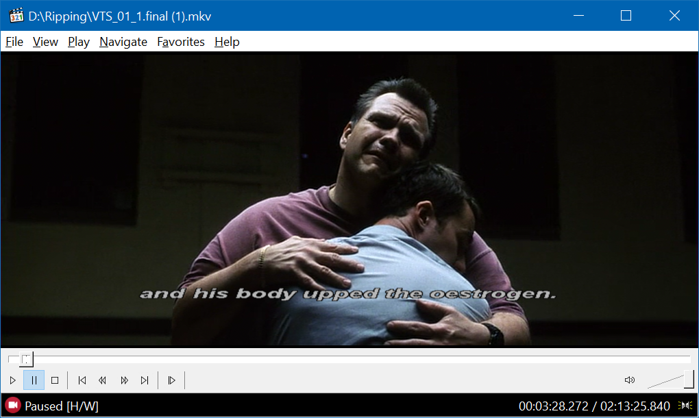

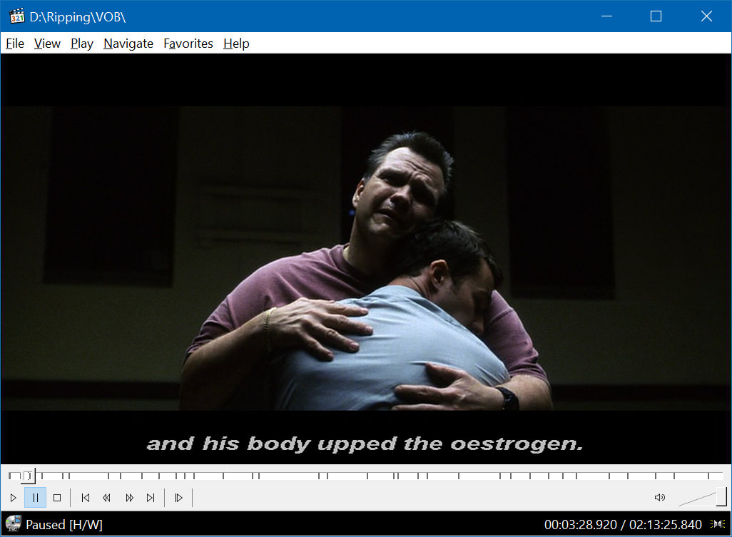

  1. I remember being told back in the days that black bars should always be cropped when encoding videos, and while it makes sense to remove anything useless to improve compression I wonder if it truly is the wisest thing to do, specifically when it comes to subtitles. Take a look at those screenshots
    Source material
    [Attachment 50378 - Click to enlarge]
    After encoding, with cropping
    [Attachment 50379 - Click to enlarge]
    Obviously, the black bars allow for better placement and legibility of the subtitles, so... is cropping bad in that case?

  3. Originally Posted by Selur View Post
    You might also want to look at those two files if you run them in fullscreen on a display that isn't 4:3,...
    This result in the exact same placement. Maybe other players wouldn't mind placing subtitles outside of the video frame, but MPC-HC does not. I don't believe the former is even possible.
