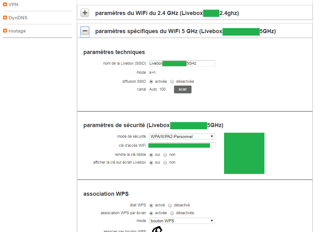

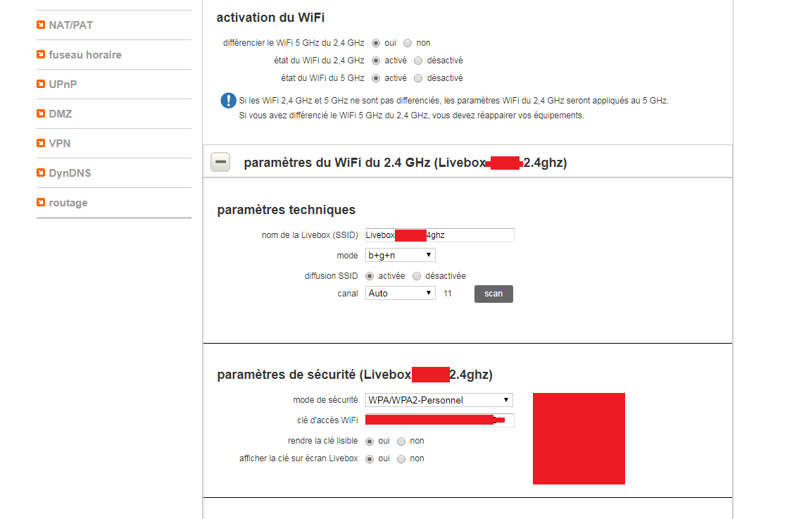

So I have a livebox pro v3
and the device is an Advisen IP camera (who work only with 2,4 Ghz)
I installed the required Advisen app on my tablet to make the camera work but when I'm going to conclude the configuration, it show "not compatible with 5 Ghz" and I can do nothing with the cam.
Here is what I have when I changed the 5 Ghz into 2,4 Ghz (this is the livebox settings)
[Attachment 50370 - Click to enlarge]
[Attachment 50371 - Click to enlarge]Last edited by WazaKrash; 21st Jan 2020 at 00:35.
Well... i can only guess due French language but - seem your router (or rather access point) on 5GHz support only a and n mode - this uncommon nowadays and perhaps reason why you can't use 5GHz on your device - i assume your device use ac mode and may not support AP with only a+n mode.
To reduce length of thread - please consider to buy something more modern. Disable wifi in your router and try to connect new AP trough wire - if your router is provided by your ISP then try to set bridge mode without activating wifi. Another option is using wifi extender capable to work in AP mode.
Your livebox is really old and it may be primary source of your problems.
btw due of security WPS should be disabled.
2.4GHz is usually very crowded - try to disable auto channel selection and manually select best channel.
there also other big topic - multicast support over wifi - not all devices support multicasting on wifi - i bet if you hook your camera with cable then it will work. -
