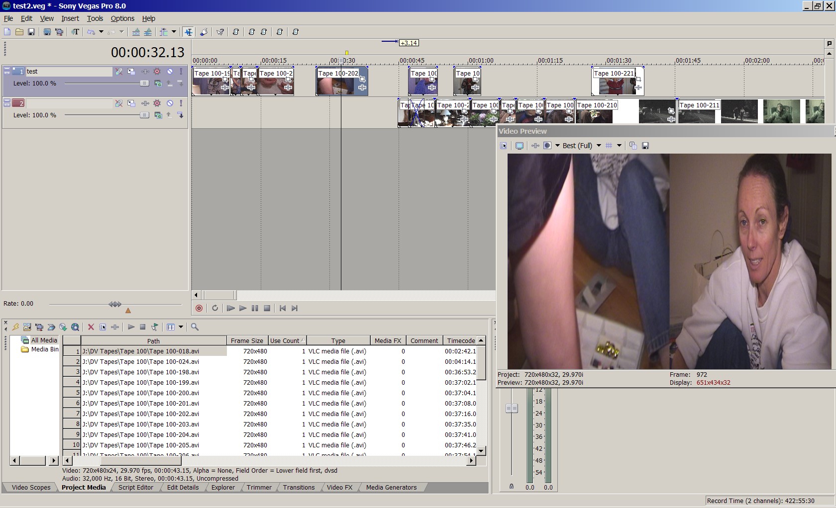

    In my NLE (Vegas) I can see both the head and the tail of the clip, once it is inserted into a gap. That way you avoid the problem Al describes. The picture below shows what it looks like when I am moving the video back and forth within the fixed event. Note that the display is showing a split screen with both the head and tail shown simultaneously (they are squished 50% so that you actually see then entire frame width of both the head & tail).
    I have shown the event with space on either side (i.e., not fit exactly into a gap) simply to make it clearer which event I am working on.
Name:	temp split screen.jpg
