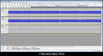

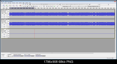

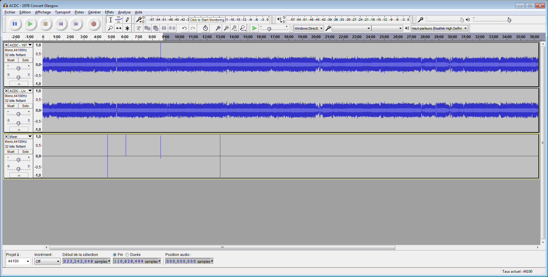

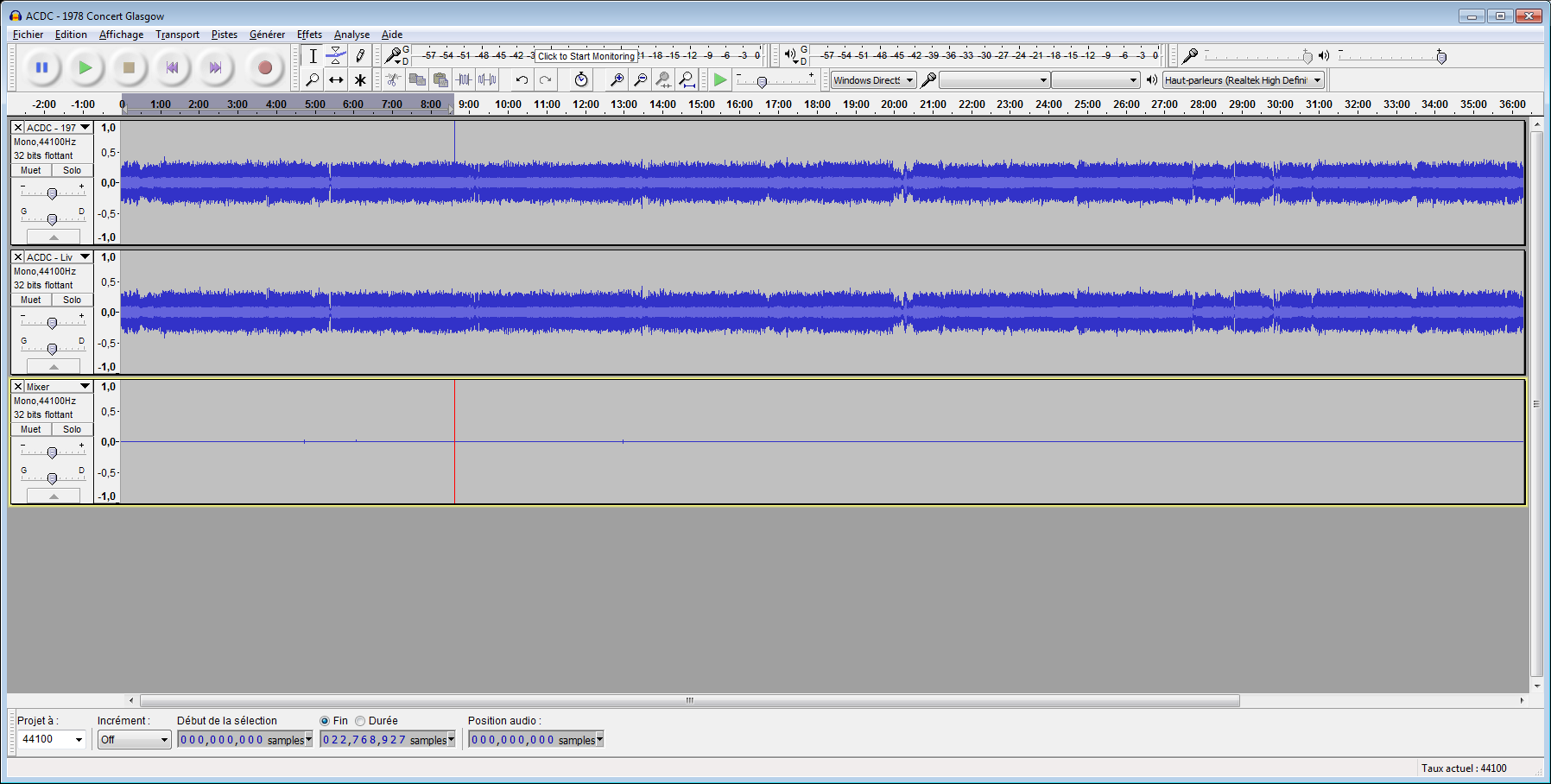

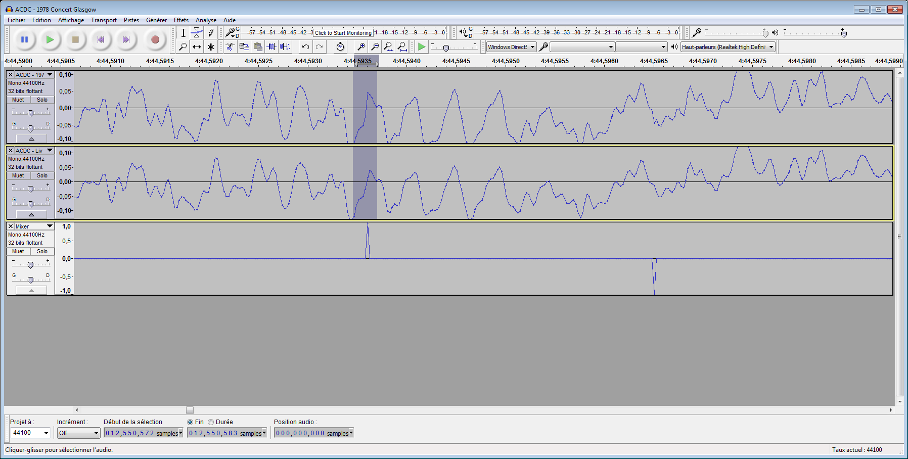

    What I already did : I exported the mono audio from those three files with VirtualDub, converted it to stereo WAV with foobar2000, then used the “Compare WAVs” feature in ExactAudioCopy (it's the only tool I know which can compare two audio files at the sample level and output a list of all differences found, but it only accepts 44.1kHz stereo WAV format ; and if the mono to stereo conversion is done with Audacity, EAC considers the resulting files as totally different from the beginning to the end – perhaps that's due to the internal 32-bit float conversion ? but isn't foobar2000 supposed to work in 32-bit float too ?). And then, opening each WAV file and examining one of the listed spots with near maximum magnification, I can indeed see some glitches in some files which are not present in some other(s). But that's quite tedious, and I don't know of a way to do such a thorough comparison for the video stream.
    I have also made a rough estimation based on the position of a given discrepancy, converted to a percentage of the total size, then applying that percentage to the total playback time, then opening each file in VirtualDub2 and scrubbing the footage around that spot : that way I found a video glitch at 3min52s on two of them while the third one is correct (it doesn't mean that it's the original file, as it could be corrupted elsewhere, but so far that one seems to be the most likely candidate). Again, it's too tedious and haphazard.
    As a side question, what can cause that kind of minute corruption over time ? Usually HDD corruption results in whole sectors (512 bytes in a row) or clusters (usually 4096 bytes in a row) becoming empty or ending up with garbage data. And normally each downloaded file is thoroughly verified during the download and again at the end before the download is considered complete to ensure that the data was not altered, so a single altered byte should result in the corresponding 9500KB segment being discarded and downloaded again. (The temporary metadata files associated with each partial download contain a list of checksums for each 9500KB segment of the complete file, so by comparing those metadata files I managed to pinpoint the approximate location of those discrepancies, even for the files which are not finished downloading.)

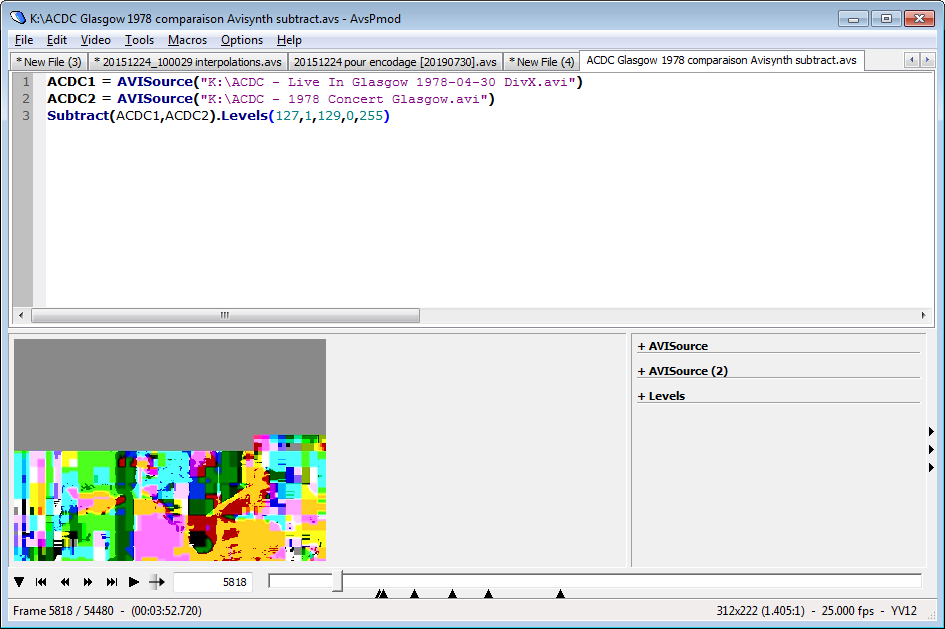

    reply from other thread -
    The clips have to be aligned , same frame count
    Overlay(clip1, clip2, mode="Difference", pc_range=true)
    Levels(127, 1, 129, 0, 255, false)
    or
    Subtract(clip1, clip2).Levels(127, 1, 129, 0, 255)
    It will be grey if they are exactly the same
    But there can be other differences, e.g. compression . If one uses xvid, one uses xvid different settings, or avc etc...

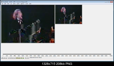

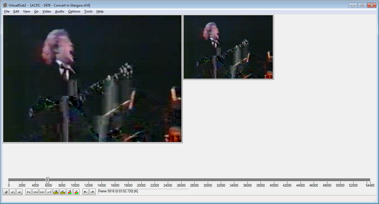

    If I go to timecode 3m52s720, to display a frame which I already identified as corrupted on one of these files (before it was finished downloading, by looking at the partial hashes in the metadata files and seeing that for the corresponding part it had the same hash as another file for which I had already identified a corruption at that spot), I can indeed see a garbled picture :
Name:	ACDC Glasgow 1978 Avisynth Subtract f5818.png
    But the glitch is obvious enough in the video parsed directly that such an enhancement method is not necessary to spot it :
Name:	ACDC Glasgow 1978 - 2878 - VD - 3m52s720 glitch vidéo.png
    What I'm looking for is a convenient way to get a list of the affected frames, so as to avoid having to painstakingly look for them in six 36min video files.

    If I then check those frames on the file already identified as corrupted, I can see that they are indeed garbled ; in most instances it's much less obvious than on the example shown above (it could pass as encoding artifacts and would be quite difficult to spot, well, on the spot). For the last ones, starting from 43904, it's slightly shifted : in VirtualDub looking at the original footage or in AVSPMod looking at the “Subtract” output, I can see defects but starting from 43913.

  7. Audacity: Load two tracks, invert one, merge two tracks into one, amplify. If they're identical the result will be silence.

  9. Audacity: Load two tracks, invert one, merge two tracks into one, amplify. If they're identical the result will be silence.
    Works indeed (most confusing part is how to select one complete track), even with native mono audio. In this case one glitch is strong enough that it results in a very obvious 100% peak.
Name:	068 ~ 2985 audio Audacity (mono).png
    After a 30dB amplification for most of the track (the maximum would have been 30.1dB), and a -0.5dB amplification for that one spot, four peaks are clearly visible :
Name:	068 ~ 2985 audio Audacity (mono, après amplification +30dB et -0.5dB au niveau du pic Ă* 100%).png
    Here the one on the left would have been very difficult to spot by comparing the original waveforms (while the one on the right is more obvious) :
Name:	068 ~ 2985 audio Audacity (mono, après amplification +30dB et -0.5dB au niveau du pic Ă* 100%) .png

  11. You can get a text file with a list of different frames from AviSynth using WriteFile().
    # Abs(v1-v2)
    # diffs of Y, U, V channels returned in Y only, UtoY() and VtoY() stacked
    # works for YUY2 and YV12 only
    function AbsSubtract(clip v1, clip v2)
        Subtract(v1, v2).ColorYUV(off_y=2)
        IsYUY2() ? StackHorizontal(last.GreyScale(), UtoY(), VtoY()) : last
        IsYV12() ? StackHorizontal(last.GreyScale(), StackVertical(UtoY(), VtoY())) : last
        Overlay(last.ColorYUV(off_y=-128), last.Invert().ColorYUV(off_y=-127), mode="add")
    # open v1 and v2, the two videos to compare.  We're going to create videos with ColorBars() here:
    v1 = ColorBars().Trim(0,150).ConvertToYUY2() # or YV12
    # Create v2 from v1 with a small error in the blue bar in frame 101:
    v2 = v1.Trim(0,100) + v1.Trim(101,101).ColorYUV(off_u=60).ColorYUV(off_u=-60) + v1.Trim(102,0)
    # Add a small error in the bright white patch in frame 51:
    v2 = v2.Trim(0,50) + v2.Trim(51,51).ColorYUV(off_y=40).ColorYUV(off_y=-40) + v2.Trim(52,0)
    # subtract/abs the two clips
    AbsSubtract(v1,v2)
    WriteFile requires planar color format
    ConvertToYV12()
    # create a file called diffs.txt with a list of only frames that are different
    WriteFileIf("diffs.txt", "AverageLuma>0.0", "current_frame", flush=true)
    # create a file called avgluma.txt that shows the average luma of all frames
    colon = ": "
    WriteFile("avgluma.txt", "current_frame", "colon", "AverageLuma")
    # increase the brightness so we can see the differences
    ColorYUV(gain_y=4000)
    Open the script in an editor or encoder and run through it. For example, VirtualDubs' File -> Run Video Analysis Pass.

  12. Originally Posted by abolibibelot View Post
    That avisynth method is for visual comparison, to see where there are changes on frames spatially. But you could make a script that parses and only prints a text file with frame numbers if certain conditions that you specify are met, such as WriteFileIf()
    What could be those conditions in such a situation
    In your case, maybe LumaDifference(clip1, clip2)
    It could be as simple as
    clip1 = whateversource(a)
    clip2 = whateversource(b)
    clip1
    WriteFileIf(last, "log.txt", "LumaDifference(clip1, clip2) > 0.1", "current_frame")
    Same thing, run vdub2 run analysis pass, or run it through ffmpeg null pass, or avsr
    And it will write only framenumbers for frames that are different, so you don't have to "cull" them with a text editor later . (And don't forget avisynth frame numbering starts at zero, unlike the ffmpeg psnr/ssim logs)
  13. @poisondeathray
    clip1
    Result :
    5818
    5819
    5820
    5821
    5822

    Note that LumaDifference only detects differences in the luma. A color video and a greyscale version of the same video will show no differences. So you may also want to check ChromaUDifference and ChromaVDifference.
    In this case I would guess that if a one byte error is enough to generate a visible glitch on several frames in a row, it's going to affect all aspects of the picture, considering that lossy encoders like Xvid process everything simultaneously so as to reach the highest possible compression ratio. Ain't that so ?
    Also, isn't a “greyscale version” precisely a luma only rendition ?
  17. Originally Posted by abolibibelot View Post
    avsr is commandline tool made by groucho, same author as avsmeter.
    Any reason why it's not on Videohelp's software section ?
    I don't know how tools get listed or updated here
    If "the whatever defect cause" only affected one of the color channels(U, V) , you'd miss an error if you only looked at the Y channel
    If you wanted to, you can modify your condition to include those
    It takes logic operators like AND, NOT , OR, EQUALTO etc... "OR" uses "||" notation and might be appropriate for this situation, so if there is a diff in any of the 3 channels it will print
    "LumaDifference(clip1, clip2) > 0 || ChromaUDifference(clip1, clip2) > 0 || ChromaUDifference(clip1, clip2) > 0 "
  18. Another way to compare audio might be to use AudioGraph() in AviSynth. That filter draws the audio waveform onto the video. Graph the audio of the two files on black backgrounds and compare the videos with the above techniques.
    [Attachment 50377 - Click to enlarge]
    Getting the audio sync'd perfectly may be hard.
    I haven't seen a 64 bit version of AudioGraph(). There's a 64 bit filter called Spectograph(). As the name implies it draws spectograms rather than waveforms but it should work for finding audio differences too.
    Apr 2018
    Croatia
    Same can be done with ffmpeg.
