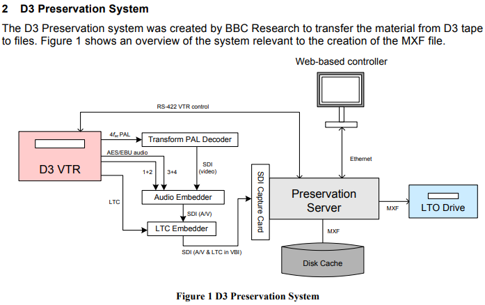

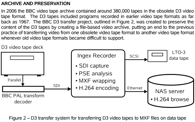

    Originally Posted by 2nd PDF attachment
    Case 3: the bits are available, but a clone is not made: this is the case for the BBC’s D3 preservation project (Ingex Archive, 2009). The problem is that the format is composite PAL, not component. New use of the content, whether for editing or for broadcast, requires a component signal, so the BBC included PAL decoding in the workflow, and saved the result of that decoding, not the direct output from the D3 playback.
    Conclusions for preservation of digital data not in files:
    • Case 3: engineers argue about what to do about colour decoding (going from composite to component). If the particular composite format is obsolete (as with D3) then there is a case for not saving the artefact, and instead decoding to component.
    BBC diagrams from whitepapers 155 & 167. Indeed, they output digital composite 4fsc via Parallel port, which they decode into component using their custom-built hardware.
    [Attachment 50322 - Click to enlarge]
    [Attachment 50323 - Click to enlarge]
    You may have to settle for SDI capture from a suitably-equipped D-5 deck rather than the "absolute best" possible. Unless you want to tinker with figuring out how to capture data from the Parallel port to use with a software comb filter like ld-decode's.
