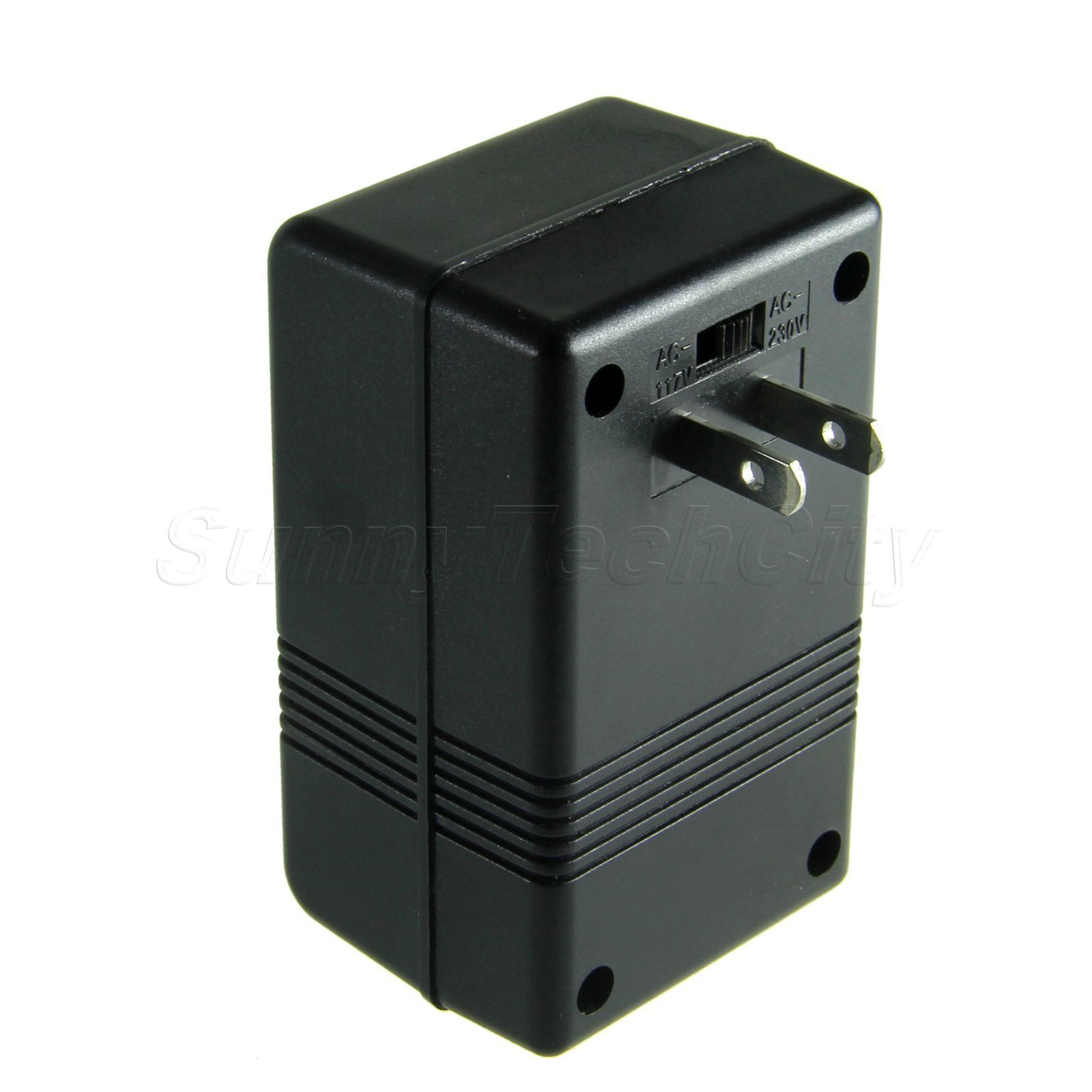

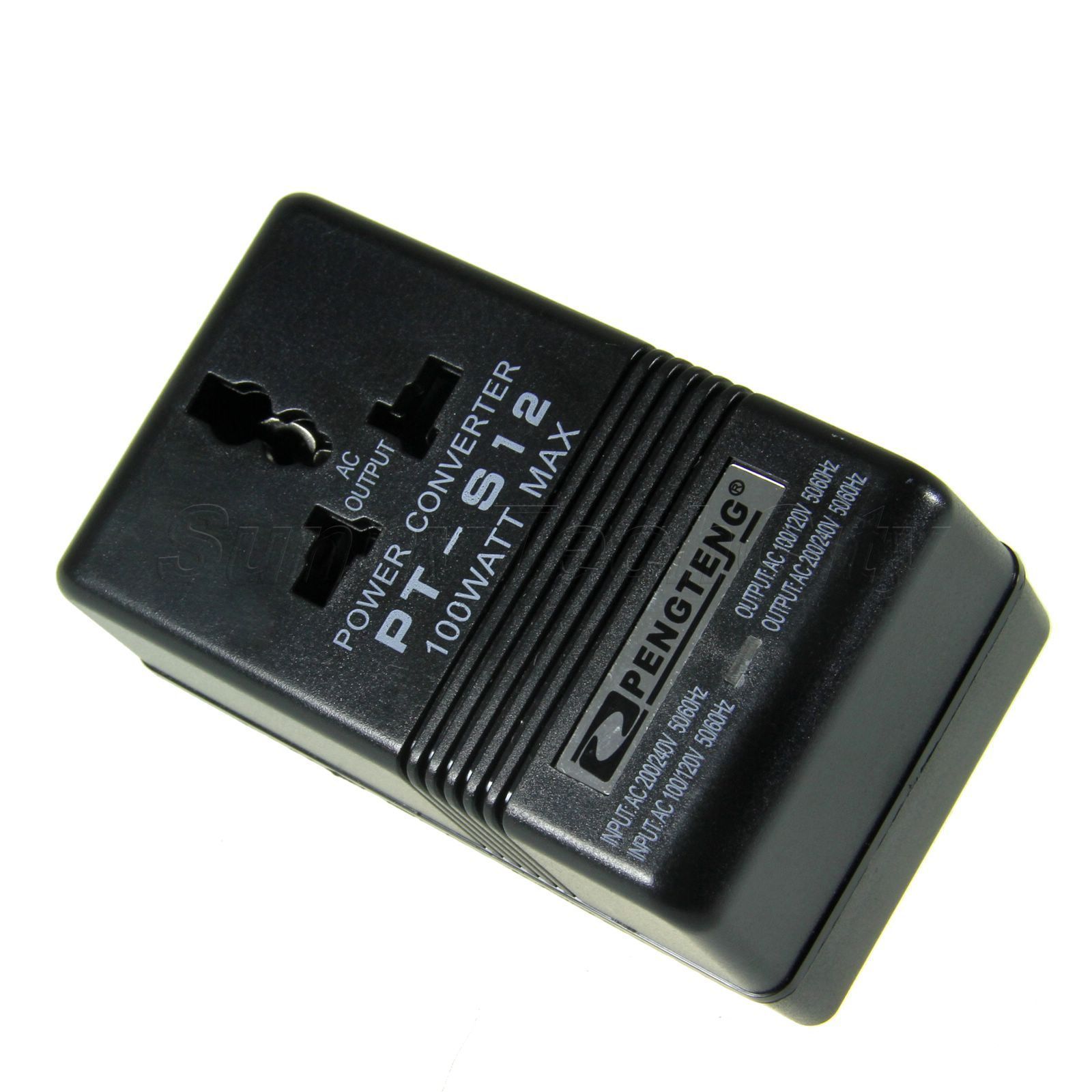

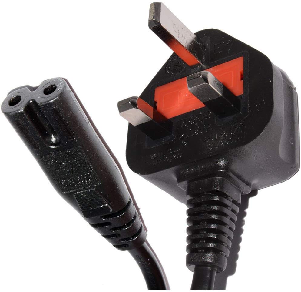

  1. I'm living in the US and my new DVD-R (so I can record my pal tapes) has arrived with no power supply. Since I know electronics require very specific cords and I'm in the US and this is a European device, I have no idea what I'm doing. I already have the adapter, just need a cord.

  3. Would something like this work?

    this is the adapter I have and I have several US AC cords but again, I assume they will not work or will damage the unit.

    The cord and adapter you selected should work, as long as you can go from USA 120 Volt to your UK machine's voltage of 230 Volt.
    Your adapter will need to step up the voltage and could generate a fair amount of heat so keep it in the open and ventilated if possible.

    Bought from Ebay ? Surely the seller has the power cord ?
    Anyway. Look closely at the power socket on the back to see the type of connector ie 2 pin round/3 pin flat and acquire the cable to match.
    https://www.ebay.com/sch/i.html?_from=R40&_trksid=p2047675.m570.l1313.TR1.TRC0.A0.H0.X...+cord&_sacat=0
    The shaver plug is un-fused so I would not get that.

    The one pictured above that I purchased has 5 amp fuse

    I removed the link and replaced it with the one I eventually purchased but yes thank you

  12. Video Restorer lordsmurf's Avatar
    The UK ES10 has a 100-240V power supply.
    All you need is the figure-8 plug. I took the one from my old Playstation 1.
    Step converters add noise. Don't do that.
