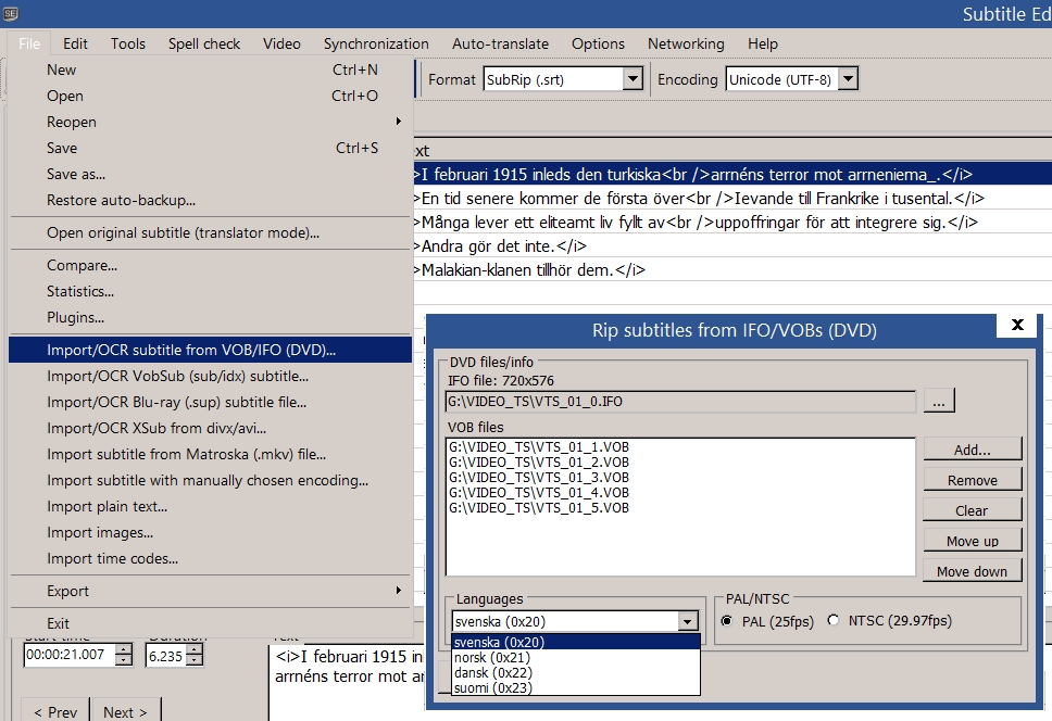

    You use "File -> Import/OCR subtitle from VOB/IFO(DVD) ..." and select the IFO for the movie (In case of more IFO's normally the largest). In the picture below I've mounted an ISO image as G: and selected an IFO. It has subtitles for four languages and I've chosen "Svenska" (Swedish).

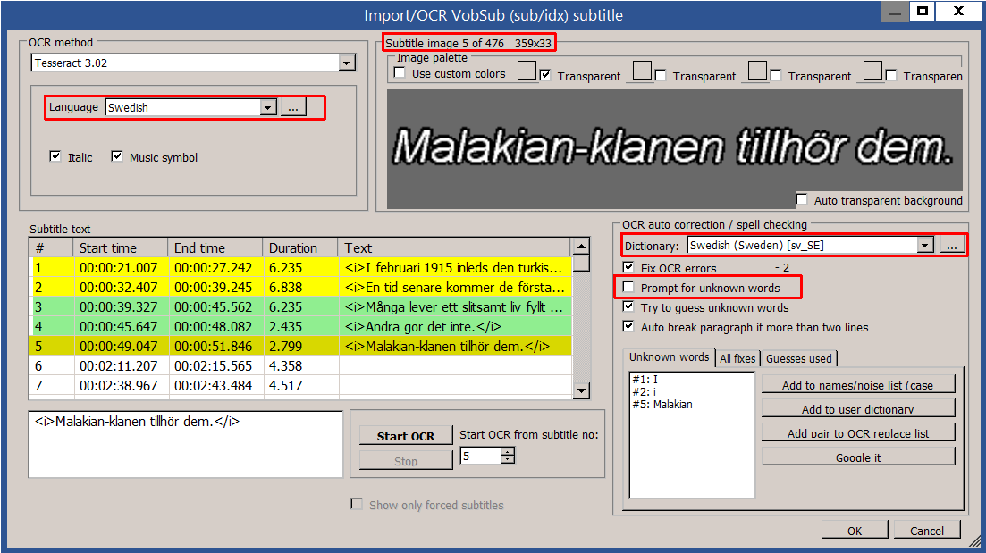

    Then make sure Language/dictionary is Swedish (or download using the three dots) Untic "Prompt for unknown word" and start the OCR. Stop it when a couple of subtitles (here 5) has been done.

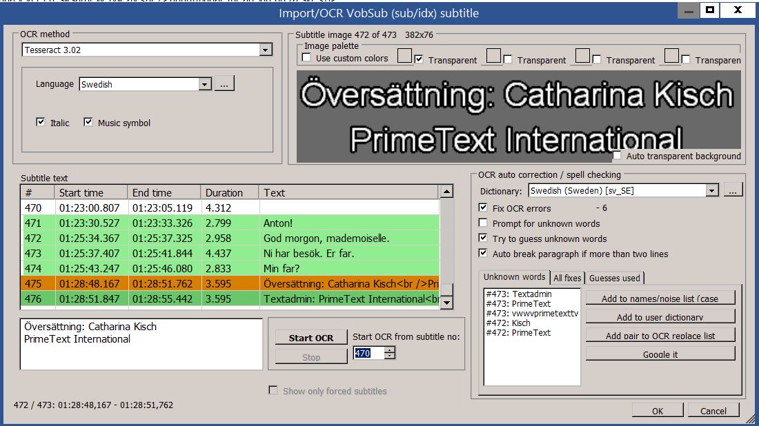

    Do the same near the end of the subtitles. Here OCR is performed starting with subtitle 470 and press OK.

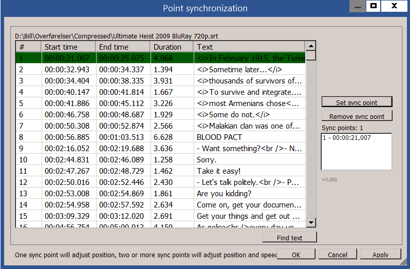

    Now drop the English subtitle on Subtitle Edit and choose "Synchronization -> Point sync". Identify a subtitle where you have the time code from the Swedish subtitles and select "Set sync point" and enter the time code.
    [Attachment 50106 - Click to enlarge]

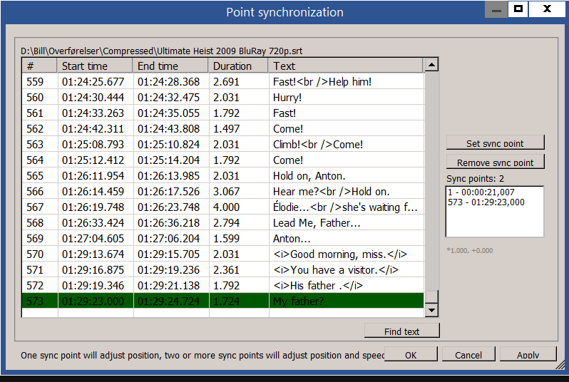

    Do the same for a subtitle near the end so you have 2 sync points and press "Apply" + "OK"
    [Attachment 50107 - Click to enlarge]
    Check the sync at various subtitles.
