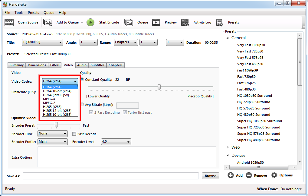

  8. Choice of video compression is on the Video tab. Use the pulldown next to Video Codec:
    [Attachment 50085 - Click to enlarge]
    That was taken on my old 2500K system so the only GPU choice is h.264 Intel QSV.

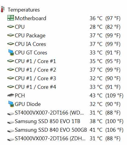

    What I do not understand is why my conversion times are getting larger when the setup has been the same for a long time.
  28. If that true maybe your CPU is getting hotter (dust has accumulated in the CPU cooler, thermal paste is breaking down) and slowing down to prevent overheating. Check CPU temperatures and speeds.
  29. Member
    May 2004
    Brazil
    I will check into that on my next conversion.
    But, as you can seem, my standard CPU temps are in the mid 30s, which I think is quite good.
    That might not be the problem.
Name:	cpu temps.jpg
  30. Idle temps are expedted to be low.
    And generally, when people complain about their encodings taking longer it's because they've started using slower encoder settings, more demanding filters, switched from SD to HD, or are encoding longer videos.
