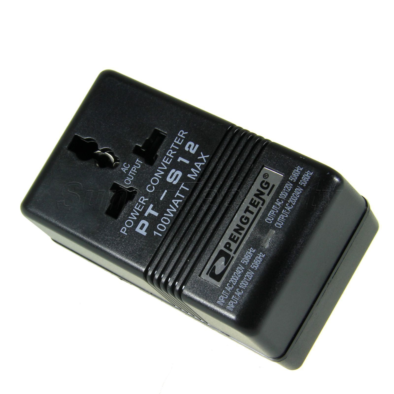

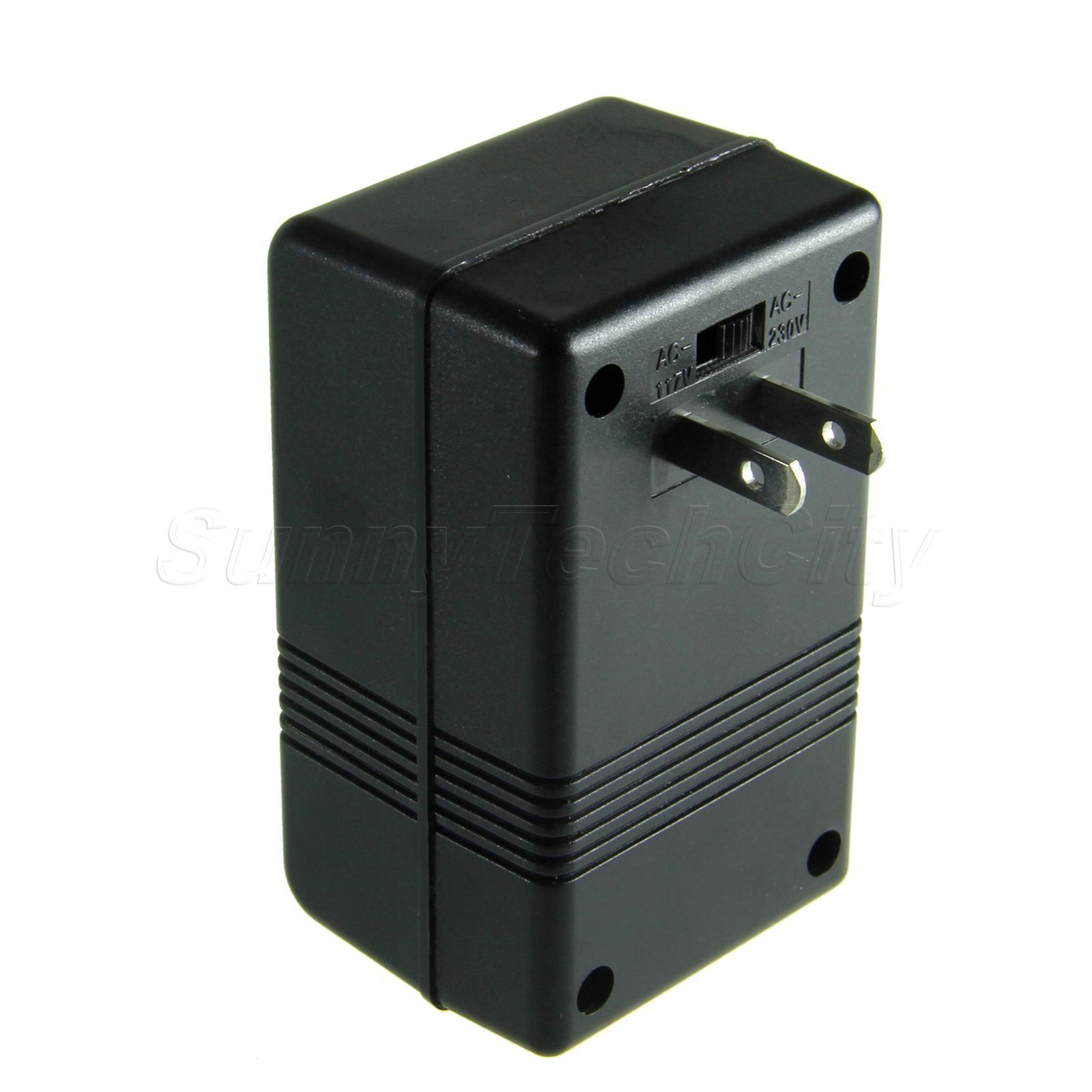

  9. I purchased a Panasonic DMR ES10 from Europe for $50 shipped. Not bad. Also bought an adapter so if everything works, I should be back in business.Image

  10. For PAL stuff you only need to change the plug. That's all that was needed for my two PAL VCRs to work here in the US. But since you already have the power converter...
    Yes, that was a very good price for the ES10.
