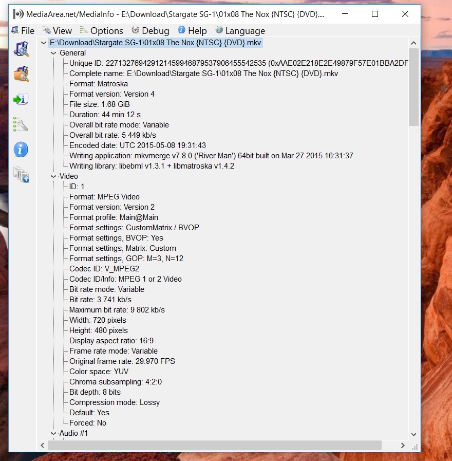

  3. Thanks, but I can't find the information with MediaInfo Although I assume the video isn't flagged as interlaced.
    And I checked, there is that combing effect when I play it with media player classic, but not VLC.
    [Attachment 50039 - Click to enlarge]
  4. If the video was flagged as interlaced it would show up in the Video section:
    Scan type                                : Interlaced
    Scan order                               : Top Field First
    If your player has a setting to force deinterlacing you should try using that. I'm not sure if there's any tool that will let you flag the video without reencoding.

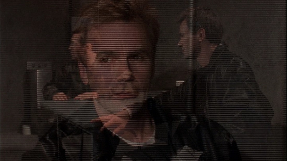

  12. Ok, I think maybe I misjudged the issue There is a slight combing effect, but I think it's an issue with the source. The main issue is that a frame often blends into the next one, and I assumed it was an interlacing issue, but maybe it's not? And I thought setting my player to 1080/i fixed it, but it didn't.
    [Attachment 50042 - Click to enlarge]
    The blending frames is not an issue when I play the files directly on my tv though, or with VLC, why won't it play properly on my player then?

  16. You have MPEG 2 video with a mix of soft and hard pulldown (DgIndex reports 95 percent soft telecine, 5 percent hard telecine). My guess is your BD player just can't handle that properly in an MKV container. I would try remuxing to an MPEG program stream, ie an MPG file. Attached is a sample MPG file for you to test.
    You might still see some combing at times because TVs sometimes take a few frames to adapt to changes between hard and soft pulldown. The video also has a problem where the chroma is messed up at shot changes. So even if your player plays the video with proper deinterlacing there will still be some chroma artifacts (1 or 2 fields/frames) at those shot changes.
