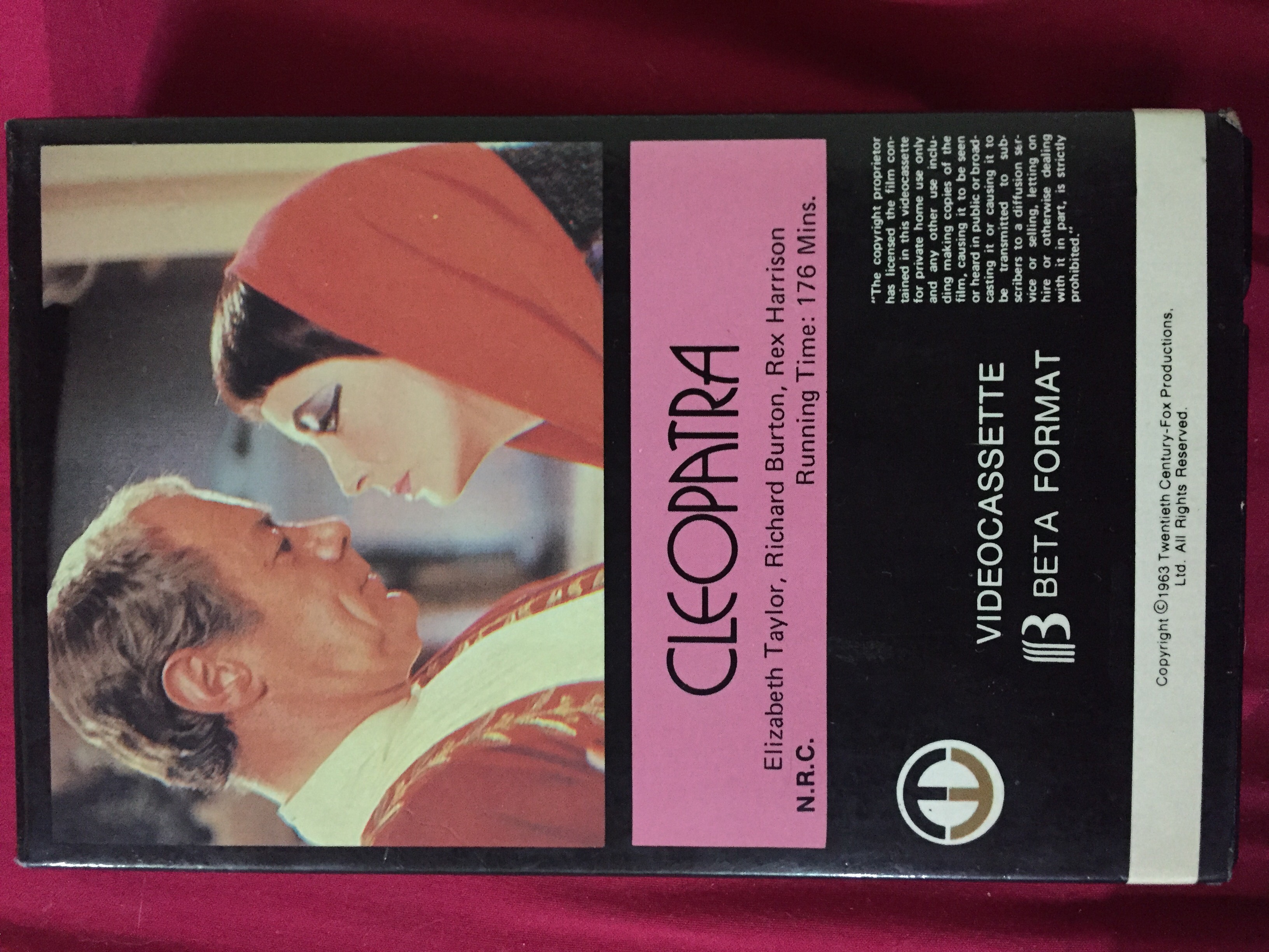

  23. Hello everyone, this is the tape I have, what do you think I should do in order to get it digitized? Honestly, I do trust ebay, if the equipment doesn't work, the company that brings it to me allows for it to be returned. I do not live in the US or UK so I can't sent it there. Do you think that buying a betamax player would be enough to get it digitized? I will ask this to the person I know but would like to know your opinions. Image
    [Attachment 49997 - Click to enlarge]
  24. Member
    Jul 2007
    Interesting. FYI, there's also a 217 min PAL LD version: https://www.lddb.com/laserdisc/32625/1008-35/Cleopatra
    Well, I've given you the resources to get it done. Good luck on your quest!

    lingyi: Though the running time is stated to be 176mins, not 195min.
    DB83: The difference in timings could be due to PAL speed-up ?
    That seems likely, although 195 * (24/25) = 187, not 176.

  29. Originally Posted by lingyi View Post
    Is this it it? http://www.videocollector.co.uk/cleopatra/29651. Though the running time is stated to be 176mins, not 195min.
    Have you actually seen the image quality of it? It's very likely cropped and the video quality fair at best being videotape. Plus the audio quality will be poor mono since this was before stereo and Beta Hi-Fi. I highly suggest viewing a snippet of it before putting any more time or money into the project.
    Edit: If it's a Magnetic Home Video release, the quality of their releases were fair to good at best, even by videotape standards. No remastering, minimal to no cleanup of the original. However, they did release some videos that weren't available from anyone else.
    In case my tape is damaged, could I buy another from that website? haven't registered yet.
