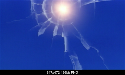

  21. I was wrong about being able to fix it using an override file. It's not that choosing the other of the duplicate frames will fix it. It's in unique frames, apparently caused by SRestore. It's also in another filter I sometimes use for the same thing, Exblend. About the only way to fix that sort of thing is with frame interpolation, especially since it only occurs sometimes. And frame interpolation can be hit or miss. When it works it works spectacularly, but when it misses, you can get all kinds of nasty artifacts. The script used for the included video is this:
    SRestore(omode="pp3")
    Tdecimate(Mode=1)
    FixBadFrames("218 222 226 230 234 238 242 246 250 254")
    This is FixBadFrames.avs:
    function FixBadFrames(clip c, string frames) {
    # Replace each frame from a list of 'bad' frames by using MFlowInter to interpolate
    # between the nearest pair of 'good' frames
    c
    sup = MSuper()
    bv = MAnalyse(sup, isb=true, delta=2)
    fv = MAnalyse(sup, isb=false, delta=2)
    candidates = MFlowInter(sup, bv, fv, time=50.0, ml=100).DuplicateFrame(0)
    ReplaceFramesSimple(candidates, mappings=frames)
    It needs MVTools2 and RemapFrames to make it work. During that stretch beginning at about the 9 second mark, you get this white crap every four frames. And then it stops. So, you'll have to go through the whole thing to find where it occurs. Who knows, maybe this is the only time in the whole video where you get that.

    It needs MVTools2 to make it work. During that stretch beginning at about the 9 second mark, you get this white crap every four frames. And then it stops. So, you'll have to go through the whole thing to find where it occurs. Who knows, maybe this is the only time in the whole video where you get that.
    I see what you mean haha
Name:	frame interp lol.png
    So it wont do good for some frames. Which is fine, making the number of bad frames smaller will be nice. If I have to go into photoshop and fix a few hundred frames I dont mind. Is there any other automated method that would work or is frame interp my only option?
  23. Oh, you're willing to work in Photoshop, eh? I'm working on something and just fixed a frame in a photo editor myself. It couldn't be interpolated because the movement was too fast.
    Right, the picture shows what can happen. Movement too fast, one object moving behind another, too much difference in brightness and/or contrast between in the two frames on either side of the artifacted one, all kinds of stuff. The frames I used it on in the sample came out nicely.
    If only a part of a frame needs interpolating, that can be done and maybe spare the parts that are moving quickly. You can create a mask so the filtering is done only on the part you want, leaving the rest alone. You can use FreezeFrame (useful with animations) to make a frame look identical to the one before or after. But sometimes there's nothing to do but dig into your favorite photo editor and then replace the broken frame with the fixed one.
    The interpolator I showed you will only fix a single frame and it's useless to include adjoining frames. For fixing multiple frames in a row, look for ReplaceFramesMC here on Videohelp.com.
