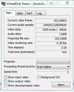

  3. I guess there's shouldn't be the matter of my settings as if I run the First and than the Second Pass manually and independently (without the Job Queue) it starts and finishes both Passes just right. The bug only appears if I try to do EXACTLY the same with the Job Queue. I tried it again and the progress of the first pass was very-very slow as seen:
    Only 0.25fps/s advance, while running manually I can get even 25-30fps/s. So there's something definitely messed up here with the Job Control.

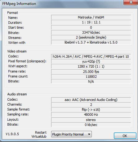

    Don't know exactly what you mean by input driver? I have the latest Xvid-1.3.5-20171208 Release installed. And Virtual Dub 1.10.4-AMD64 release (and it's the Portable version).
  6. VirtualDub has different input options. From your screenshot it seems you are using the ffmpeg input plugin.

  7. Cranking Process Priority up to Even Higher will not reduce the time it takes to encode unless you have some other CPU hungry processes competing for CPU time. And high priorities can lead to problems as the user process competes for CPU time with the OS. User processes should almost never run at more than Normal priority. I usually run encoding at Idle priority. That runs just as fast as any higher priority if there is no other CPU hungry process running, and it leaves the computer usable for other things if needed (of course, the encoding will be slowed if you do so).
  8. That's just one shot taken to show that it runs sluggishly slow even set on higher priority. It's the same happening on Normal or any other priority. I have done the manual -non queued- encodes on Normal and also on Even Higher priorities with success and without errors, so that must not be the cause.

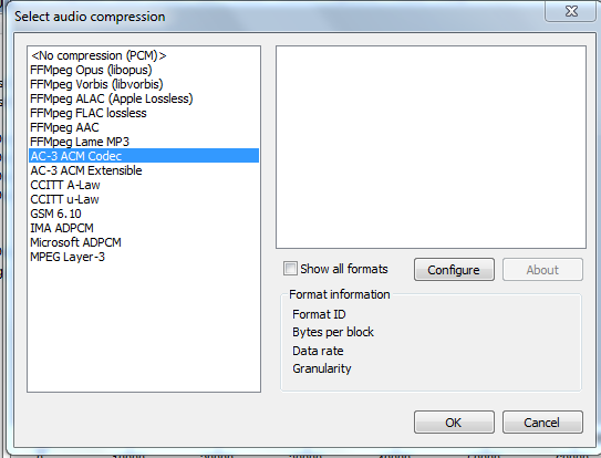

  11. A wanted to try VirtualDub2, but the AC3 ACM encoder juts isn't working. It doesn't even set the parameters I've adjusted, so every time I reopen Audio->Compression it's back to the default "empty" stage.
    [Attachment 49970 - Click to enlarge]

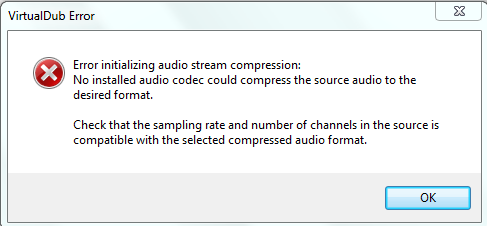

    When I try to Save the Video it shows the following pop-up:
    [Attachment 49969 - Click to enlarge]

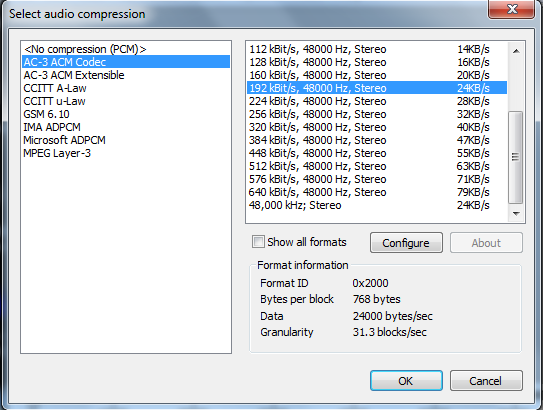

    These are my working settings with the "original" VirtualDub after having these codecs installed:
    [Attachment 49971 - Click to enlarge]

  12. Convert the audio to 16 bit PCM.
  13. Originally Posted by jagabo View Post
    Why? My intention is to convert to AC3.
  14. The AC3 encoder requires 16 bit PCM as input.
  15. What you mean by that conversion method to run through? I don't need any other conversion in the original VirtualDub and the setting to convert to AC3 works straight for all audio streams. So why doesn't work in VD2? So how to done this properly, first convert and save a PCM stream in a different file?
  16. The source filter in VirtualDub2 is decompressing the audio as floating point. The AC3 encoder needs 16 bit integers. Turn on Audio -> Full Processing Mode. Then use Audio -> Conversion to convert the audio to 16 bit integers. Then select the AC3 encoder for compression.
  17. Originally Posted by jagabo View Post
    Thanks, that seems working now!

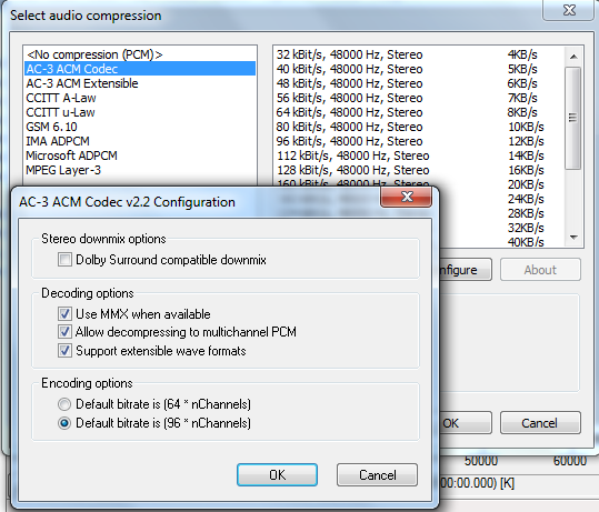

    I only wonder about these missing setting in the AC3 Codec Configuration Settings that I have in the original VD, but not in VD2...?! Why are these missing?:
    [Attachment 49972 - Click to enlarge]
