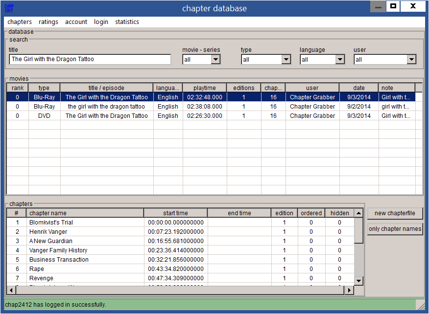

Maybe not what you want but if it's at chapter points start by using Chapter Database.
[Attachment 49931 - Click to enlarge] -
