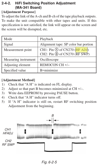

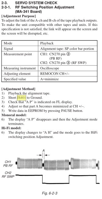

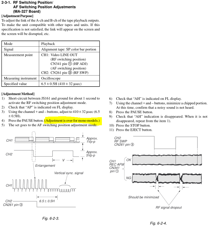

    Latest experimentation. These Sony models feature an easy adjustment for head-switching point, and vhs-decode is extremely tolerant of the head-switch being crammed into VBI instead of its normal placement within the frame where it skews the bottom of the image.
    Unfortunately the Hi-Fi audio is affected. I just haven't played around with this enough to try fixing it. After adjusting video head-switching, the VCR automatically switches to the adjustment for Hi-Fi audio head-switching. Ideally, an oscilloscope would be used (which I don't have).
    Quick proof-of-concept test with camcorder tape; no audio
    Beast Wars tape 1, with audio. Can't be bothered to fix the audio desync since I'm only demoing the look & sound, not AV sync.
    The labelling of the jumper wire that you need to short to ground varies from model to model, but so far seems to be in the same position on the board for all of the Sony's we are using.
    SLV-778HF
    SLV-779HF

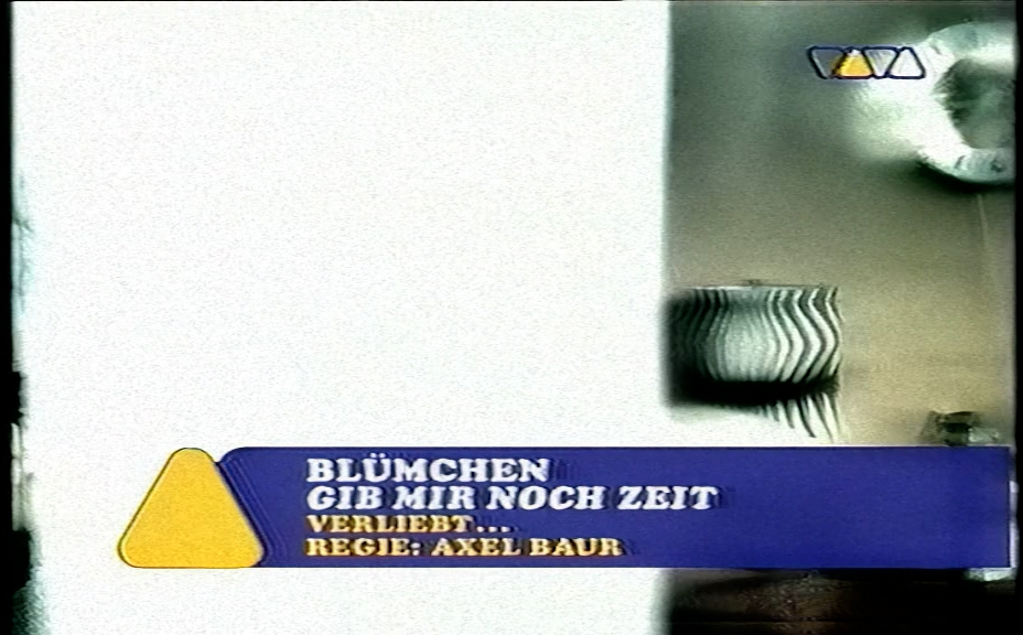

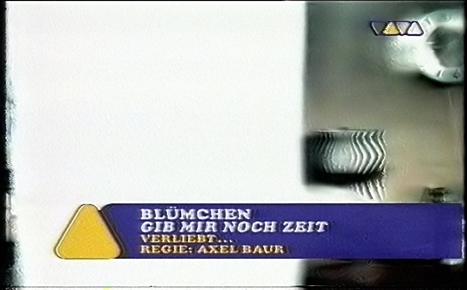

    The text much better on CVBS-decode method with this LP recording.
    I don't know what can I adjust with vhs-decode to improve the image quality.
    I prefer the vhs-decode and wait for future updates
    CVBS-decode:
    [Attachment 64503 - Click to enlarge]
    vhs-decode:
    [Attachment 64504 - Click to enlarge]

    This is the captured raw data for previous post:
    Decode command: vhs-decode -p -t1 --10cxadc3 -cafc viva_strap_test.vhs strap_test

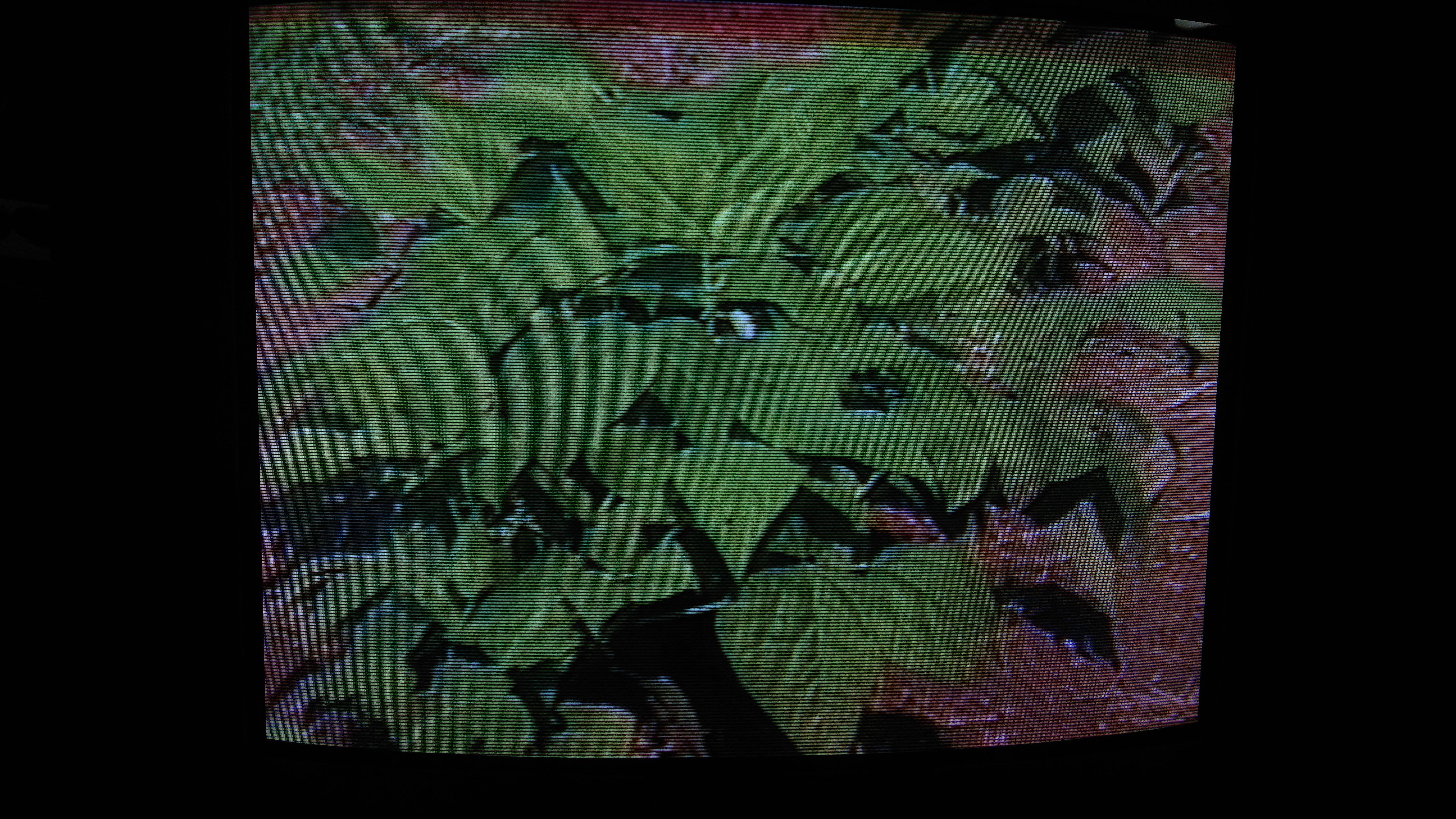

  24. I connected my PC to my PVM monitor and played back some of my samples. Even with using composite, the picture quality really does stand out compared to any normal VCR. I'm using a GBS-8100 scalar board connected to my PC with resolution set to 640x480 60Hz. I had to turn off the flicker filter on the scalar board to prevent blurring the scanlines together. Then I simply used VLC to load a file that has been cropped vertically to 480 pixels with resize fit to window turned off. This way the scanlines of the video line up perfectly with the interlaced field scanning of the monitor, both in full screen and window mode.
    Nothing beats that true CRT smoothness. It looks like I'm playing the tape back on a really high-end S-VHS machine, maybe even U-Matic. Here's a couple slow motion videos from my phone demonstrating proper CRT scanning. One of them shows the video paused between two fields of a scene transition. This single frame contains a field from one scene and a field from another scanning repeatedly.

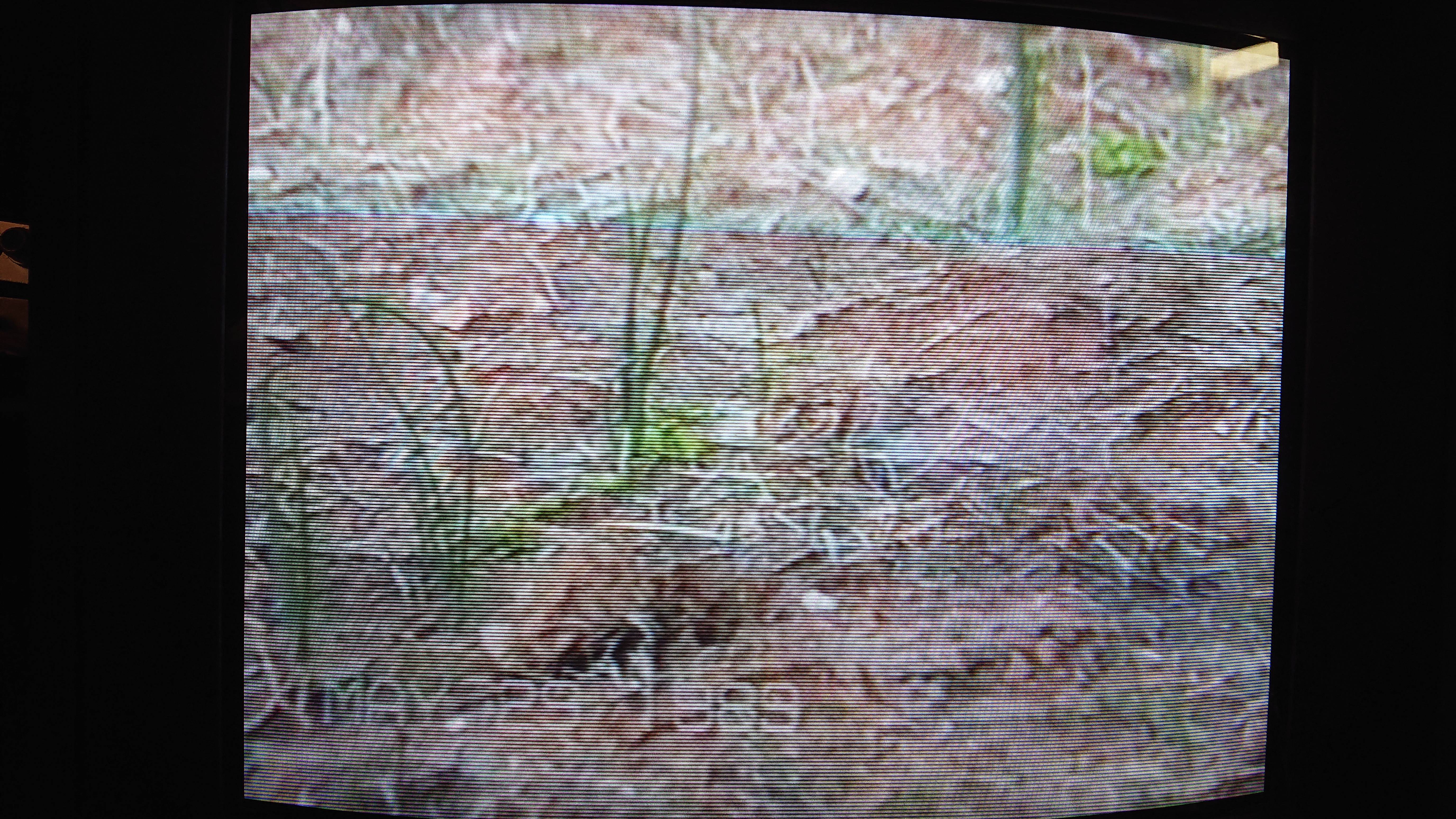

  25. I'm giving VLC the stink eye right now. It has a well known design flaw, bug, whatever you want to call it. After about 15 seconds of playback it starts dropping frames. Completely kills the fluid CRT effect. I'm sure I can find the cause and if I do I will share the solution, for anyone wanting to try what I've explained above.
  26. The cause of the stuttering wasn't VLC, it was actually Windows. I tried both with Nvidia drivers and with the onboard graphics using Intel drivers. Same exact phenomenon with VLC and Media Player Classic, regardless of settings in both programs. I tried everything but something about the NT kernel, maybe thread scheduling, is screwing it up.
    I then tried this with my trusty Linux Mint laptop. Here's a tip, if you're using X as your window server you can install ARandR to easily manage your xrandr screen modes and resolutions. I used this to set my VGA output to 640x480 60Hz. The Linux kernel and Noveau drivers with Intel HD graphics handle this beautifully. No stuttering at all and VLC just keeps going like I'm actually playing a real tape, but far better. Fantastic!
    Getting photos of CRTs is really tricky. This looks much better in person.

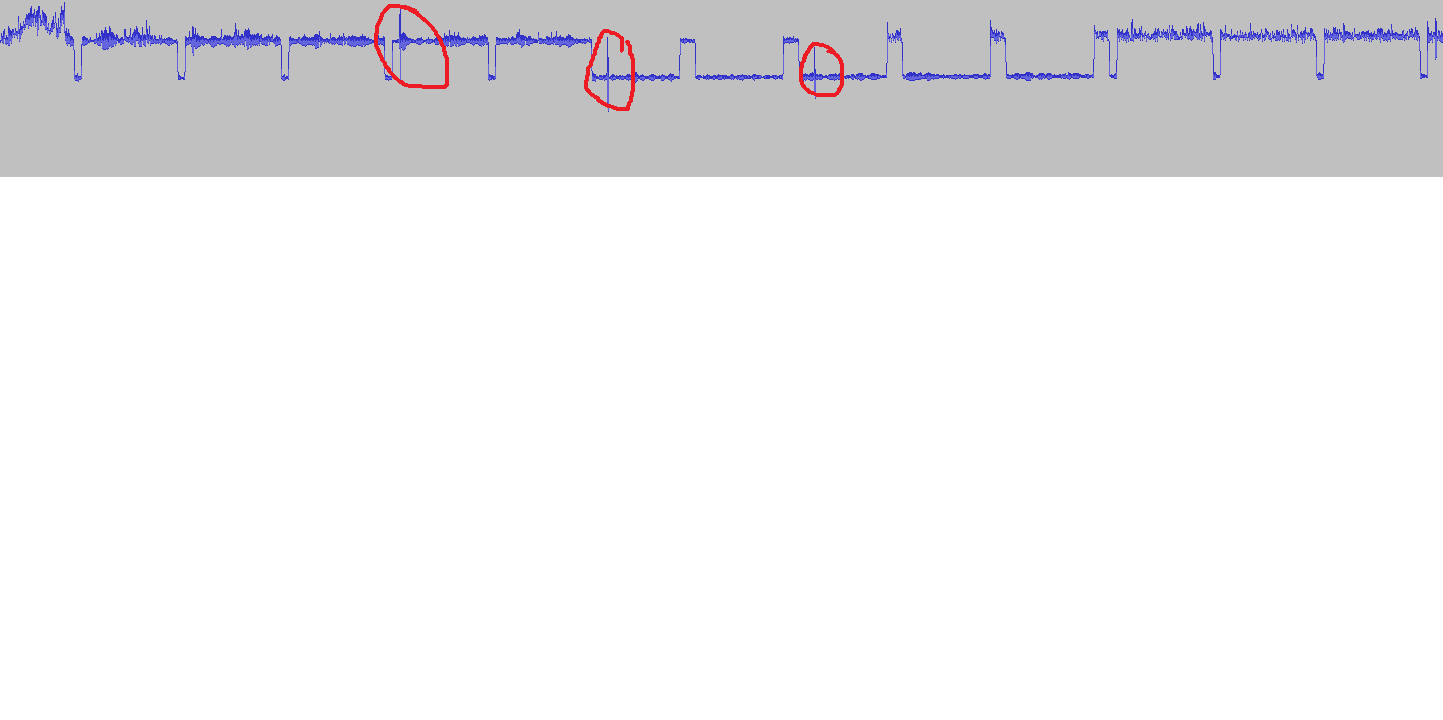

    I think this is the problem with the sample that I posted earlier for cvbs-decode.
    [Attachment 64827 - Click to enlarge]
    Maybe some filter can help to remove this. What do You think?

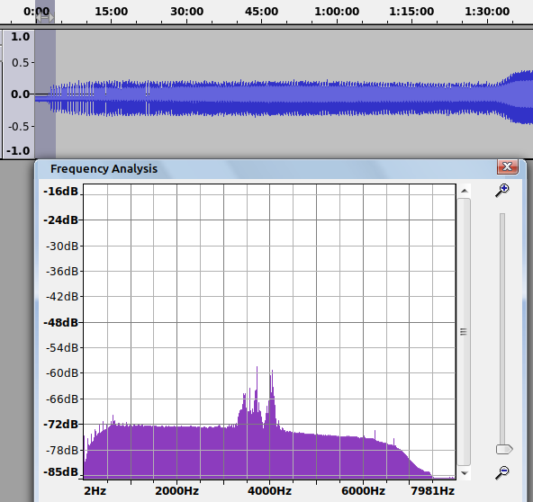

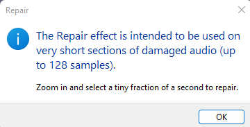

  28. Audacity has filter called "repair". Up to 128 samples it can smooth out "pops" and "clicks" in the waveform domain.

  29. Member
    Sep 2016
    Hungary
    [Attachment 64828 - Click to enlarge]
    Cannot remove from the entire waveform
