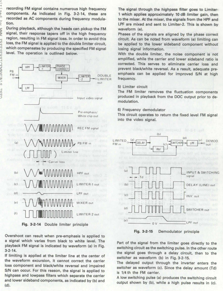

    If you are talking about these black streaks:
    [Attachment 61538 - Click to enlarge]
    They are called "fish" or "comets" and are an artifact of analog satellite TV reception. They tend to occur in areas of high color saturation and on sharp transitions. Not so much in flat, pale areas. Especially when the weather was bad, this was a common sight in the 90's and early 2000's in Europe.
    Since they are "baked in" into the VHS recording, they cannot be fixed by ld-decode. However I used to have reasonably good success masking them with an old AviSynth plugin called "DePulse".

    It could be contributing to black/white fishes/streaks, though it's possible it's baked in from happening during playback or recording too since it looks like it's been dubbed at least once judging by the head switch and excessive sharpening.
    May have noted this earlier but the fishes/streaks that can occur during decoding (whether in vhs-decode or in a VCR) happen when the demodulator "misdetects" or "misses" the frequency at that point in the signal due to noise, weak signal amplitude or other things, and the filtering of the rf signal prior to that will have some impact on it.
    This from illustration from a JVC techical guide may help illustrate it a bit, though the demodulation in vhs-decode works a bit different at the moment:
    [Attachment 62204 - Click to enlarge]
    That's why the default cutoff is a bit high at the moment as a trade-off (even though it being lower would work better on most tapes) between causing streaks and detail, though ideally we would find some way of improving the demodulation a bit and/or design more optimal filters.
