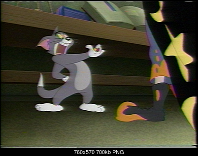

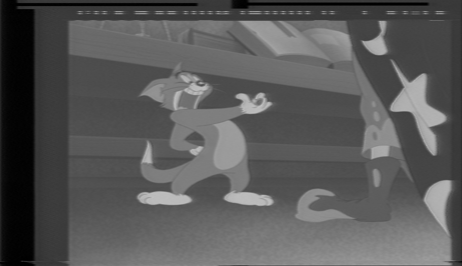

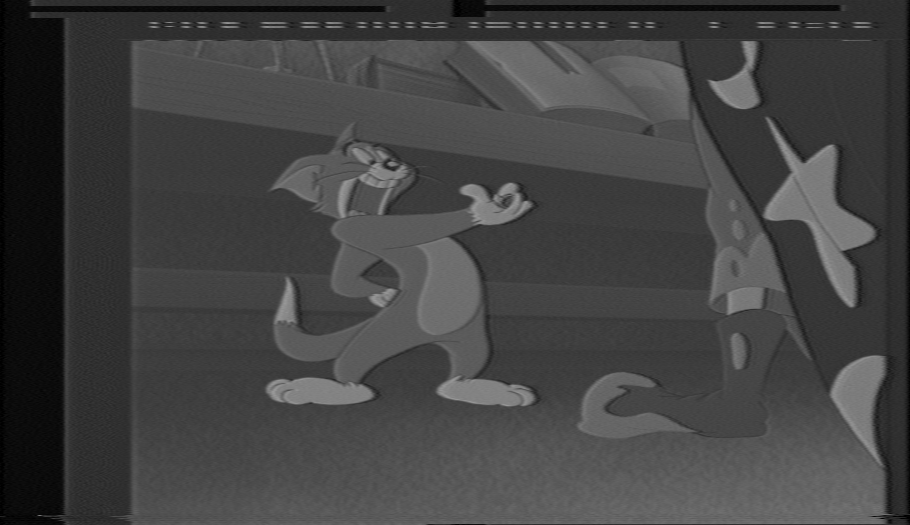

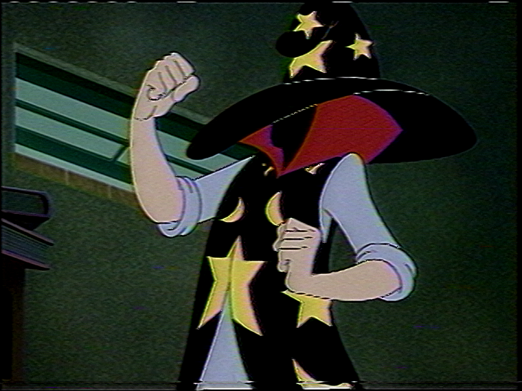

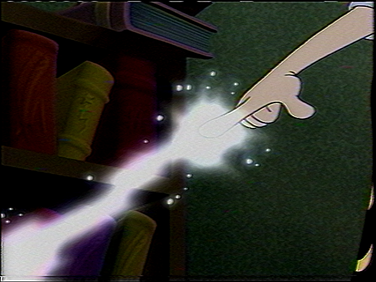

  5. Great, that worked. Thank you. Just made a new folder and extracted the zip file of the latest repo changes. The project is moving so fast I'll need to do this weekly now. I added the 13MHz low pass filter back into the mix and that really cleaned up the luma. Before there was smearing, now that's completely gone. I'm back down to 40dB with T&J, but the result is much better now. My final step is to get rid of this long 75 ohm RCA cable and use a proper 1 foot 50 ohm RG316 BNC cable with the VCR on top of my capture PC. Hopefully that will get rid of the ~600Hz chroma pulsing signal I still have. Also need to AC couple the line with another 0.1uf capacitor, as I think I have a very slight ground loop causing scrolling hum bars.

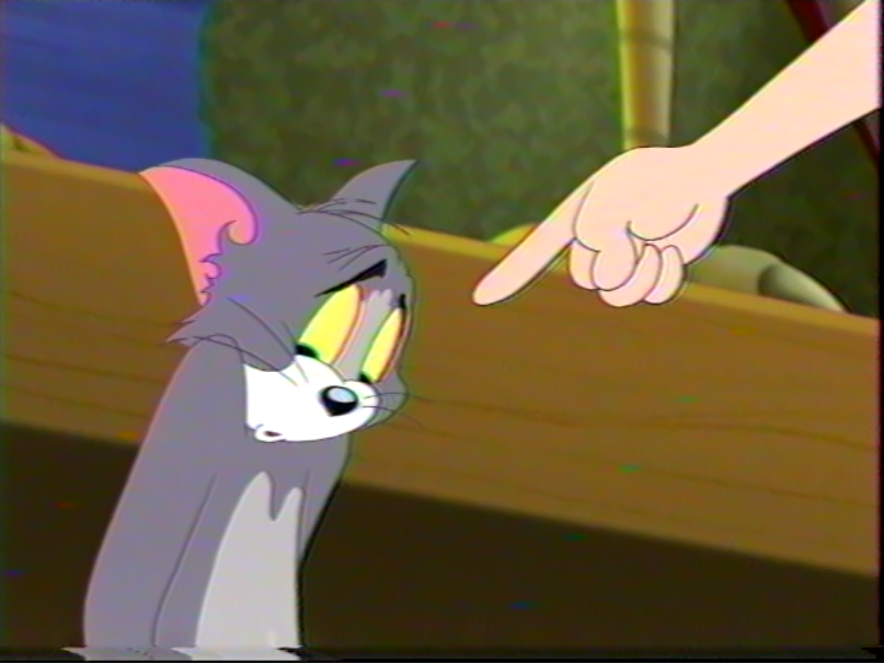

    No filter:
    With filter:

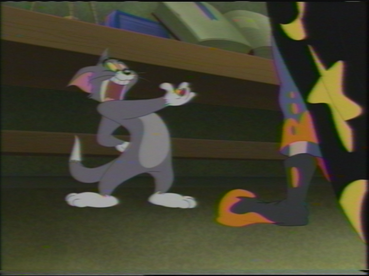

    Also discovered this filtered sample managed to cause a warning (exception?) in vhs-decode, which caused a second of the video to be lost. Sample is attached if anyone wants to troubleshoot. Leave the extension as .zip this time.
    File Frame 343: CAV Frame #None Unknown
    Field phaseID sequence mismatch (4->3) (player may be paused)
    File Frame 344: CAV Frame #None Unknown
    Raw data loc didn't advance.
    File Frame 345: CAV Frame #None Unknown
    Field phaseID sequence mismatch (2->1) (player may be paused)
    /usr/lib/python3/dist-packages/numpy/core/fromnumeric.py:3256: RuntimeWarning: Mean of empty slice.
      return _methods._mean(a, axis=axis, dtype=dtype,
    /usr/lib/python3/dist-packages/numpy/core/_methods.py:161: RuntimeWarning: invalid value encountered in double_scalars
      ret = ret.dtype.type(ret / rcount)
    Unable to find any sync pulses, jumping one second
    Possibly skipped track, re-checking phase..
    File Frame 377: CAV Frame #None Unknown
    File Frame 379: CAV Frame #None Unknown
    File Frame 381: CAV Frame #None Unknown

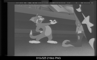

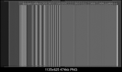

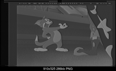

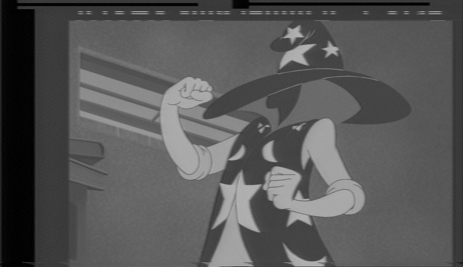

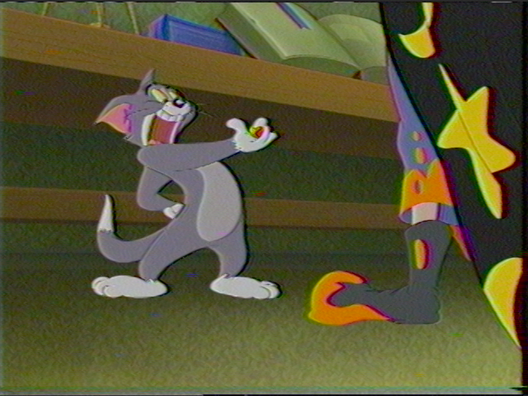

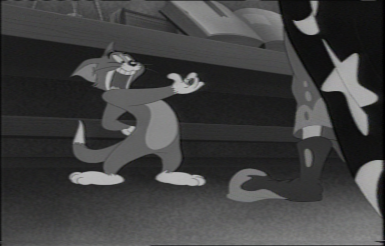

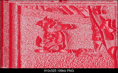

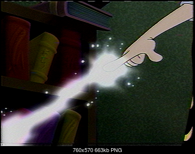

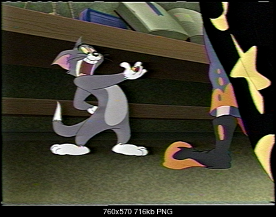

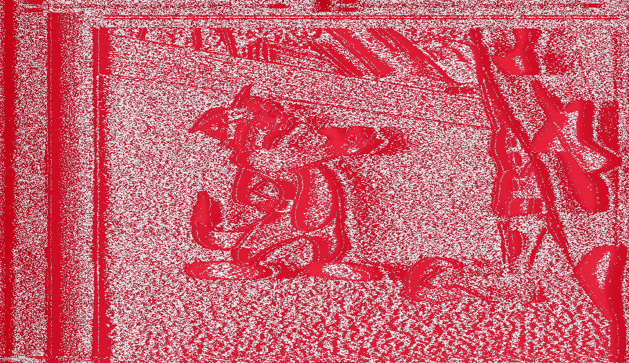

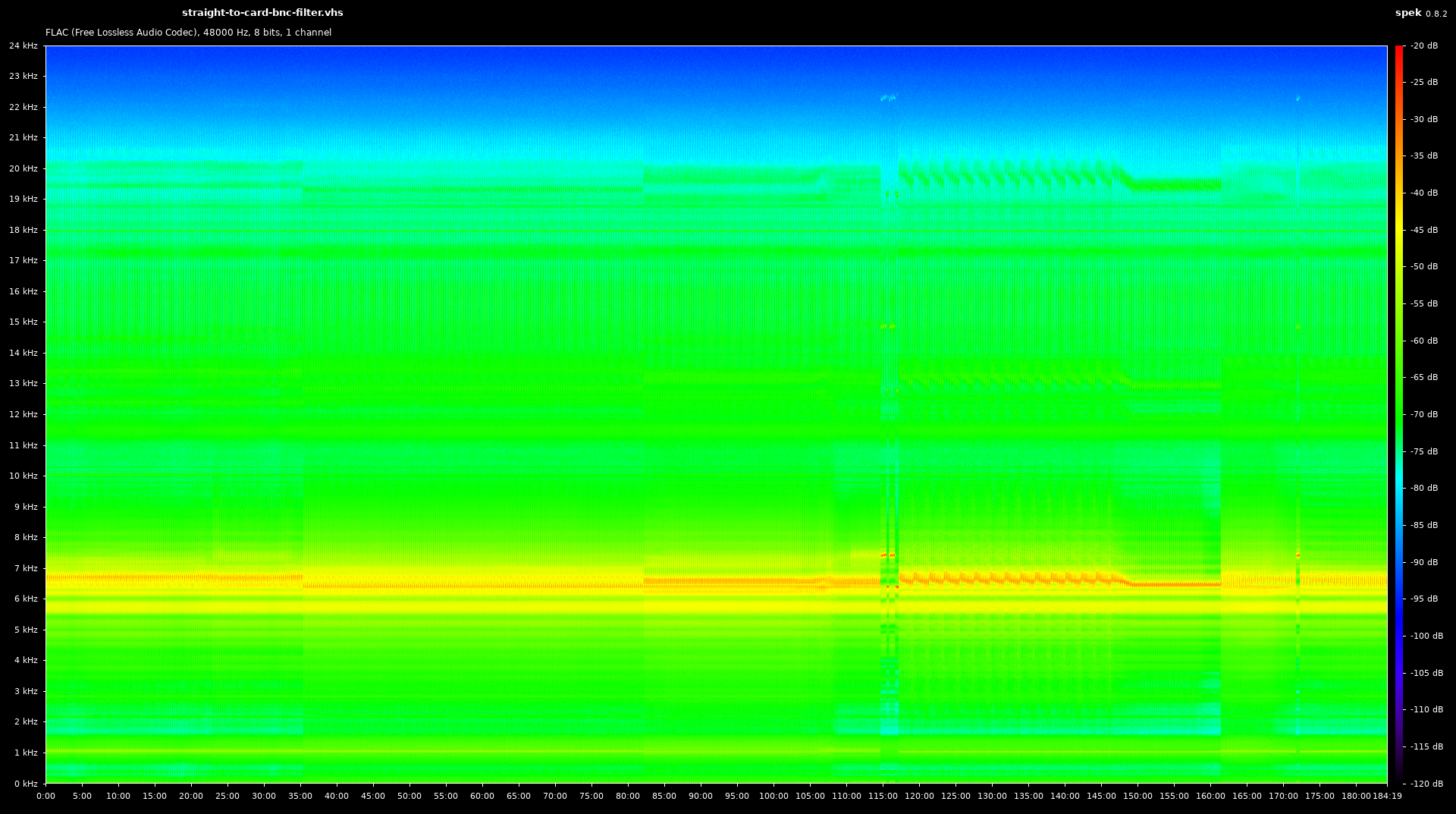

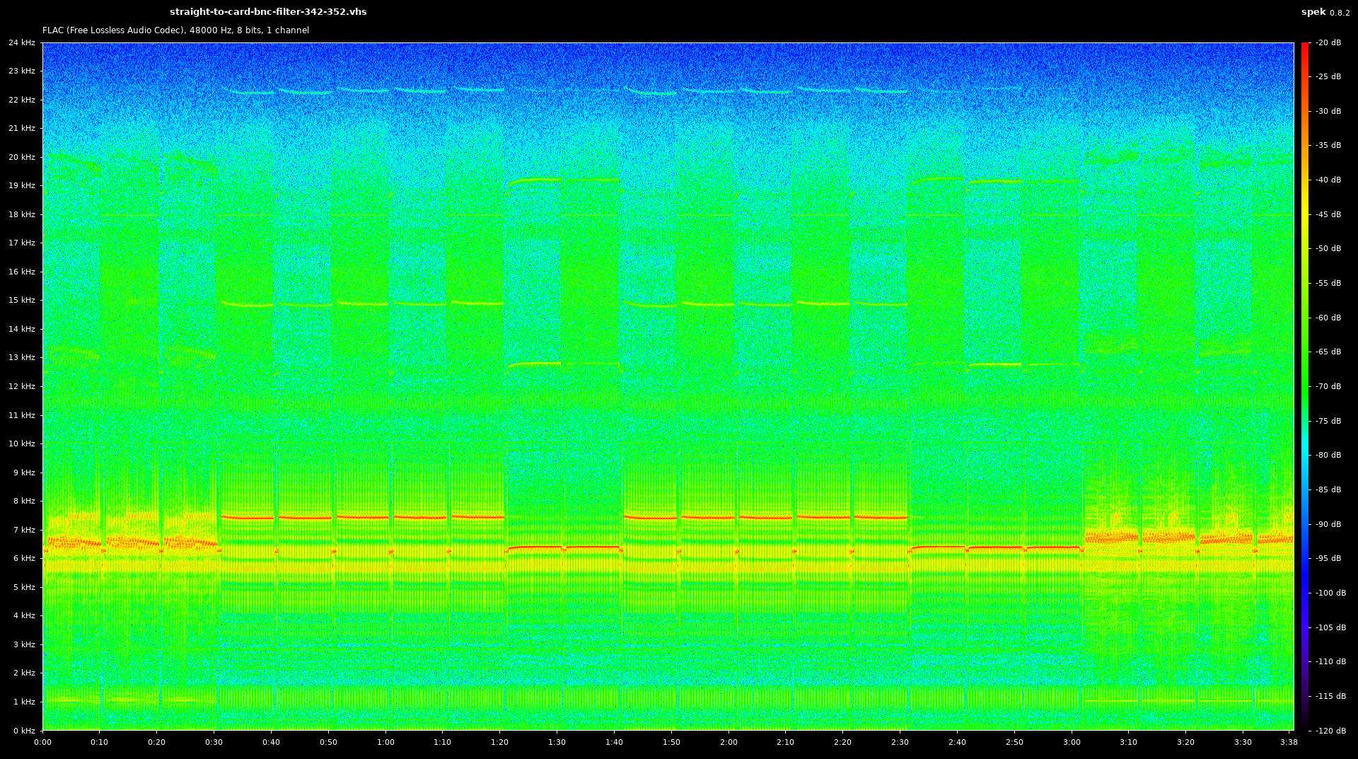

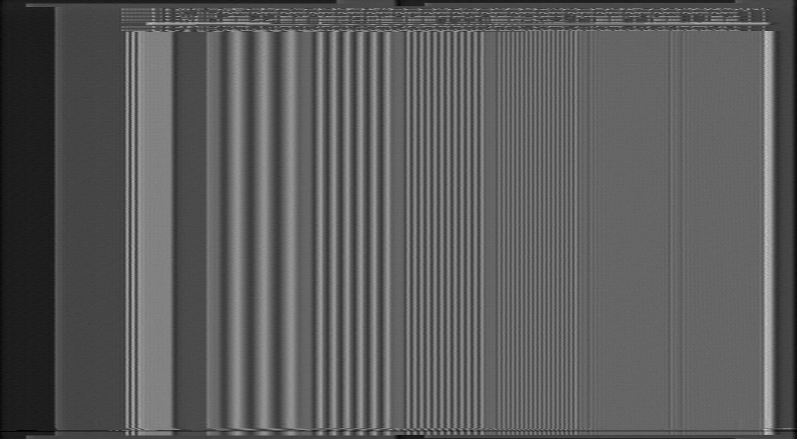

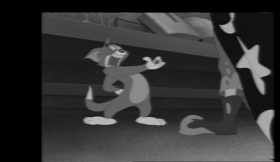

  6. Here's quick analysis of the clip:
    [Attachment 57586 - Click to enlarge]
    After extracting this problematic fragment with Vooya player:
    [Attachment 57588 - Click to enlarge]
    Here are happening instant brightness changes "flashes", possibly sync detection does not like it. Here frames 0-3 are decoding fine, on first field of frame 4 decoding breaks.
    By the way this is the best compression method for raw video, two commands for packing and unpacking with barebone FLAC codec. These apply for 8-bit and 10-bit CXADC captures, remember to set --bps=8 or --bps=16 respectively. This forum supports .flac extension files and the decoder also.
    Encoding:
    flac --best --sample-rate=48000 --sign=unsigned --channels=1 --endian=little --bps=16 -f test.r16 -o test.vhs
    Decoding:
    flac -d --force-raw-format --sign=unsigned --endian=little -f test.vhs -o test.r16
    Thanks to it I reduced size of your 17-second long, 531MB Tom&Jerry sample to 280MB instead of 384MB in .zip plus no unpacking is necessary.

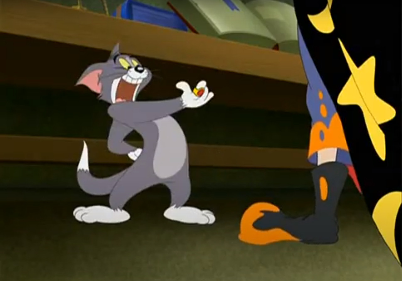

  9. Yeah that flash is when Tom gets struck by the wizard. That decoded fine without using the filter before, which is strange.

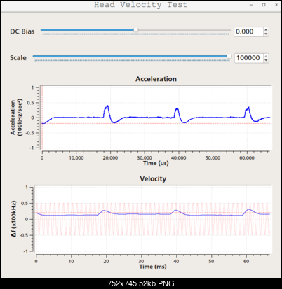

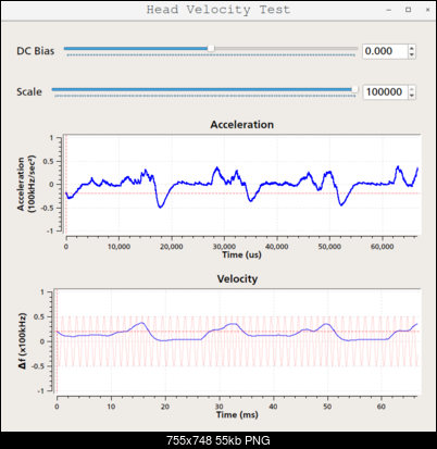

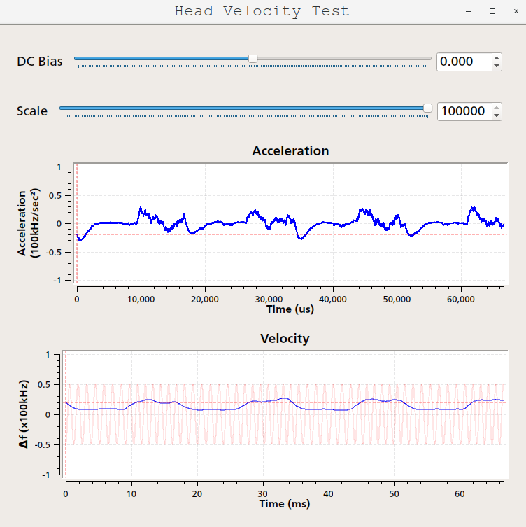

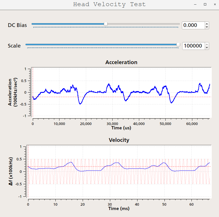

    These are the head speed measurement results.
    They were made on colorbars pattern and piped thru GNURadio for producing the graphs and the sound files
    The NTSC VHS sample is the one mentioned here before, and I think the PAL sample comes from here as well.
    In the left channel you will hear a signal analog to the relative speed of the drum, It can be noticed it is around 60Hz for NTSC and 50Hz for PAL (this is mainly due to the head switch point). The right channel has a VCO driven with that to aid hearing that low frequency variations.

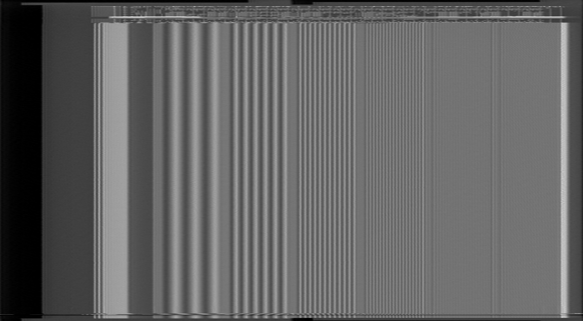

    NTSC VHS:
Name:	Head velocity test - VHS.png
    head_speed_NTSC_VHS.flac
    PAL VHS:
Name:	Head velocity test - PAL VHS - multiburst.png
    head_speed_PAL_VHS.flac
    NTSC UMATIC:
Name:	Head velocity test - UMATIC.png
    head_speed_NTSC_UMATIC.flac
    That measure will be used as the distance metric on the DTW
    The goal will be to compensate the speed in a way these measures will result in an (almost) flat line.
    Maybe the physical magnitudes typed on the Y axis of the graphs are not accurate, for the moment ignore these.
    The time axis is right.

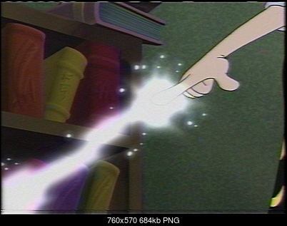

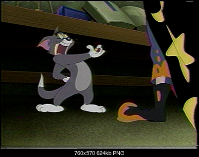

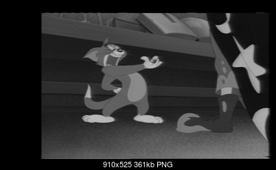

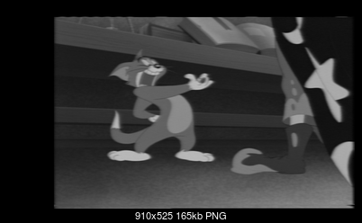

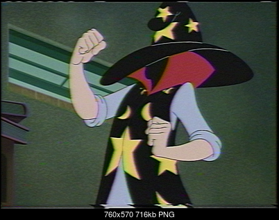

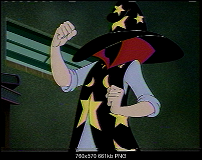

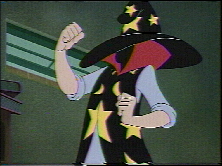

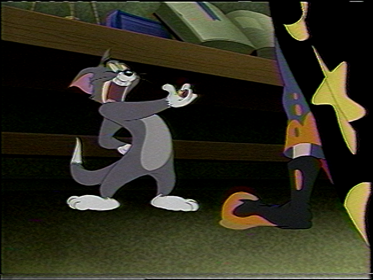

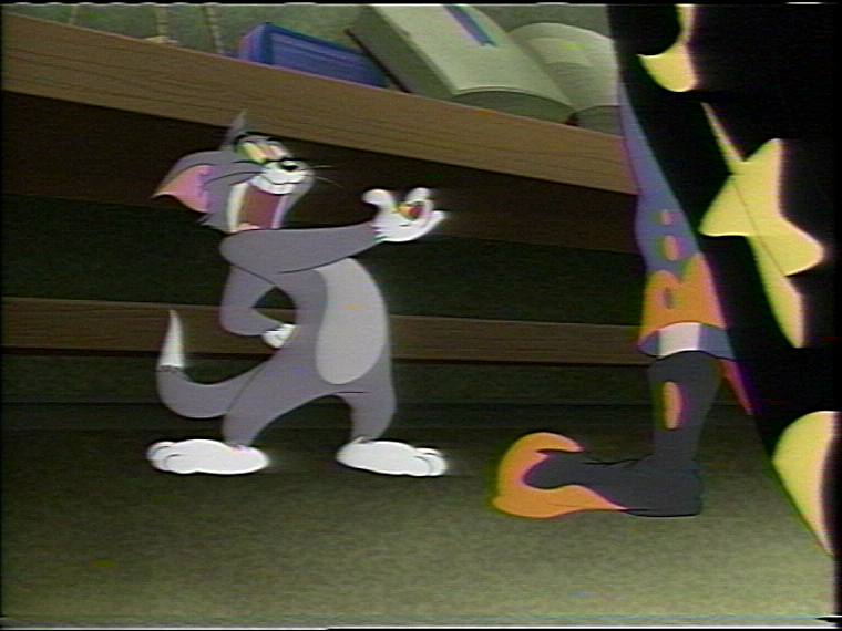

  13. Sweet updates. Can you share a before and after screenshot with the new deemphasis code using this sample I have in this post? It's the cleanest NTSC capture I have yet. My luma decodes still have a bit of noise, which I thought was just the tape. If there's a way to reduce that noise without losing sharpness/bandwidth, that sounds awesome.
    https://forum.videohelp.com/attachments/57585-1614649416/straight-to-card-bnc-filter.zip
  14. Sure
    Before -> After (same post-processing pipeline)
    --noAGC parameter
ID:	57614Click image for larger version
ID:	57616Click image for larger version
ID:	57618Click image for larger version

  15. That looks good as far as better dynamic range in the blacks and less noise. However, it looks softer than before and there is a slight horizontal smearing effect now. Are there any adjustments that can improve that?
  16. You can change the 'deemph_tau' parameter in vhsdecode/formats.py for controlling the knee point of the deemphasis filter and to get different sharpening levels.
    It is specified in RC time constant (tau) as it is found in the literature / standards.
    Particularly this line:
    #Video Y FM de-emphasis (1.25~1.35µs)
    RFParams_NTSC_VHS["deemph_tau"] = 1.30e-6
    The effective corner frequency is:
    Fc = 1 / (2 * pi * tau) (hz)
    Or:
    tau = 1 / (2 * pi * Fc) (seconds)
    So if you want more sharpness, you should try making tau smaller (however it is a trade-off between sharpness and noise)
    The current value 1.30µs is taken from the JVC reference (it specifies a range from 1.25µs to 1.35µs for standard SP mode VHS)
    Below 1.25µs and above 1.35 the results start to show funkiness.
    These values depend on the expected recorder component tolerances.
    With 900ns tau:
    With 1.5µs tau:
    The numbers are specified in engineering notation:
    1.30e-6 is 1.30µs, 900e-9 is 900ns
    e-6 ending is µs (microseconds 1/1000000 s), and e-9 is ns (nanoseconds 1/1000000000 s)
    I guess the smearing is something related to the RF bandpass, specially high corner frequency.
    Try tweaking
    RFParams_NTSC_VHS["video_bpf_high"] = 5600000
    To something like 6000000 to 6.2e6
    There is an extra sharpness control pending.
    I hope most of the smearing issues / fishes will be resolved with ASO code.
  17. Thanks again for the additional info. Something I didn't notice before. For some reason, both your de-emphasis before and after results look worse than mine, with more noise and less sharpness, and a lot of low level brightness lost in the background details. Here are my results of the same frame, frame #129. Is there anything different about your filter settings? I'm using the main branch and left formats.py and everything else for luma set as default. That produces a much sharper and cleaner result, and preserves the background brightness. What I'm getting is fit for preservation at this point for my own uses, even without the de-emphasis code which is interesting.
    By the way, to use as a control I found a DVD clip of this scene: https://www.youtube.com/watch?v=voW-SaJdtRo
  18. Sure, I'm showing the results after FFMPEG on which I deliberately added a sharpening filter to show the noise difference, I will remake the tests without that filtering.
    The parameters tweaking is an art, if you got a nice result that satisfies you, keep that.
    This is my results with 1.23µs deemph
    Previous deemph as in main branch.
    The result is softer but the edges are better, or it might be completely wrong for this sample and great for other tape.
    Or something as an step before for better result.
    This is a PSNR comparision of the overscans. (Red where the most differences are)
    After FFMPEG result:

    I reviewed it with the multiburst test, and it just don't have a flat response in the 0~3MHz region. So forget it.
    It needs at least a frequency compensation EQ for sure.

  23. Ok that was confusing. From what I understood there was no de-emphasis code and you were adding it for the first time. But there is de-emphasis code in the main branch already, otherwise the contrast would probably be way off and it would look horrible.
    It appears this cheap Philips VR620CAT21 VCR from 2001 does a great job of putting out a clean signal that's strong enough to be very usable. It's a Magnavox rebrand, but I'm not sure who made it. I think the important thing with VCR compatibility is the quality of the RF test point circuit, and to ensure the signal is amplified before it goes to the TP301 test point. Looking into this, it appears the same main board might be used for the VR620 and the VR550. There's also a VR620CAT99 that looks identical for anyone wanting to scour eBay. Not only that but these things are also really easy to open and tap with 3 screws for the top cover. I'm also suspecting the test point is already AC coupled.

  25. I made some adjusts, it needs more, but sharing here the intermediate results.
    Added a moving average sync clamping, it stabilizes the image brightness (but needs some tweaks as sharper picture is darker).
    In previous deemph + EQ implementation -> new deemph + EQ order
ID:	57659Click image for larger version
ID:	57654Click image for larger version
    After FFMPEG:
    Sharpness 0
    Sharpness 100 (+ some gamma adjust)
    Sharpness 50 (+ double chroma gain + denoise + brightness and contrast tweak)
    This is the clip on YT: https://youtu.be/FTEgaEHuHk0
    It has macroblock destruction compression artifacts, not present in the original.
    Yes, there is overshoot and ringing, but it is closer to the previous deemphasis + EQ code (the previous one also have overshoot and ringing)
    If someone want to test it. It is here: https://github.com/videomem/ld-decode/tree/vhs_decode
    I added the --sharpness command line parameter, it goes from 0 to 100, the default is 100.
    I calibrated it with the PAL multiburst sample Zcooger posted.
    As this sample is NTSC, and the reading speed for NTSC is faster, it might be useful to have a NTSC multiburst to compare with.
    Can someone make a multiburst chart test recording on a blank tape in NTSC, and capture it back?
    Only a couple of seconds needed.
    Thanks in advance!
Name:	Screenshot from 2021-03-05 05-47-52.png
  26. The adjustments look amazing so far! Give me a day or two and I'll record and capture an NTSC multiburst pattern on the same VCR (anyone can do this but the same machine would isolate other variables). I will record and play back on this Philips VCR. For SNR, can I re-use my tape for the test patterns I had originally? Or would it be ideal to have a factory blank tape?

  28. Before I do that, here's another capture replacing the long RCA cable with the short 1ft coax. SNR is still 40dB, vertical hum bars are still there. Need to check for the chroma splotches as well.
  29. I think I've fixed some of the random chroma splotches or whatever you wanna call them you can see on the previous screens by increasing the overlap between blocks as there was a bit of distortion on the edges which made it through.
  30. Oh nice, I thought it was my capture. Can you explain what was wrong in more detail? I looked at the spectrum for the RCA vs 1ft cable captures. The RCA cable introduced a higher noise floor, so a shorter matched cable is definitely an improvement. I get about 3dB higher signal level using the 1ft coax cable going between the VCR and Asus Blackbird card.
    Long 75Ω RCA cable:
    Short 1ft 50Ω RG316 coax cable:
