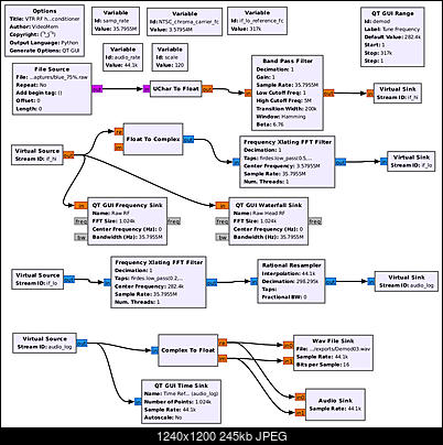

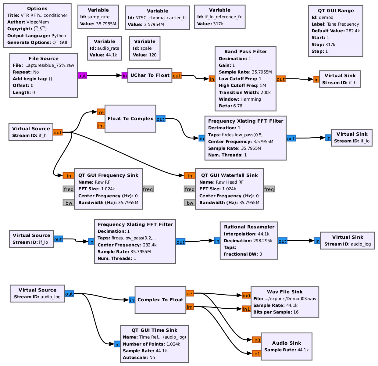

    I've been experimenting with gnuradio and the raw binary captures provided in this thread.
    Here is my circuit:
Name:	VTR head RF signal conditioner test.jpg
    Here the gnuradio .grc project: VTR RF signal conditioner.grc.zip
    HEADPHONE SPEAKER WARNING! These files contain an audible representation of an arbitrary region of interest of the binary file provided in this thread.
    Here the raw audio output for the archive CXADC_Zenith_XBV342_35.8MSPS_NTSC_test_captures -> blue_75%.raw of this thread.
    Its input samplerate was set to 10000000*315/88.0 Hz. (35.7954 MHz)
    What it does:
    From the raw tape head signal, not time corrected, no jitter compensated raw ADC output:
    It frequency shifts / downconverts using the samplerate / 10 as center frequency (35.7954 MHz).
    The Xlating/FIR block on gnuradio does that, plus it haves a lowpass filter on the input, with a 5Mhz cutoff frequency, 200kHz transition band.
    The output of the demodulator feeds into another demodulator.
    I found a peak around 317Khz from the downconverted signal which shows as a jitter dance in the waterfall plot.
    It may be a glitch, but it sounds wowy an fluttery as I remember from tape.
    The sample rate here is 'as is' the louder one:
    Demod03a.flac
    Here is lowering the playing speed by 0.4
    Demod03.flac
    If someone knows what these tones carry, please leave a comment.
    It sounds like tones and chirps, it is something 317kHz over the chroma carrier.
    I think the machine have many heads, that's why the patterns repeats a number of time in the short term, and seem to have a periodicity in the long term.
Name:	VTR head RF signal conditioner test_gui.jpg

  23. Can you capture the solid color samples from that tape in NTSC again, but this time shaking physically the player while playing and capturing?
    It produces such regulating motor kind of sound in that band.
    I would like to 'see' how physical jitter traduces to the reproduction.
    It also could help us to write the de-jitter part of the signal time based conditioning.
    A PLL could be implemented, the problem with gnuradio is that every time I tried to close an internal control loop from the graph itself I get an error telling me it is not possible.
    A PLL is a series of three basic elements.
    A block capable of outputting the phase difference between two signals like a sine and cosine generated by the same oscillator would give you a constant signal.
    That output is connected to a bandpass to focus the in the error band.
    And then it goes connected to a local VCO.
    One of the Input signals of the phase differentiator circuit is the output of the VCO.
    It forms a closed control loop which have similarities with the delta sigma ADC.
    The problems I found with these circuits even in software is that they need its parameters to be very adjusted to compensate for the timing error produced by the previous machine and not to introduce new compensation artifacts.
    For the CPU load balancing, I connect different graphs executed on its own thread through ZMQ sinks and sources.
    At least it will produce a lot of artifacts, some of them played at certain speeds (by resampling) sound very mechanical techno to me.
    https://youtu.be/wl1ZrEza7uY
    I wonder if there are microphonics artifacts from the head and the tape during switching and scanning at very high speed.
    Demod1.flac
    [ It sounds like lo-fi laser gun effects helicopter something with a vacuum cleaner in the background ]
    The marvellous of digital domain non-realtime processing could help us to cheat on the control loop by using something like a cross correlation coefficient of two time series domain signals to get the timing error?
    Then it could be sample interpolated head to head switch.
    I'm not really sure about this.
    I already used a python script to hear the error difference between two digital audio signals with the same audible audio, one previous a signal chain (audio input of a software fm modulator), and the output of the whole chain (software fm receiver wave file on disk) but by an unknown initial lead-in delay at each wave files.
    It syncs really good.
    It then computes the error and transfer linearity between input and outputs.
    Here something similar could be used to de-jitter the signal and dropout compensate in a further 'multi pass' recover mode.

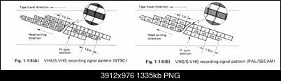

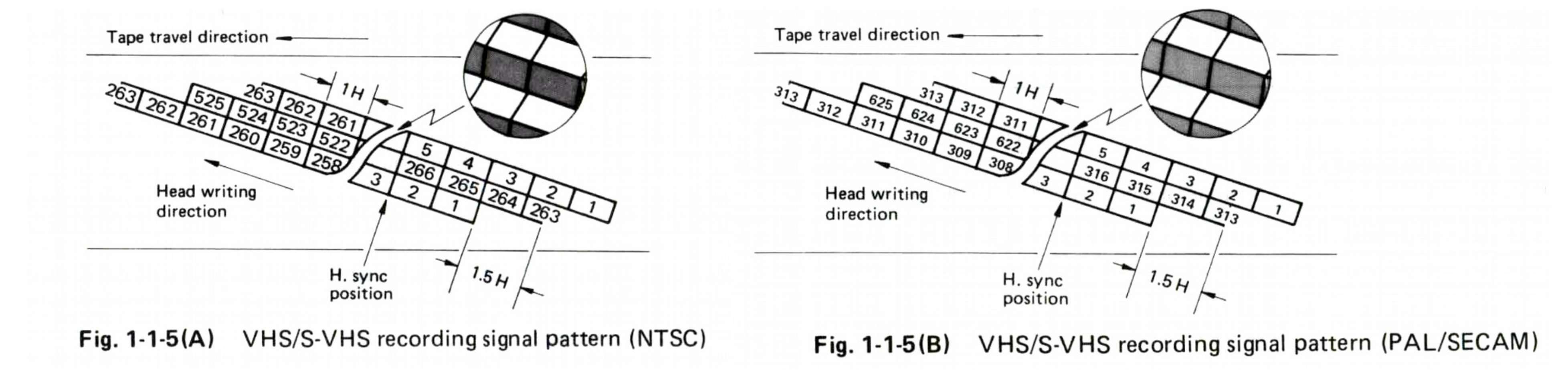

    Then, I found I was confused and wrong all the time in some guesses.
    There is no such thing as one line per head pass!
    I brainfarted and thought each line was recorded per head pass, but that's false:
    Here is how each line is recorded on the tape:
Name:	09-slant recording.png

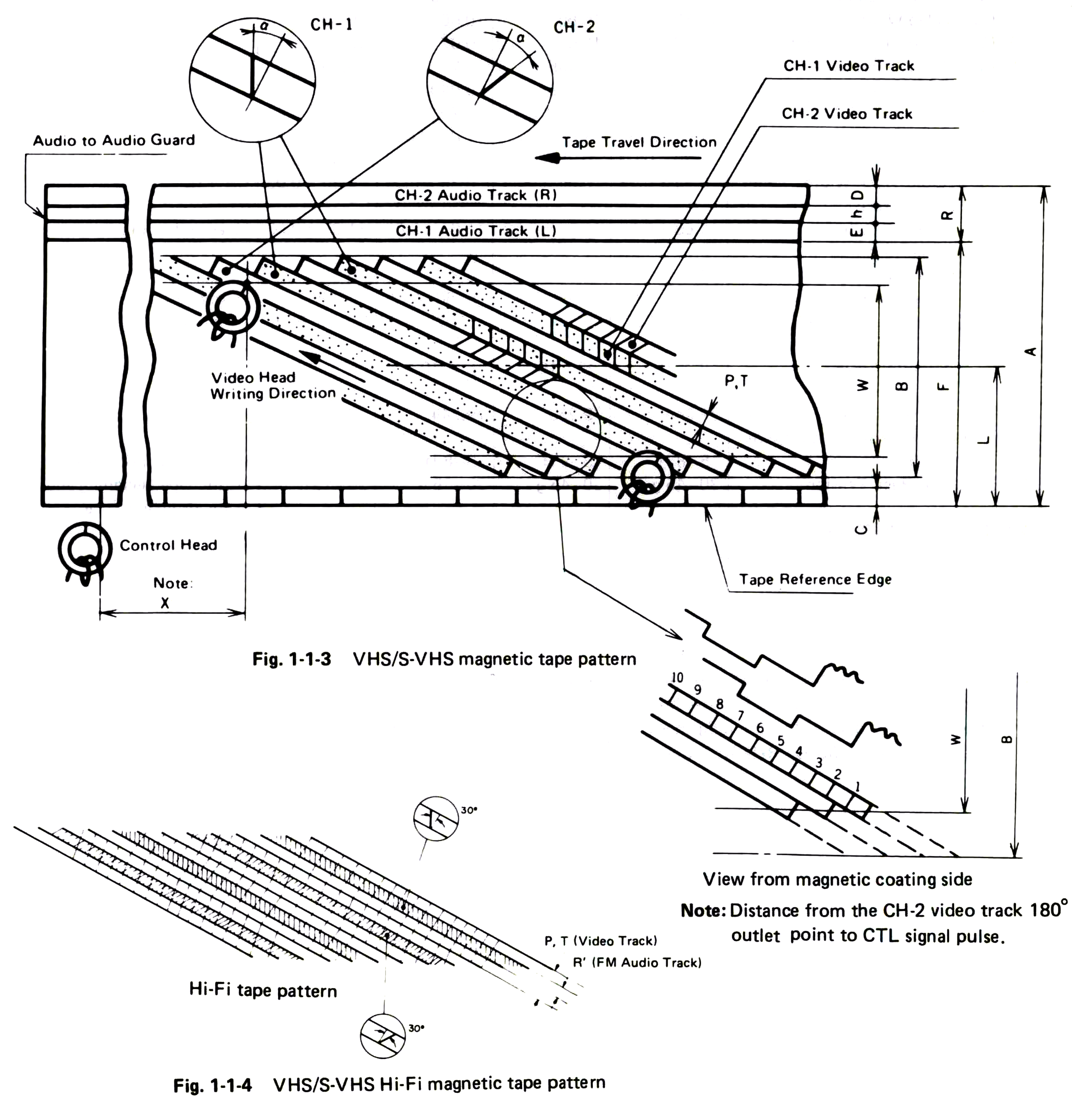

    And the overall track layout:
Name:	01-Tape track layout spec.png

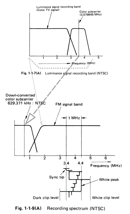

    There is no direct compatibility of the broadcast RF TV color signal and the RF current magnetic recorded signal:
    Luma is shifted and FM modulated
    Chroma is downshifted and FM AM modulated
    Here a collage of pictures I made to illustrate the frequency shifting:
Name:	05-06 frequency shift.png
    What it is not clear to me if the luminance FM is modulated as a whole, with the original chroma signal.
