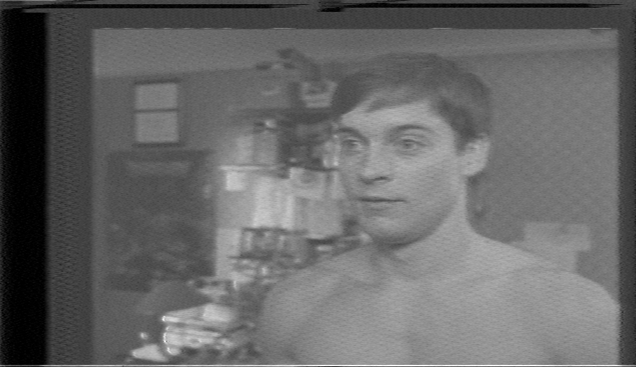

  2. Latest git now decodes NTSC. Didn't finish up color for it yet.
    Screen from vaporeon800's spiderman sample.
    The odd vsync area is due to head switch being set very low.
    [Attachment 51709 - Click to enlarge]
    The zig-zag patterning is chroma interfering with the luma signal I think. It was quite prominent here, maybe due to the frequency spectrum of theluma signal being 400 KHz lower down on NTSC (525-line strictly speaking) than PAL. Will need to work on the filters to reduce it, and ill have to see if it is as prominent on other recordings or if some of it is due to bad Y/C separation during the tape recording process.

  4. Originally Posted by oln View Post

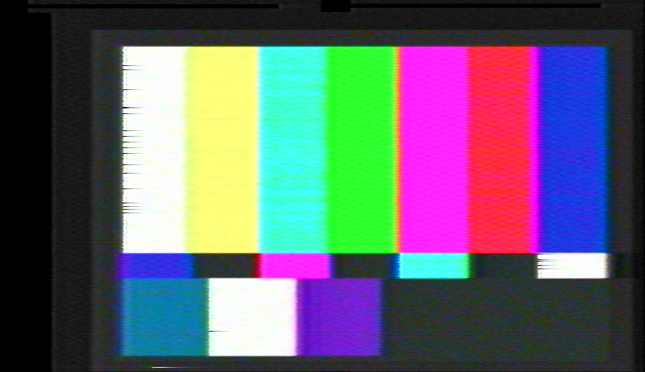

  29. Yup, made a little progress on NTSC color today. I spent way to long not realizing that the color under frequencies of PAL and NTSC are not the same, but now that I accounted for that the phase of the color signal was as expected. Still needs way more work to look good though.
Name:	ntsc progress.png
