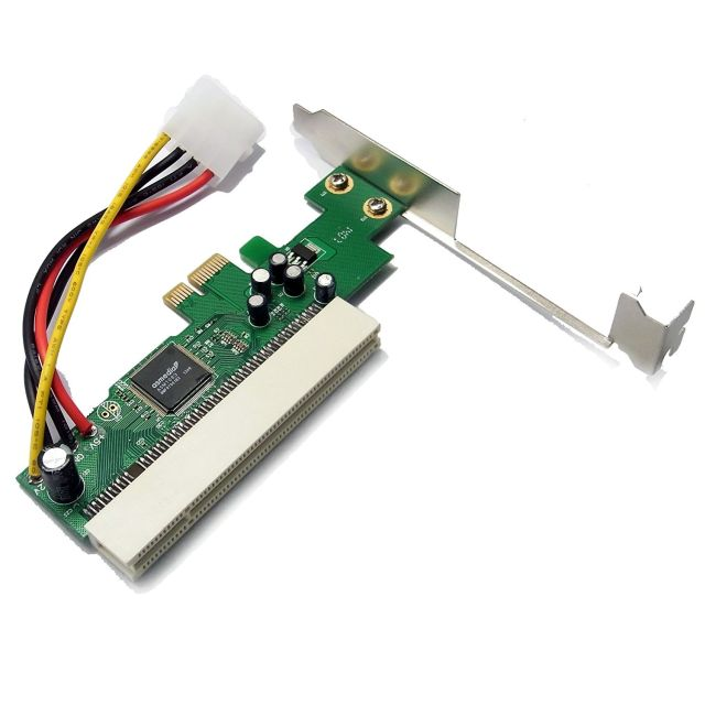

 I think there two solutions for lack of PCI socket - #1 use an bridge:
 [Attachment 51411 - Click to enlarge]
 Another solution you mentioned is #2 - buying modern motherboard with PCI socket - currently I am using one exactly for this purpose, we're lucky that Asus made one for such powerful Ryzen platform (it's obvious they are becoming obsolete). Personally I can recommend you Asus Prime X370-A. It has two classic PCIs.

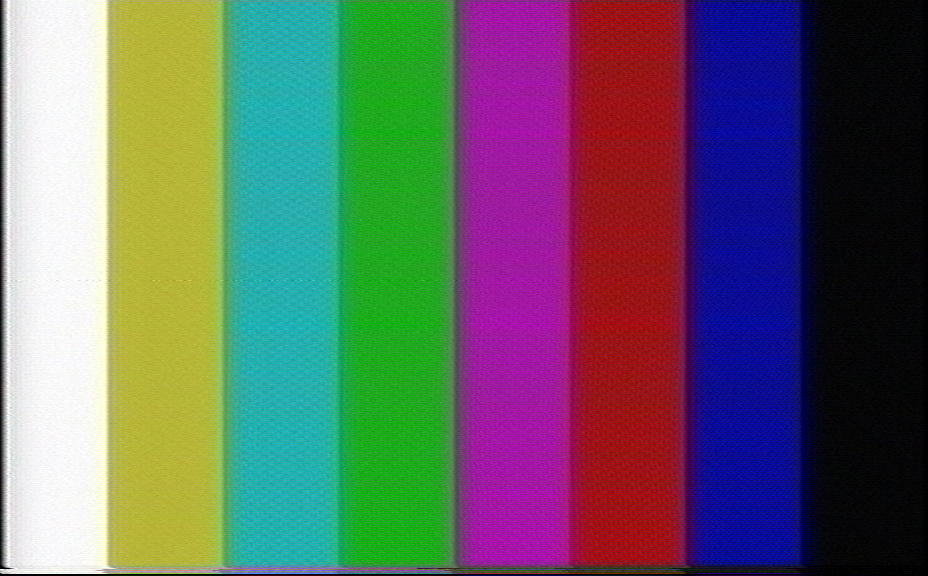

	Made some progress today, turns out I was looking at the wrong spot, and it was the final chroma band-pass filter that was too narrow. Thought I had checked that earlier but apparently not. Anyhow this makes colour look much nicer:
 [Attachment 51451 - Click to enlarge]
 Also added a --cxadc3 option for 35 mhz cxadc, and --othertrack to swap which track has phase rotation (try this if you get no color).

	Looking good OLN, I see a lot of dot crawl though in a form of checkerboard, Isn't that a problem of capturing from the composite output? It shouldn't exist in the RF stage, Could it?
