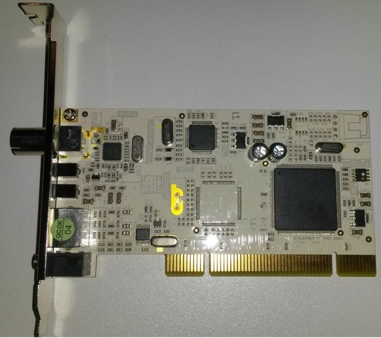

  3. I'm currently seeing if i can use VHS-Decode with my Terratec Cinergy HT PCI card that’s PCI and have a CX23883-39 chip on it mostly for single channels formats such as Video 8, Hi8 and Laserdisc, for multi channels formats formats such as Betamax, VHS and Super VHS i will still be capturing them the conventional way with a DVD recorder with TBC with a 12-bit ADC on it from a Sony RDR-HX recorder until the MISRC iteration becomes better in the future as an alternative to the CX cards and the clock gen mod.
    Also, how does this works without using that ADA amp in the chain and a Stock unmodified good CX card that could have good Crystal oscillators already? The captures would look worse than a good conventional capture?
    I can’t get the ADA amp and if i do it i will be using my CX card stock unmodified just to see if it worth it and i get sharper and better results with less color bleed than a conventional capture using my Digital 8 camera via FireWire.
    This is my card:
    [Attachment 93339 - Click to enlarge]
    Edit: Never mind, the ADA Amp in the chain is super important for vhs-decode to make more sense, however seems like the 40MHz crystal mod is not that necessary because with 28.6msps is well enough for analog formats using that ADA amp in the chain.
