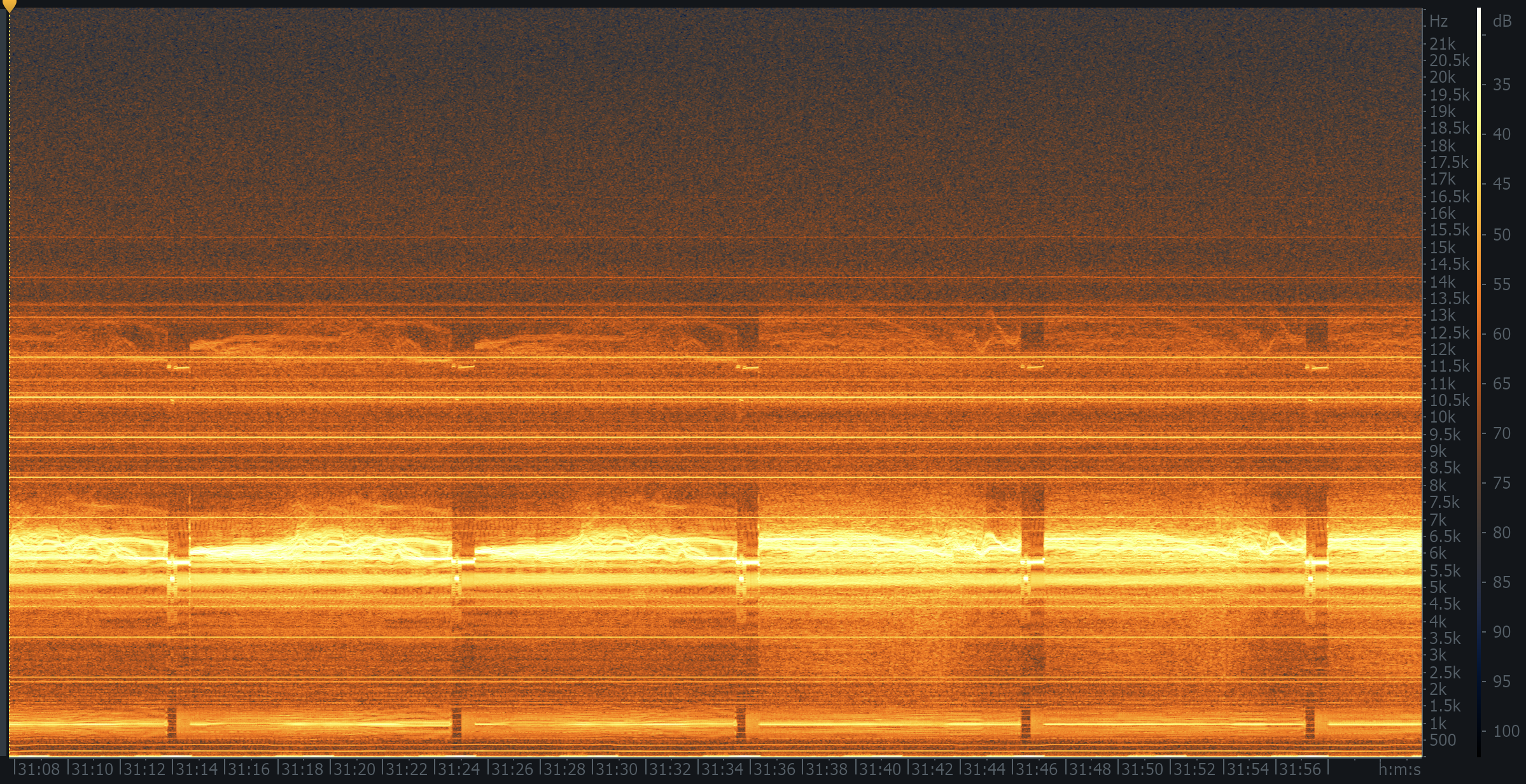

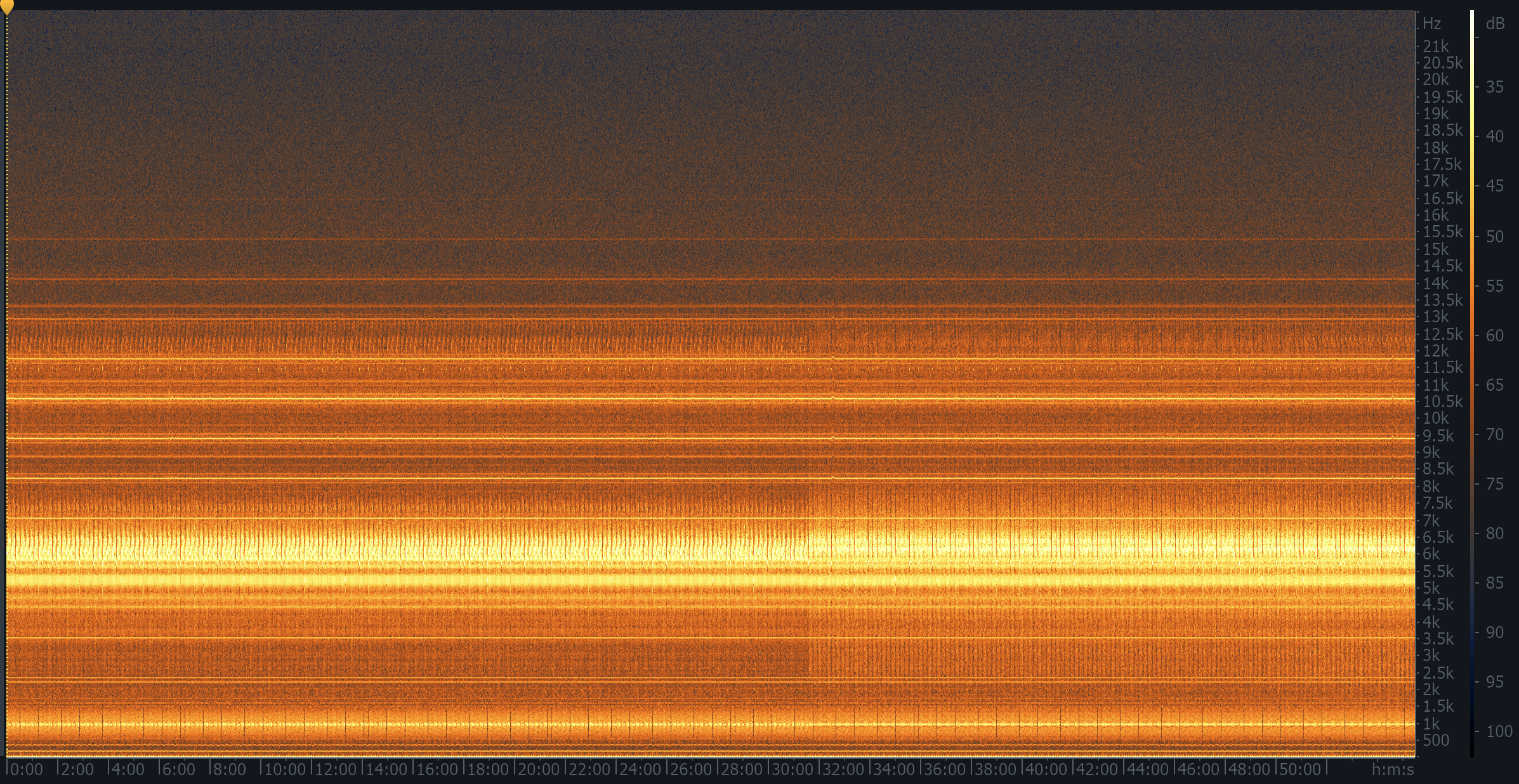

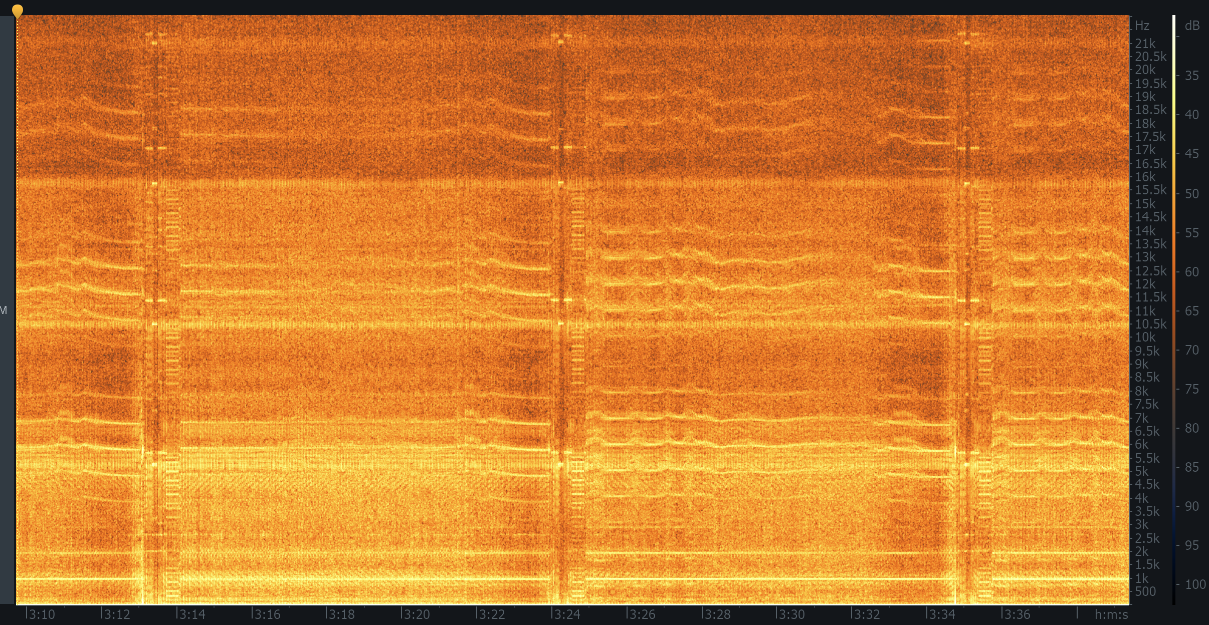

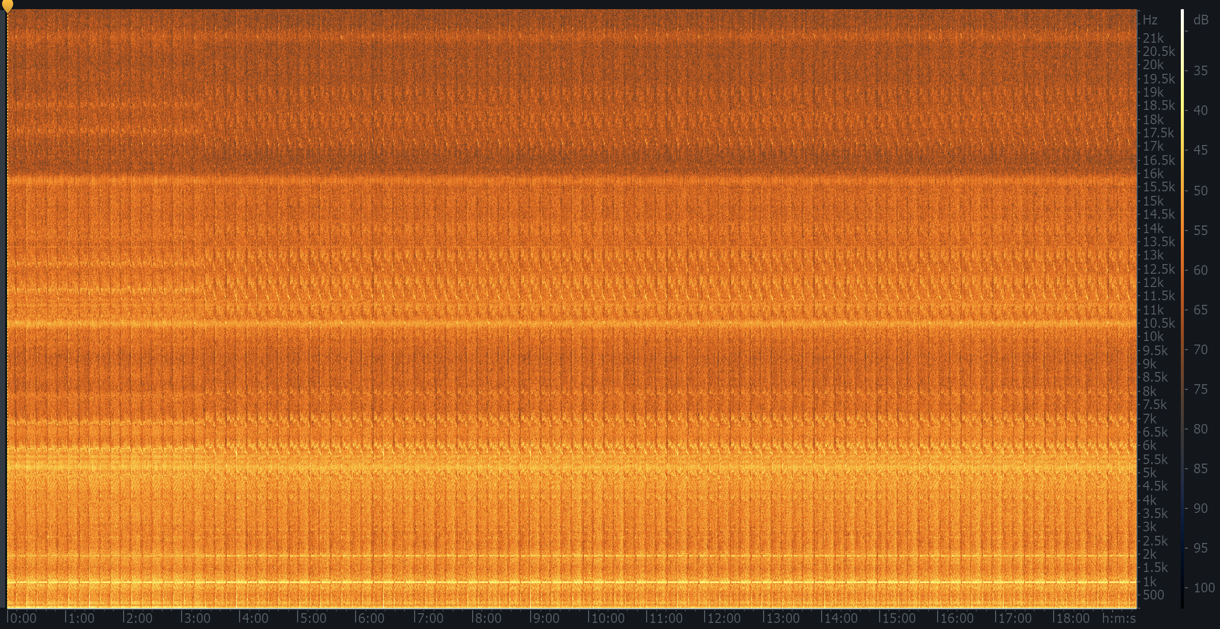

  24. Had to convert it to .wav so not sure if I did it right, but here's a spectrogram view of that first sample, the one with the DC offset:
    [Attachment 51245 - Click to enlarge]
    [Attachment 51246 - Click to enlarge]
    Comparing that to the Spiderman capture posted earlier in the thread, there's definitely something off about it:
    [Attachment 51247 - Click to enlarge]
    [Attachment 51248 - Click to enlarge]
    If anyone else wants me to put their transfers through this for a looksee, let me know - might reveal a few things.
